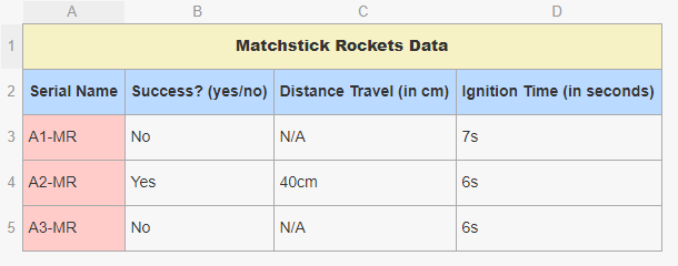

This is the most exciting part of this Instructable! The science is about to happen! Before I conduct the experiment I prepare the data below so that I am able to record the result of the test. You may have a look at my basic and simple data record for the matchstick rocket science experiment.
Get your paper and pencil/pen and copy this, because we are going to explore the science with the help of this basic and simple science experiment. I will demonstrate and conduct the experiment to fill up this data. Also by doing this experiment, we are now able to answer my questions about matchstick rockets.

Experiment Result
Here's my data from my experiment, as you can see I have 2 failed launches for A1-MR and A3-MR rockets. Only one out of 3 rockets have successful and complete data. Failed to launch means no data to be recorded. In the last part of my experiment, I got only one rocket has complete data on it and it is the rocket A2-MR. It is the rocket with 1.5cm aluminum from its head. I can't imagine this rocket would be the successful one from the rest. Now I learned something today with the help of this experiment if you did the experiment you should show it in the comment below. Let me know also what are the things you've recorded aside from my data. I am so happy to document this little experiment to show and tell the application of Jet Propulsion and to have an idea on which design is effective when making a matchstick rocket. Proceed to the next and last step for my conclusion about this experiment! Thank you for joining me in the wild world of SCIENCE!

In the data, as you can see the A1-MR rocket has 7s on ignition time. It is normal because it has a 2cm length from its head and another 2cm from above of its head to equal to 4cm x 4cm. The higher the dimension is the higher the ignition time also. Compare it to the two rockets A2-MR and A3-MR they have the same ignition time because they have lower in dimension. Only 0.5cm the difference between them but the A2-MR only did a good job. I've learned here is now I know how to make a perfect size of aluminum to be wrap in the matchstick with a higher success rate. This is only my conclusion about my hypothesis and I finally answered my own questions about rockets.
