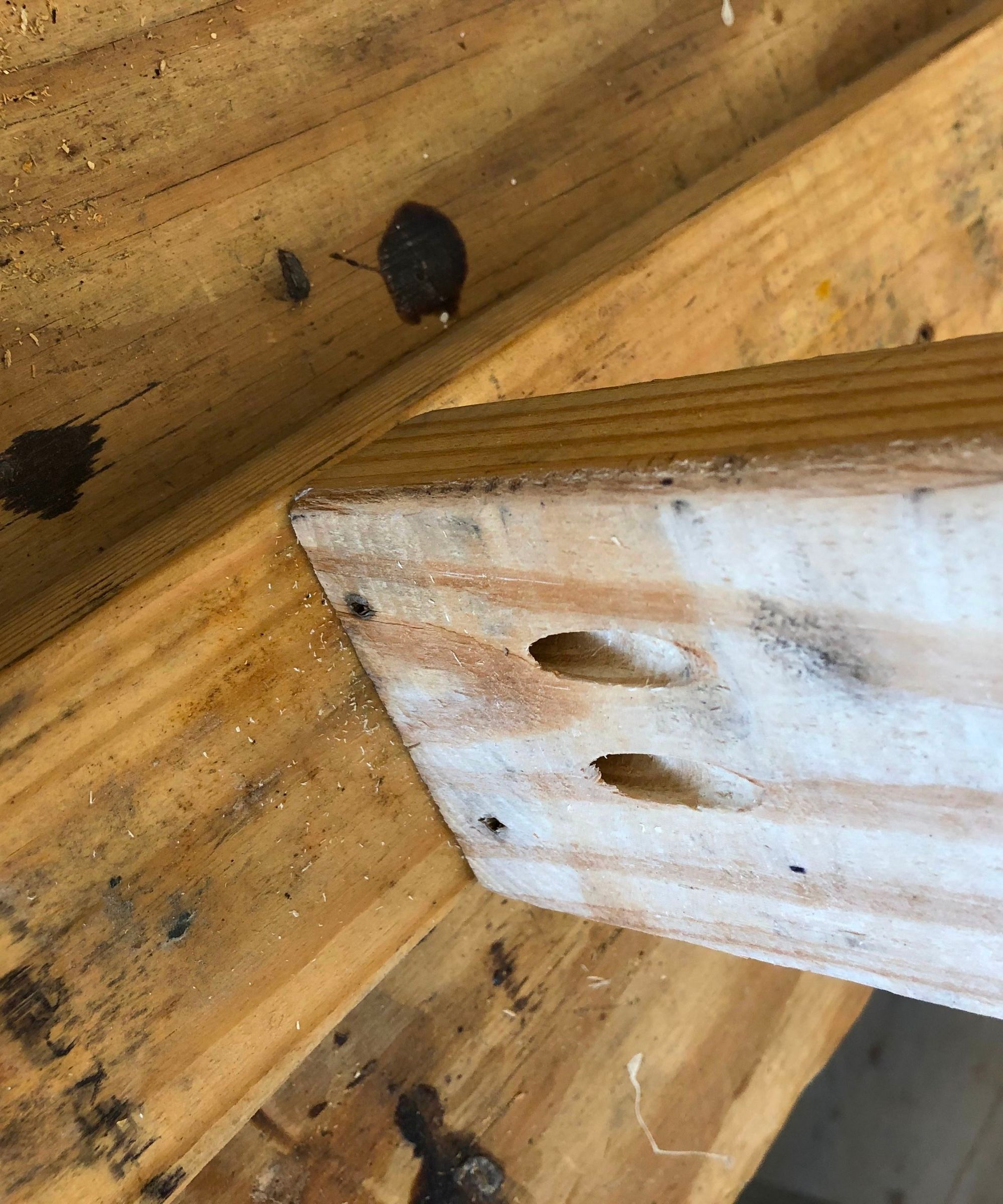

Attach the 2x4 brace (19.5") to the 4x4s (16.5") using a Kreg Jig K4 Pocket Hole System on a 1 1/2" setting, with 2 1/2" Pocket Hole Screws to attach along with Wood Glue. There should be a 2" spacing from the 2x4 brace and the floor. Repeat step for the other side.

First start with putting holes on the ends of the 2x8s that point to the side assembles using the kreg jig allowing you to drill bottom shelf into the side bases. lay table upside down and clamp so that the shelf is flesh with the side assembles. Using drill connect the bottom shelf to side assembling.

Using kreg jig put two holes into 33" 2x4 pointing in the direction of the side assmebling. attach 2x4 support beam into side assembling, using clamps can help.

Take your 2x10s at 33" that you previously cut, put keg jib holes into two of them pointing to the side with the next 2x10 will sit next to each other. lay 3 2x10s next to each other, make sure they are straight and the same length. then attach the three together, clamp the three together for support that they won't move. Do the same for the two ends.
