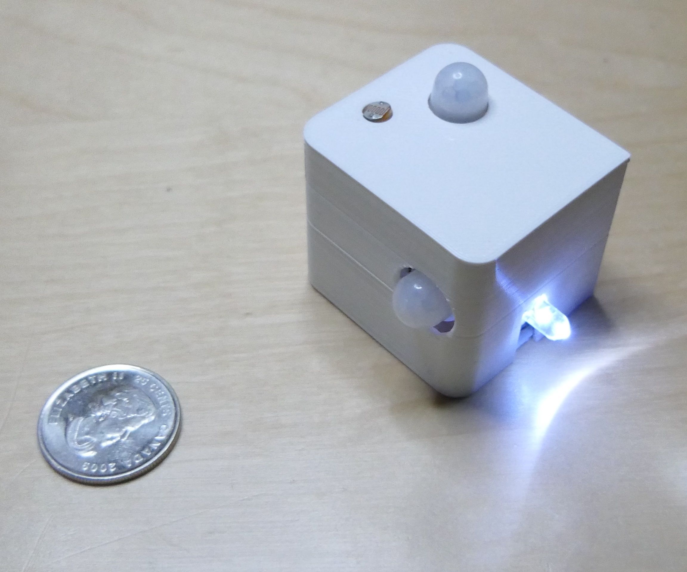

Step 6: Building the Device
I made a PCB with the components soldered and 3D printed an enclosure for the device. Please note that I used breakaway headers for the ESP01 and machine pin breakaway headers for the ATTINY so the chips can easily be removed and updated if needed in the future.
I also 3D printed a device holder so the remote can serve as an easy to reach “Stop the alarm” button in the morning. I position the remote upside down on it. There is step in the bottom of the holder where the top button sits. Pressing on the back of the device sends a play/pause command to the SONOS speaker.
