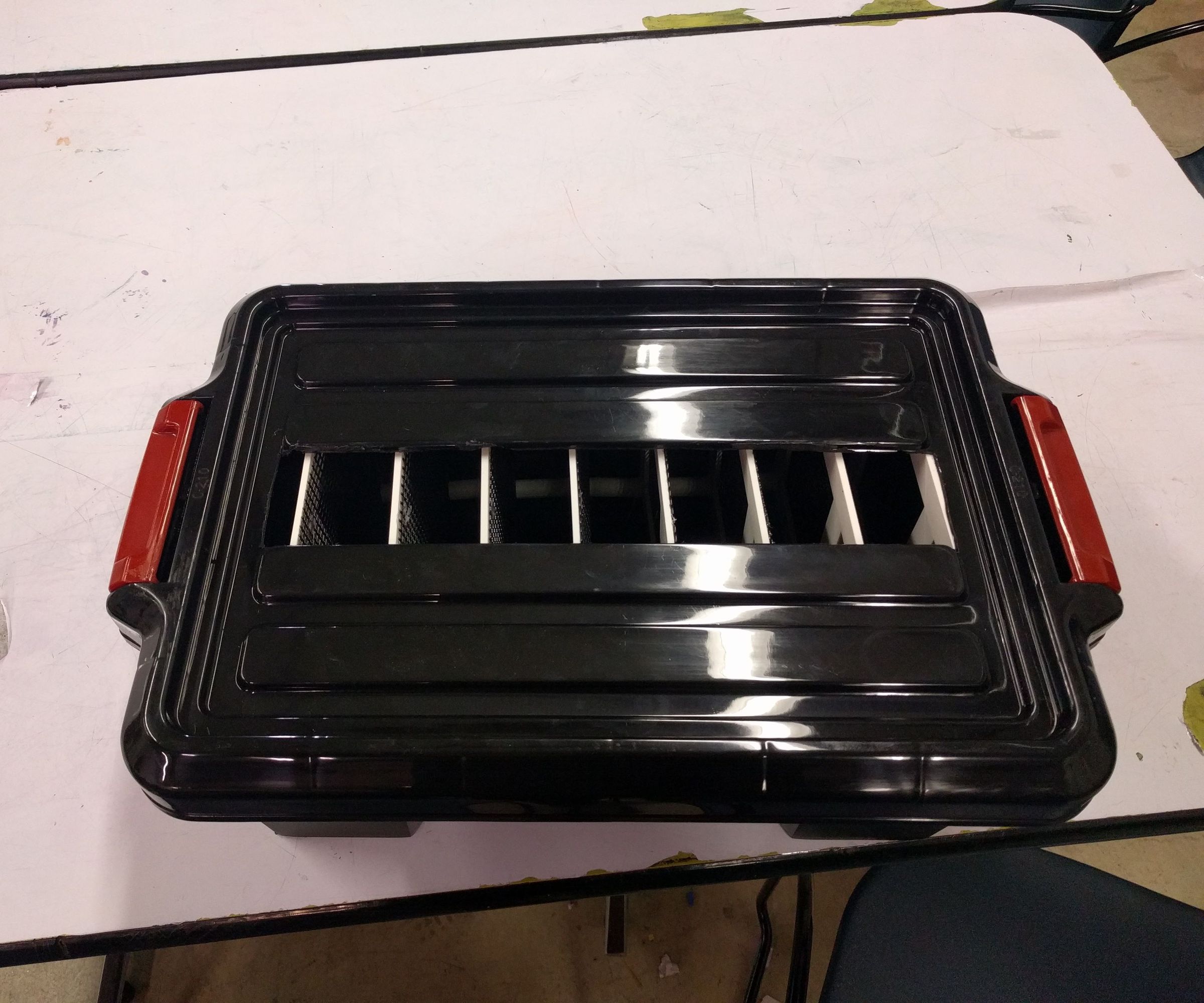

We have developed a self-contained, self powered box that uses electrolysis to disinfect water, making it safer to drink--the S.P.E.E.D. Box. S.P.E.E.D. stands for Solar Powered Electric Electrolysis Disenfecter.
We are using electrolysis to disinfect water. Inside of this box is a 12-volt battery and an electrode box. Our electrode box contains four electrodes. When we wire the electricity up and pass the water through (and we will be adding salt to that water) the electricity will break down the salt molecules to produce chlorine, which will disinfect the water. The other parts of our box are the solar panel, and control panel. The solar panel will provide additional electricity to the system. The control panel will control the system.

Step 1: Our Basic Box
We created the parts in TinkerCAD (www.TinkerCAD.com) a free CAD program designed for kids. All of these files are available for download from this Instructable and can be printed on any 3D printer with a bed size of 200x200x200.
Download and print these files to form the basic box, legs, electrode box and solar panel holder.
Step 2: Print All the Attached 3D Print Files
Print all the attached 3D print files. These pieces were designed to fit on smaller 3D printers. Any printer than has a bed size of 200x200x200 or more can print these files. These files require less than 500 grams of filament (half of a standard roll). We used PLA filament, which has been rated as food safe by the Food and Drug Administration.

Step 3: Install Hose Connectors Into Electrode Box.
Drill 5/8" holes into each end of the electrode box and install hose connectors.
Step 4: Install Electrodes
Once you have the Electrode box printed, insert the 4 electrodes into the brackets. Connect the two power leads to opposite electrodes (1 and 4).
Seal the electrode box with silicone.
Connect 12" hose pieces to each hose connector.
Place electrode box into main body and seal it in place with silicone.
Step 5: Hook Up the Electronics
Follow the instructions on the control box to hook up the box to the solar panel and feed power to the electrode box.
Step 6: Assemble Box
Glue together box sections to complete the box.
Step 7: Mount Solar Panel.
Mount the solar panel and connect the power leads to the control box.
