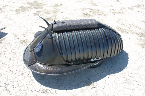

Step 7: Exsamples of My Fire Gardens
These fire gardens all use the same basic plumbing system.
