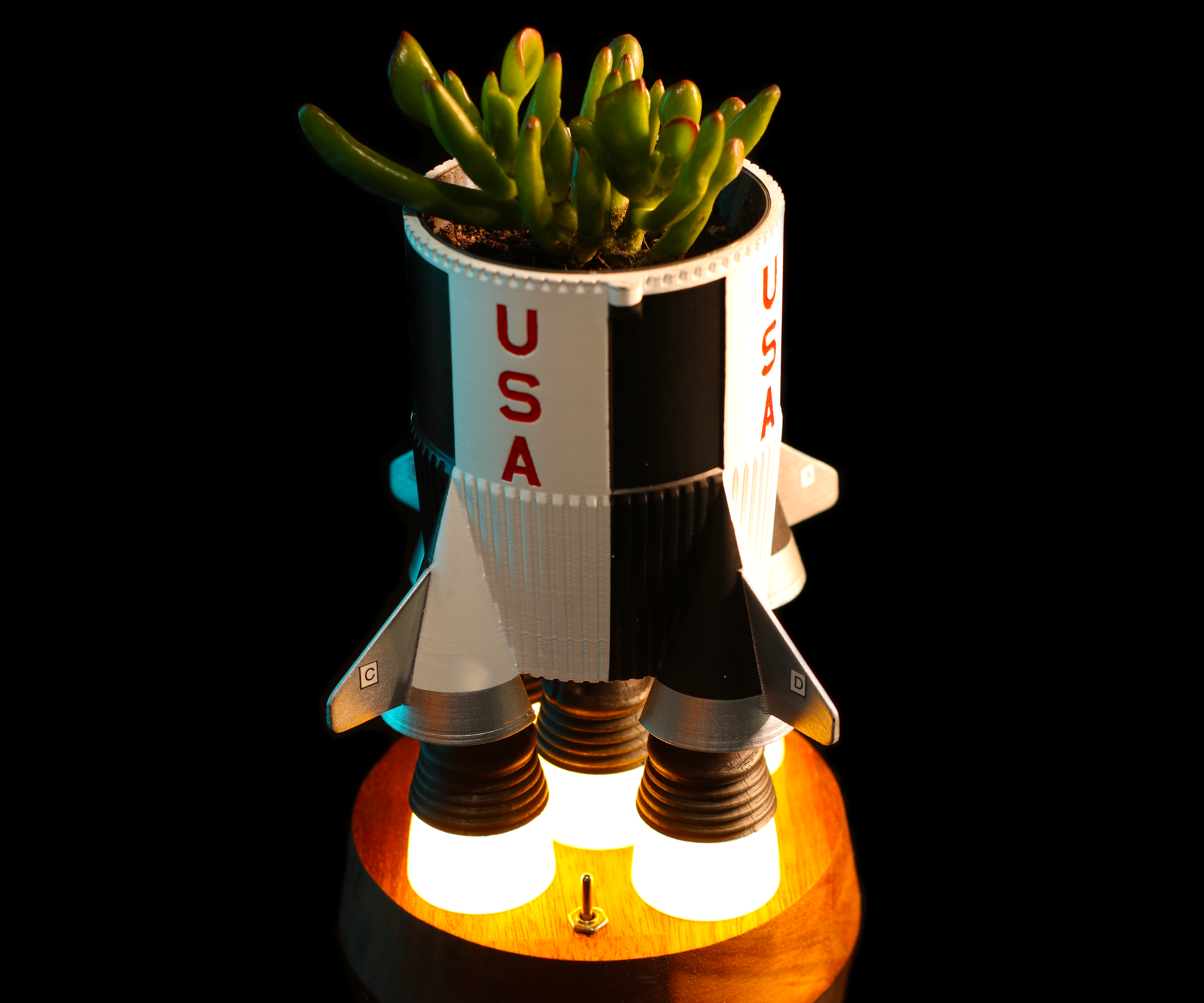

The rocket exhaust flames are one of the light sources of the lamp. They were made from a pencil tube of the same diameter as the nozzle, which was cut into 5 tubes about 25mm long. These tubes were sanded outside using sandpaper (120). For each exhaust light : Two smd led were soldered together in parallel. They were placed at one end of the tube (as pictured), facing down. The tube containing the led's wires was filled with hot glue.

About 20 led wires were soldered, then harmoniously sticked around the cylinder. Keep in mind to place more led at the top than the bottom for realism ! All the "+" should be soldered together as well as the "-". Each pole should be soldered to a long wire which will be connected to the base later.

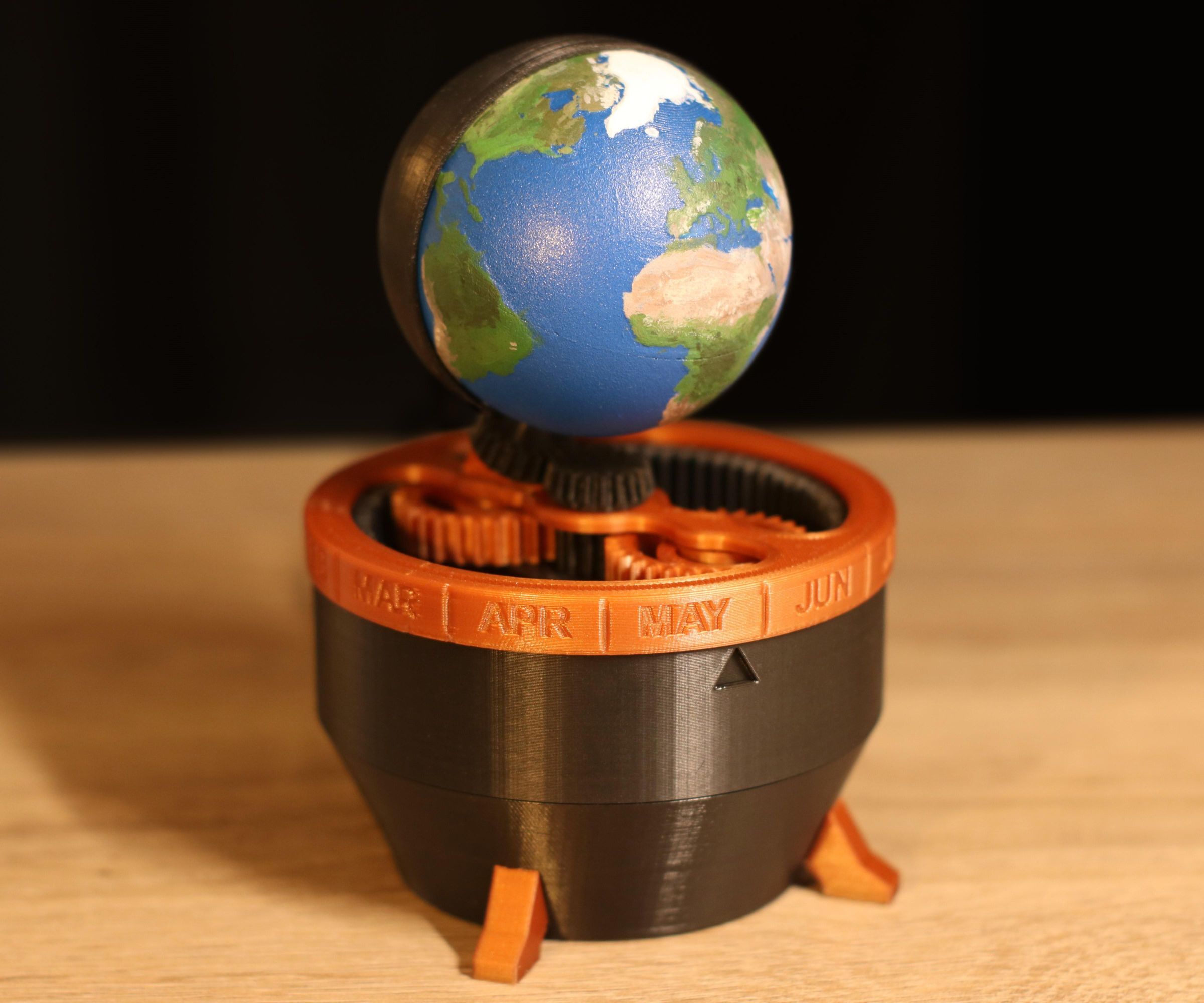

I first thougth about making a PWM module as on The Earth Clock. But this time, the rocket needs more led, and the module wasn't powerfull enough. I decided to only have an ON/OFF switch and nothing else.
To do so, I used a buck converter (preset on 3.1V) directly connected to led.

The smoke is made using white cotton, a very simple process : you only have to glue gradually the cotton to the wood cylinder.
If you notice that lower led are too bright, you can glue a little cotton ball right on the led: that way, the light will be spread and softened.
