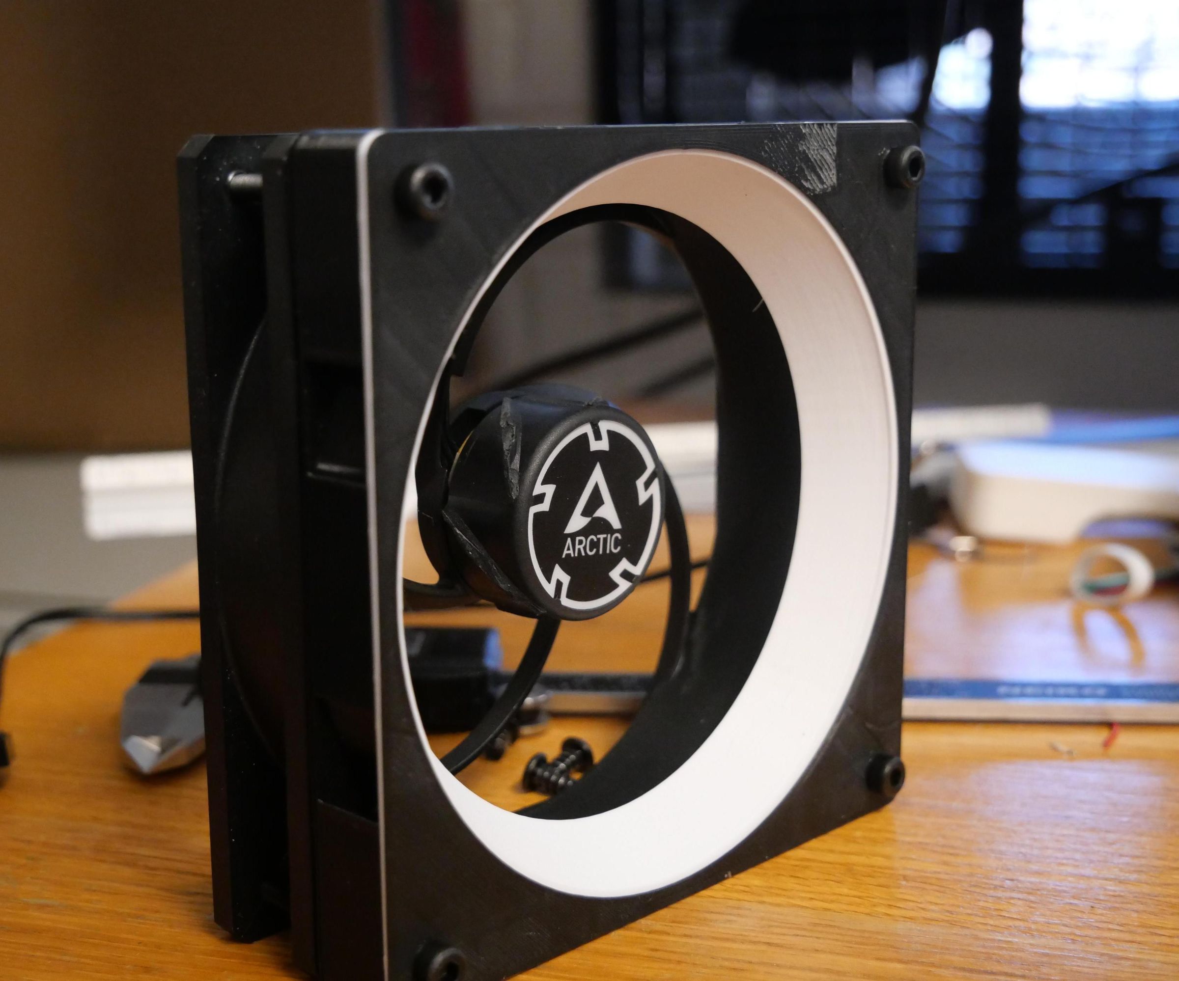

Step 2: Designing the Main Speaker Enclosure Back
When designing a speaker enclosure, you must conider many many factors. It is closer to rocket science than anything. One of the biggest topics to consider when designing a speaker enclosure is weather or not the enclosure will be vented or not. Venting an enclosure takes adventage of a principal called bass reflex to assist resonation at certian frequencies.
I attempted to create a fancy ported enclosure, such as the first two images were the first two attempts at designing a port that would work for my speakers. The first image is of a simple port, and the second image is of a more complicated port that used a similar concept as the stock enclosure that i removed the speaker from. The ports would have been mirrored on either side.
In the end I decided to go with no vent as my speakers did not see an advantage from bass reflex. The third image is the reinforced "no vent" design for simplicity. The "ribs" stretching across the back are to strengthen the back and prevent extra vibrations from the air pressure making the enclosure rattle.
All a part of the prototyping process. Parametric design makes it super easy to go back and try something else.

Step 4: Printing and Assembly
These parts were printed on my custom modified Ender 3. The speakers were dropped into the speaker case and then the back cover was bolted on and sealed the speake enclosure. A small hole was included in the enclosure lid to run the wires from the tabs on the speaker componet.
The speakers were then mounted using elastic rope to the mounting base to allow for the vibrations to be isolated from the speaker base. The elastic rope was tensioned to allow the speaker to not sag on the base, but not too tight.
A terminal block was screwed onto the base in the middle to remove the need for soldering. Then the 1/4in jack reciever was mounted in place with wires coming off of its terminals and going into the terminal block. The terminal block and 1/4in jack reciever are completely optional but I prefer to design things to be modular, so these speakers are now fully "plug-n-play".
