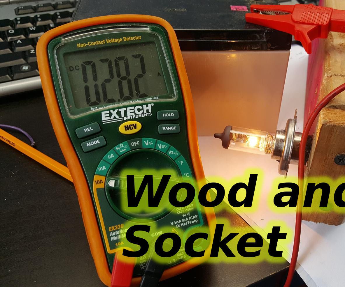

Step 8: Measuring Resistance
Before attaching a power source, you should measure the resistance with a multimeter. I measured 11 ohms without using the alligator clip, and 6 ohms when attached at the top hook. This meant that 1 to 2 amps would be going through a 12 volt dc source. This seemed reasonable. Power is volts times amps, so again with a little fudging, 12 watts to 24 watts.
