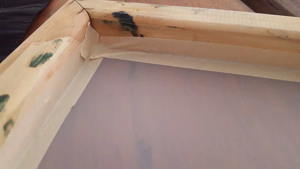

STEP 2: Preparing Your Screen
Your screen will not be prepared when you first buy it. You need to apply masking tape to the inside and back as shown to stop the flow of the emulsion when preparing your screen.

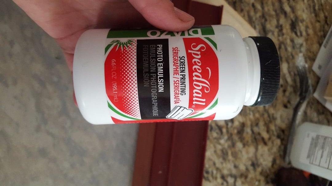

STEP 3: Emulsion
Mix the emulsion as instructed, then pour onto screen.

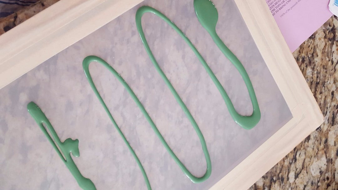

STEP 4: Spreading Emulsion
Using the squeegee, spread the emulsion on both sides of the screen. Because it is a liquid, on a screen, the emulsion will seep through to the other side when spreading.
Your screen should be as even as possible, hold it up to light to see if it smooth and all areas are covered.

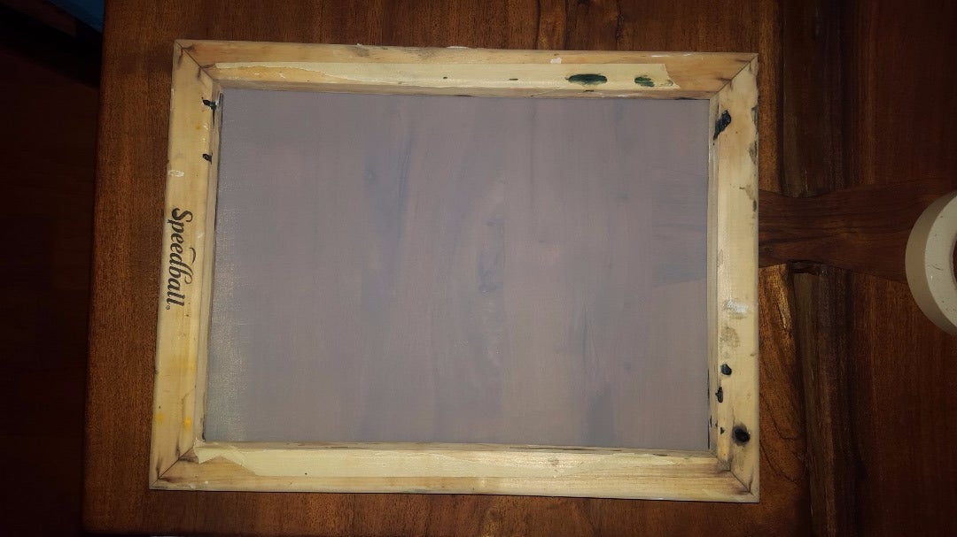

STEP 5: Drying Screen
Put the screen, flat side up, in a dark room to dry. I use a small fan to circulate air so it will dry faster, but it is not necessary. Without a fan, it will take about 3 hours to dry.

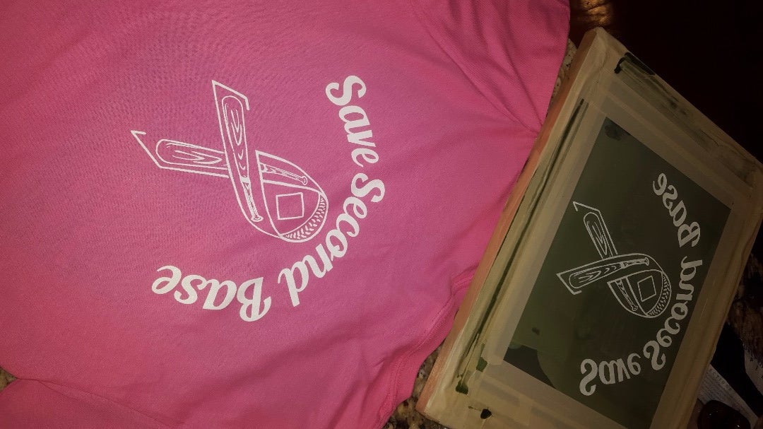

*Note: The "Pretty In Pink" cover was a happy accident when taking pictures for this Instructable.

Place your screen, flat side down on your shirt. Using the flat side allows the screen to make a direct connection for printing (like when using the glass on the transparency for exposing your screen)
STEP 12: Ink the Image
Using a spoon, put a glob of ink on the screen. I drag my glob across the top for even coverage.
Use the squeegee to ink the design onto the shirt.
** Don't go OCD when using the squeegee. Just make sure it covers the design and stop! Too much will cause over-inking and you will lose the sharpness of the design.
STEP 13: Finishing
Pull the screen off, lifting from right to left to reveal your design.
Once 100% dry, iron the image using the highest setting before steam. Iron for 10-15 seconds on all areas of the design. I usually place the iron on one half (no need to apply pressure, just place directly on top of the ink) for 10-15 seconds then move the iron to the other half. This will set the ink and now the design will not wash off.
