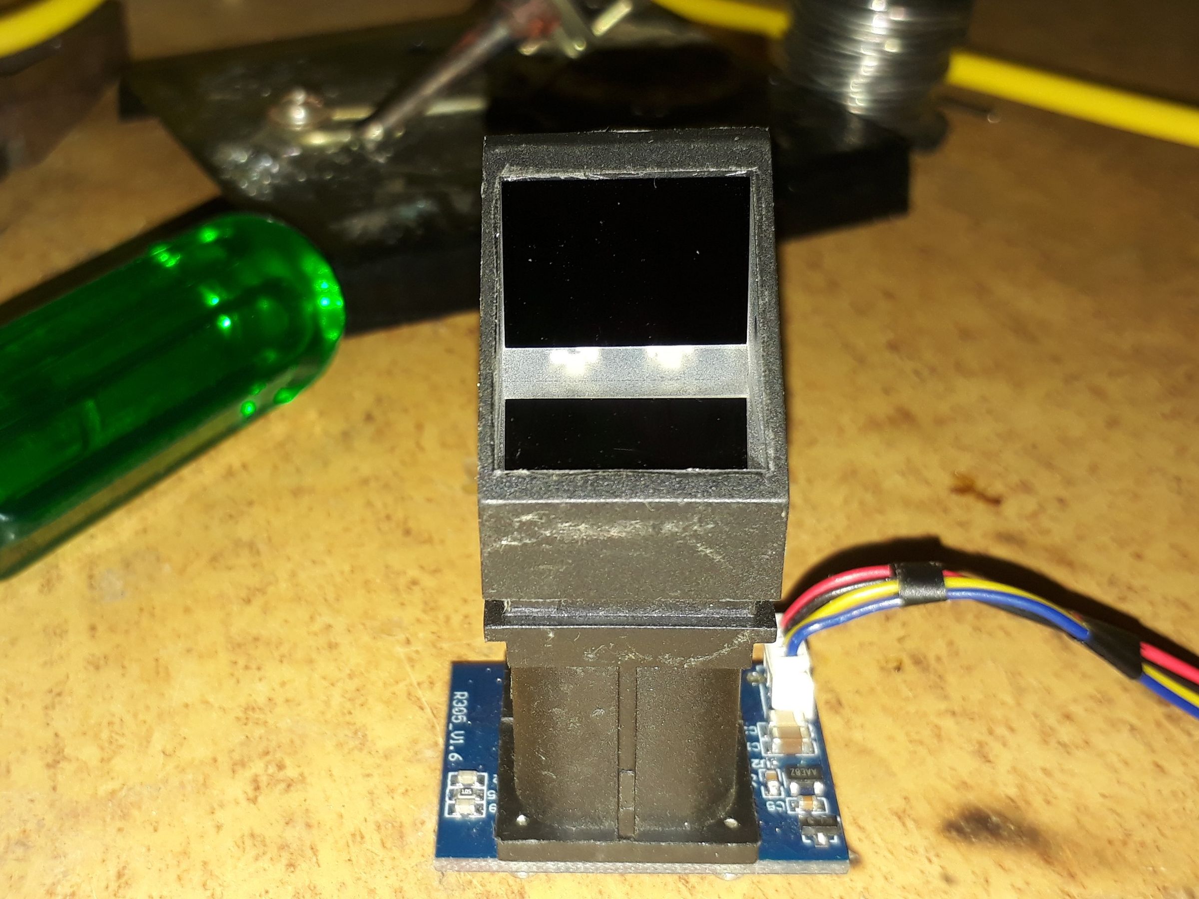

  1. Finger Print Sensor (R305) -TTL UART is a finger print sensor module with TTL UART interface. The user can store the finger print data in the module and can configure it in 1:1 or 1: N mode for identifying the person. The finger print module can directly interface with 3v3 or 5v Microcontroller.
Features of Finger Print Sensor (R305) -TTL UART:
  • Power DC : 3.6V-6.0V
  • Interface : UART (TTL logical level)/ USB 1.1
  • Working current : 100mA
  • Peak Current : 150mA
  • Matching Mode: 1:1 and 1:N
  • Baud rate (9600*N)bps, N=1-12 (default N=6 57600bps)
  • Character file size: 256 bytes
  • Image acquiring time : <0.5s
  • Template size : 512 bytes
  • Storage capacity: 256
  • Security level : 5 (1, 2, 3, 4, 5(highest))
  • FAR : <0.001%
  • FRR: <0.1%
  • Average searching time: < 0.8s (1:880)
  • Window dimension : 18mm*22mm

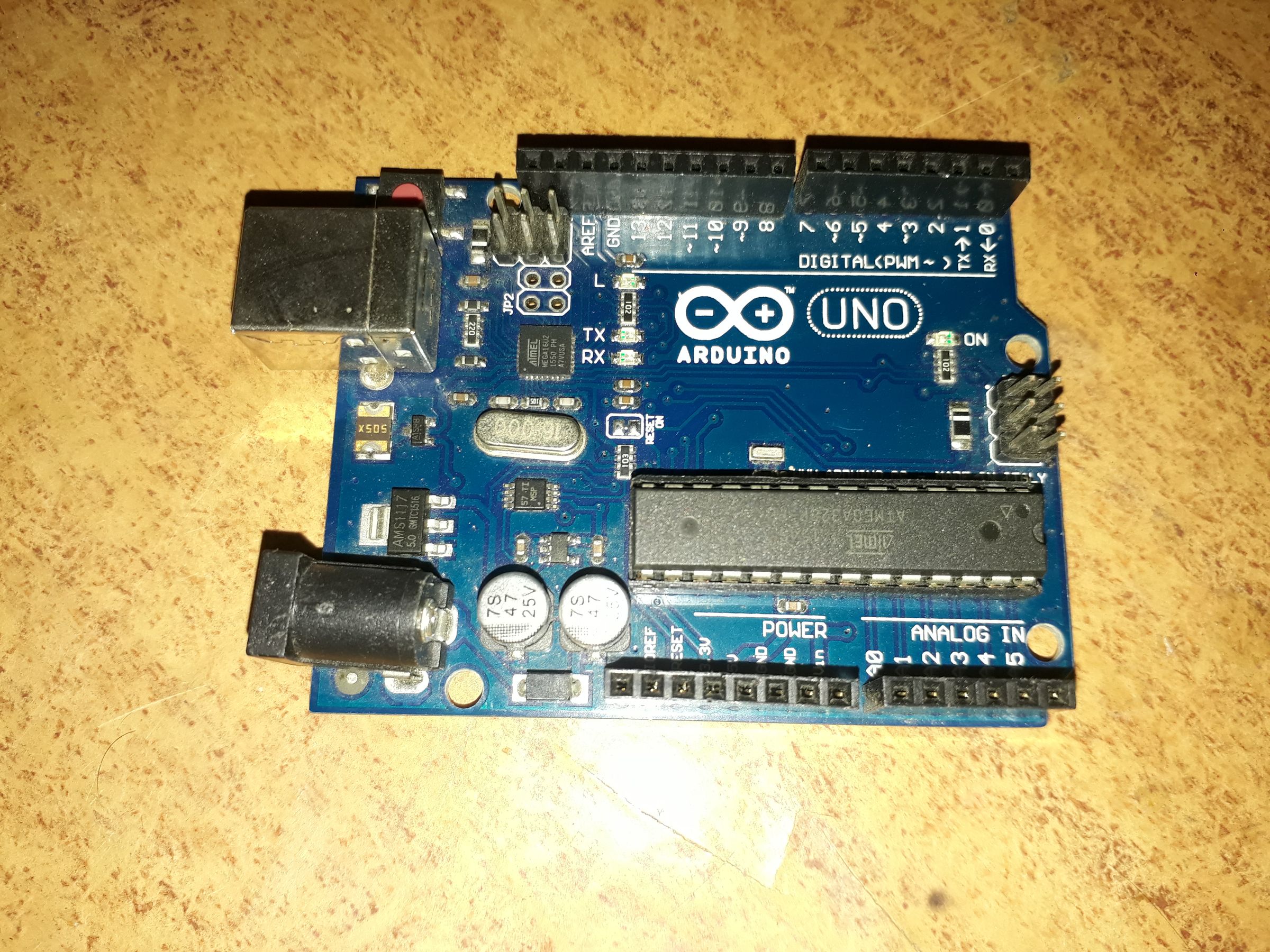

2. Arduino Uno:
Here I have used Arduino Uno for enrolling the fingerprint through SFGDemo Software.

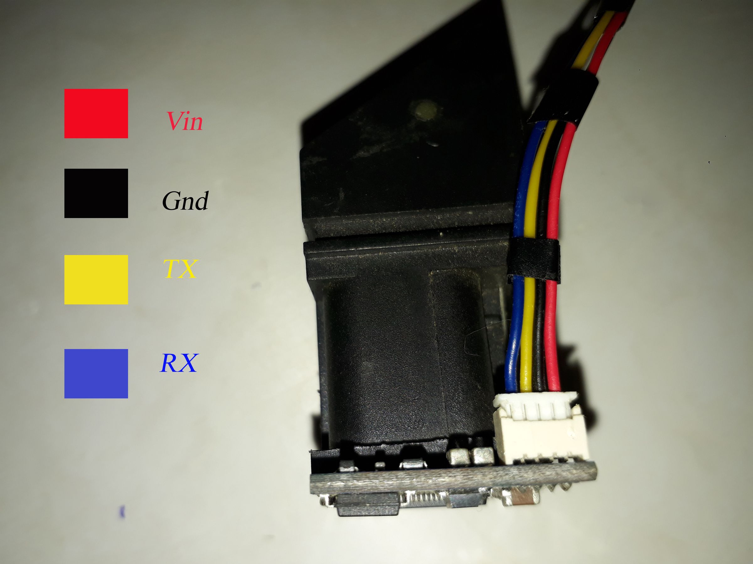

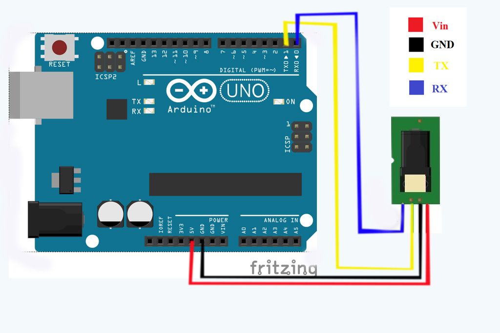

Hardware Connection:
Connect the Blue wire from the sensor to Arduino RX pin and Yellow wire to Arduino TX pin. Put red & black in (+5V & GND) respectively.
After the wiring , upload the following sketch to Arduino Uno board.

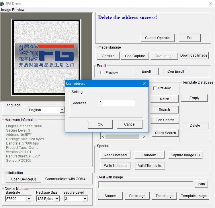

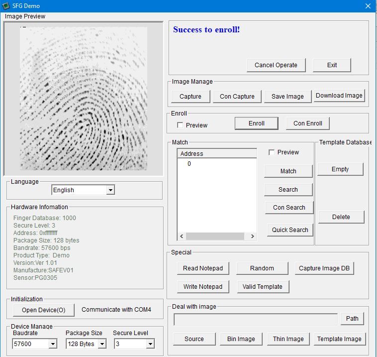

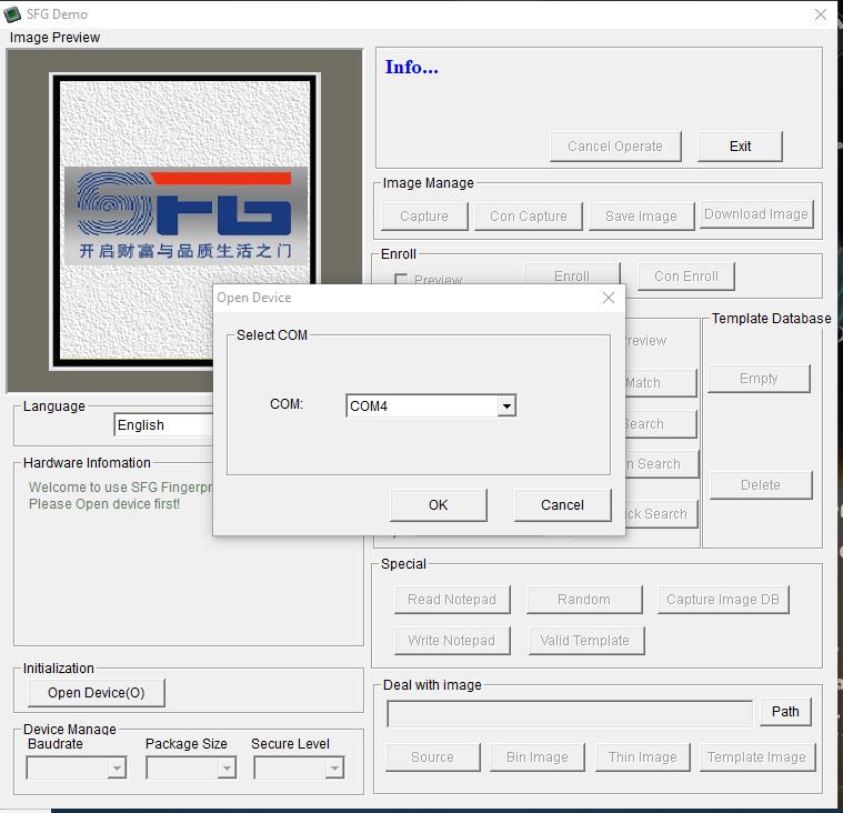

Step 6: SFGdemo
To read fingerprint through windows system we need special GUI software called “SFGdemo"
After Loading the above code open the “SFGdemo” software.
  • Select "Open Device(O)" and select corresponding Arduino Uno's Port Number
  • Click on Enroll, then set your user address
  • The the software Asks you to put your fingers two times to enroll ,If it is success it shows as success to enroll!
  • Add more fingers as per your requirement

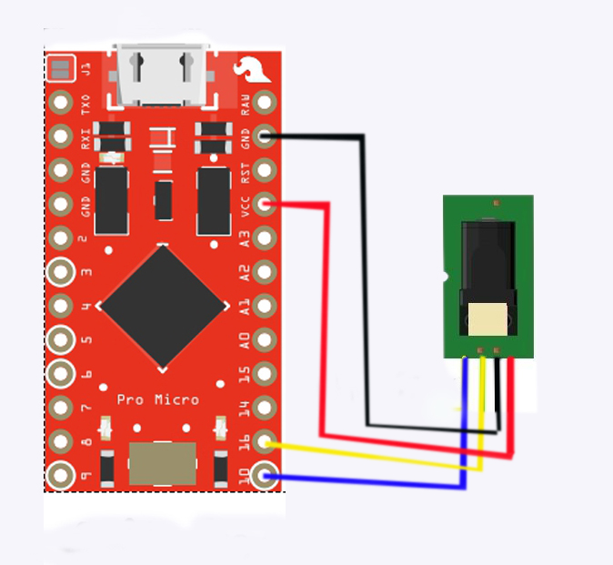

Circuit Diagram:
  1. Connect Blue wire(RX) to pin number 10 and connect yellow (TX)wire to pin number 16.
  2. After the Wiring ,Upload the following sketch to Arduino Pro Micro
You can get codes from my github too.
