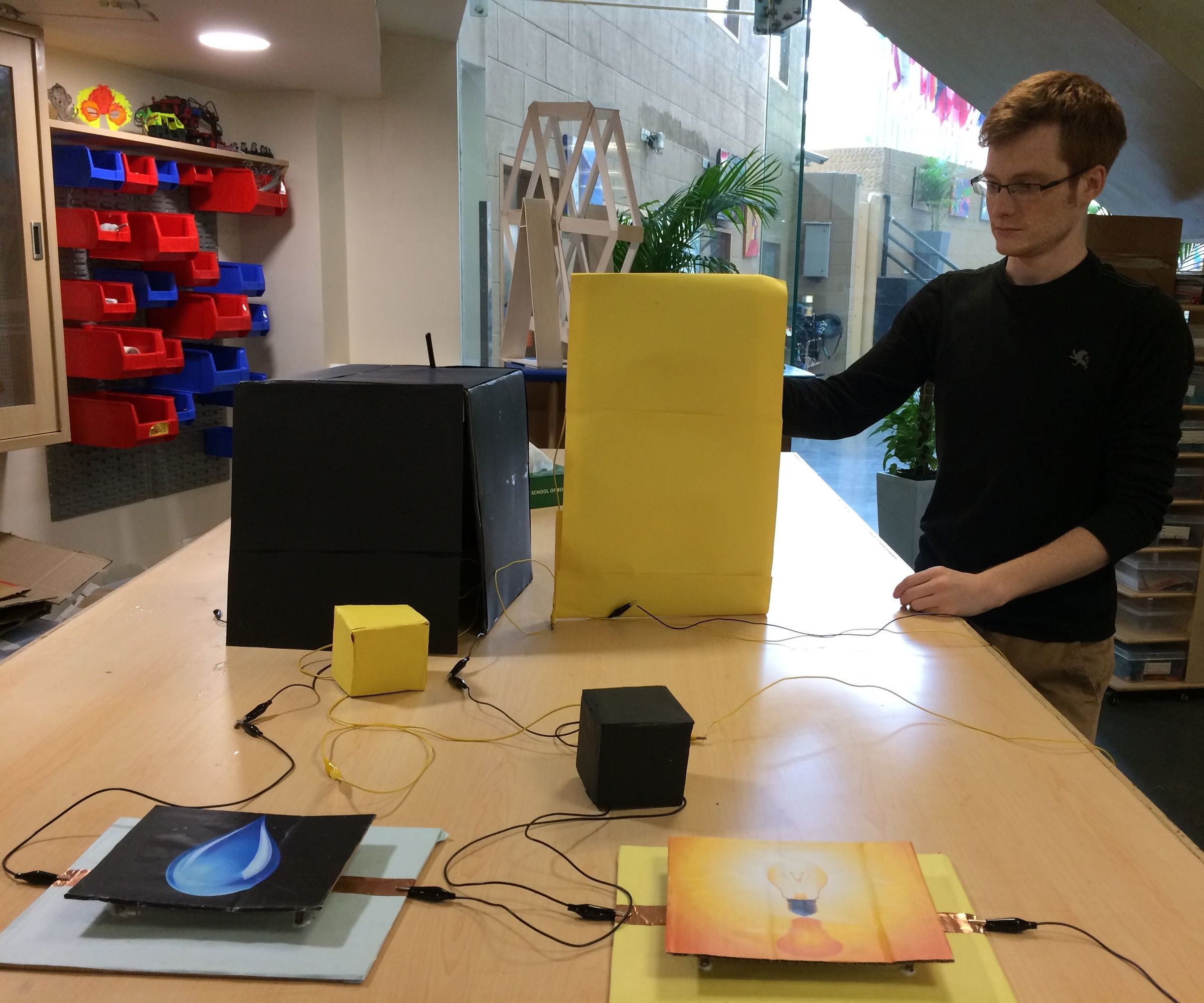

Step 2: Wire the Arduino and Bread Boards
Following the attached file, wire the arduino and bread boards. Ensure to plug the wires into the correct slots in both boards. While some slots may serve the same purpose, you will need to edit the code with to work with different slots. The diagram also shows a moisture sensor, but the same thing could be done using any two conductive materials. For example, using nails, attach one wire to one nail and the other to the other nail and push the nails into the soil. For the motor, battery, moisture sensor, and LED's, which are not in the breadboard, wire one end of the wire into the other end (not connected to the materials listed above), and the other two a alligator clip of the same color. Attach the other end of the alligator clip to the appropriate terminal of the materials listed above.

Step 4: Setup and Adding Aesthetic Appeal
Now your circuit knows what to do and how to do it, but it still needs to be implemented into a plant. First, place the moisture sensor or nails into the soil near the plant. Next, tape the led's to a wall such that they are pointing to the plant. If you like, you can tape the yellow paper on top of the LED's, making it look more like the sun. Then, attach the two pipes to the ends on water pump and tape the pipe taking in water into the bucket of water and the other pipe to the pot so it points directly into the soil. Finally, create a box using the following instructions to both hide the boards and keep them dry form splashing water.
- Take a large cardboard cube (with 4 sides) with minimum length per side of 30 centimetersIf the cube has less than 4 sides, you will have to get another piece of cardboard to have 4 sides.
- If there are more than 4 sides, cut of cardboard side until there are 4 sides left.
- Cover it with thick sheets of black paper in order to aesthetic appeal. Cut the paper as necessary and then use a glue stick to glue it on.
- Also put the paper on one more cut of side to create a removable fifth side of the cube.
