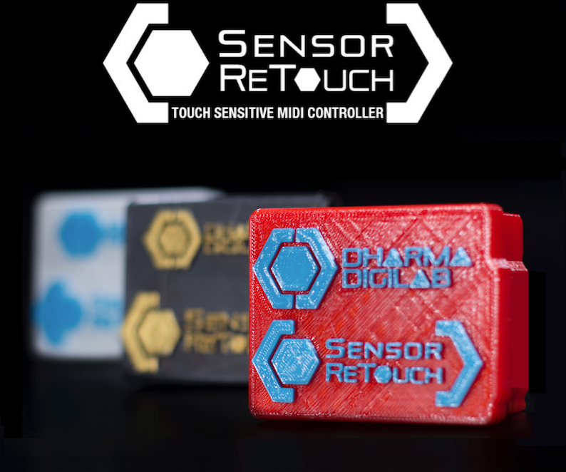

Step 9: Final Step Assembly / Print the Enclosure
If you want to move the Sensor Retouch and bring it with you wherever you want you need a case containing Arduino board and Touch Sensors. That’s why i recommend you to 3D Printing a case for the whole sensors and Arduino board, in this way you’ll be able to bring Sensor Retouch wherever you want and keep it safe.
I 3D printed different case colors as you see in the picture if you need a case for your own Sensor ReTouch i give you few links for the Arduino enclosure you can find freeware and downloadable on Thingiverse.com
Links for Arduino UNO case on Thingiverse.com
Model 1
Model 2
Model 3
Choose one and 3D print your own
Step 10: First Look on Sensor ReTouch
Once it’s done you are ready to put Arduino board and Touch Sensors inside the case you’ve 3D printed previously and it should look like this as the Picture.
Now your Sensor ReTouch is portable and it’s ready to come with you wherever you want and have fun. Be ready for the next Step i’ll teach you how to program Arduino board with the IDE code i written, do this operation in order to switch on each Touch Sensor and let them produce a MIDI Impulse each time you touch them.
