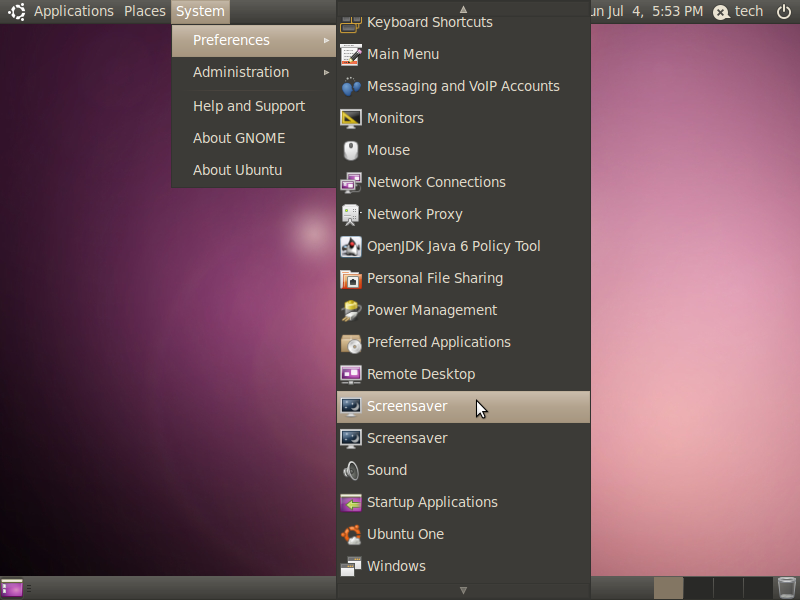

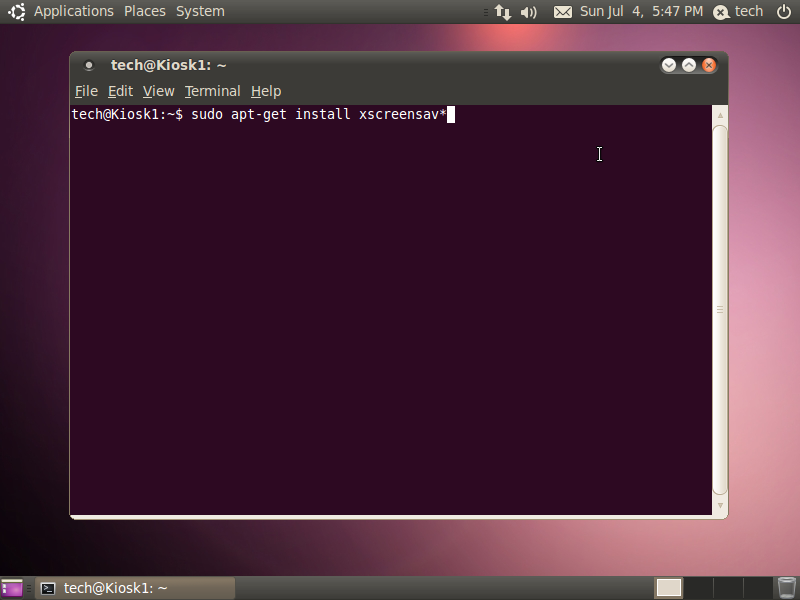

STEP 1: Add XScreensaver & Ubuntu Restricted Extras
On our systems we found that even LCD monitors got burnt in after time. They are not supposed to be able to do this, but they were. To remedy this, we tried to get the default screensavers to come up. They were not great at running from a script. Instead the best option for this is to install the xscreensaver packages. I like to do this from the command line so click Applications, highlight Accessories, and click Terminal. From there enter the command "sudo apt-get install xscreensav* -y" without the quotation marks. The asterisk at the end allows aptitude to install all of the packages that start with xscreensav, thus installing all the additional screensavers available.
If you will be using flash you will need to install the plugin for it. The best way I've found to do this is similar to adding xscreensaver. In the terminal window enter "sudo apt-get isntall ubuntu-restricted-extras -y". Once this is done close the Terminal window.

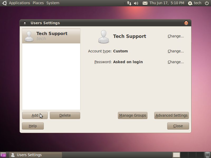

STEP 2: Create a Basic User
You will want a restricted user for the end users to use that does not have sudo access and cannot change system settings. This way the Web Kiosk cannot be compromised as easily. To do this click System, then highlight Administration, and click Users and Groups. Once there click add, type your password to get past the authentication window, and input a generic username (I used Scholar). To set up the account set a basic password for now and click ok. You will want to click the Advanced Settings button in the lower right side of the window and choose the User Privileges tab. From there uncheck all the check boxes that you do not want users to be able to access. Then you can close the Users Settings window.
STEP 3: Set Up XScreensaver
Once your new user has been created, log out of your regular user and log into the restricted user account. Next run XScreensaver's configuration window for the first time so that it will create the necessary configuration files. You can find this configuration window by clicking System, highlighting preferences, and finally clicking the top Screensaver option. If you hover over it, it should read "Change Screensaver Properties". The XScreensaver will then ask you a few questions about disabling Gnome Screensaver and starting it's own Daemon, just click ok to all of these questions. You can set which screensaver's you would like to see by checking the box to the left of the screensaver's name. The option that says blank the screen after really stands for how long you want it to wait before starting that screensaver. The option just below it is for how long before it changes from one screensaver to the next. I like to let mine start after 10 minutes and change every 2 minutes.

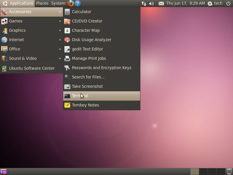

STEP 6: Set Up Kiosk Desktop Mode in Xsessions
Next you'll need to switch back to your regular user so that you can use sudo once again. Once in the regular user account, click Applications, Accessories, and Terminal. On the command line type: "sudo gedit /usr/share/xsessions/kiosk.desktop" Then in the resulting window insert this code:

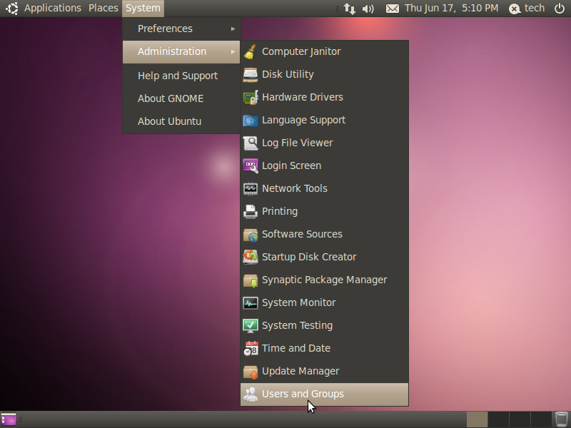

STEP 7: Autolog User Into Kiosk Mode
Next up is to allow anyone to log into our generic account and to set up the computer to load this account on startup. First click System, highlight Administration, and click Users and Groups. This should bring up a window that shows both accounts available on the system. Make sure your regular account has the password asked on login so no one else can get in and mess up the system. Then click on your generic guest user account (Scholar in my case) and click the change button next to the password field. In the next window that shows up select "Generate random password" and check the box to allow login without asking for the password. After this is done, close the user settings window. Next click System, then highlight Administration, and finally click Login Screen. In the lower right of the Login Screen Settings window that comes up there will be a button that says Unlock. Click this button and enter your password. After you click authenticate, the window will allow you to click the different options available. Select log in as your restricted user allowing 2-5 seconds for anyone else to log in first. This will allow you to make changes if anything isn't set right in the future. Also select Kiosk Mode as the default session and click close.
