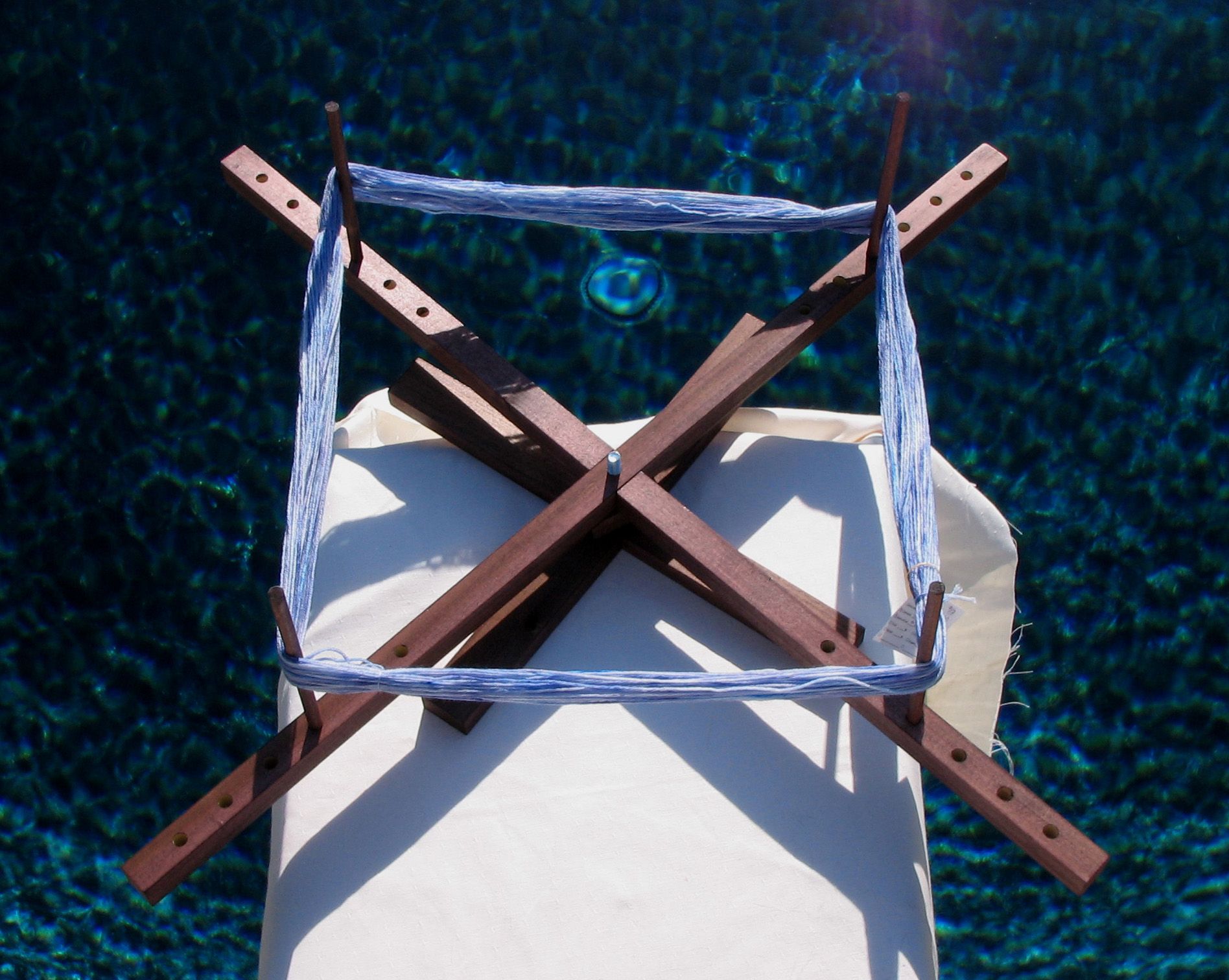

Introduction: SewUseful: Portable Tabletop Yarn Swift (for Winding Yarn)
Make this using everyday garage tools -- no fancy skills or tools needed!
I quickly grew tired of winding skeins of yarn on the backs of chairs and over my knees. I considered getting a yarn swift, but I balked at the price tag ($65 and up). Determined to utilize my crafty hands, I embarked on making my own yarn swift out of stuff from my garage.
My first yarn swift cost me $7 to make, and because I dye yarn, I soon found the need for a second swift, which cost me $17 because I had used up extra wood in my garage for my first swift. Depending on how much material you have in your garage, this project will probably cost anywhere from $0 to $20 USD, plus a little elbow grease.
This is a tabletop swift that is easy to make, using basic garage tools. No fancy power tools! It is also easy to assemble for quick storage and portability.
This is a Sew Useful contest entry, so if you want one or don't think you can make one, I have one for sale on Etsy: http://www.etsy.com/view_listing.php?listing_id=6465064

Step 7: Marking and Drilling Peg Holes
You're almost done now!
The Holes:
Mark where you want the dowel pegs to go on the tops of each arm of the X. Keeping your drill perpendicular and using your 3/8" drill bit, drill the peg holes. Do NOT drill all the way through. You want to go as far as you can without going all the way through. It helps to mark how deep you want the drill bit to go with masking tape. This way, you'll know when to stop and won't accidentally go all the way through. I suggest about 4-6 holes on each arm spaced about 1-1/2" or 2" apart.
The Pegs:
Cut your dowel rods to length. You'll need 4 pieces of the dowel rod for the pegs. I suggest cutting them at least 6-8" long. Longer pegs will hold a large skein of yarn better.
The Holes:
The Pegs:

Step 9: Assembly
Assemble as shown in the photo.
If you chose to use a block instead of a CD, simply put the block on after the nut and then put the arms on top of that.
Your DONE!
To prevent your swift from slipping and moving around on your table, cut a piece of anti-slip rubber liner and place under the swift. You can find the rubber liners in the shelf liner and/or the rug section of your local grocery, drug or hardware store.
Happy yarn-winding! :)
