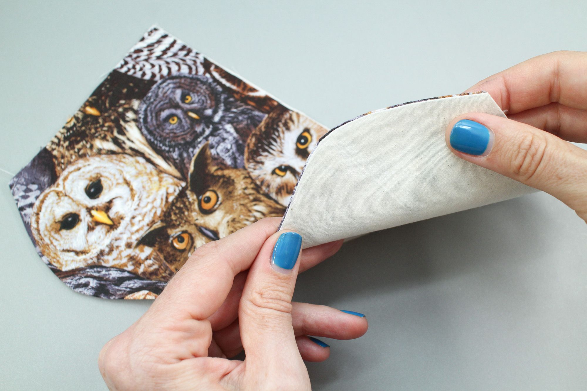

Now we are going to flip the fabric so the right sides are facing out, but before we do this, we need to do something else to the seam allowances so they will lay flat.
On the convex areas of curve, the wider area of seam allowance will have to fit inside the smaller area on the other side of the seam once we flip the fabric, and it will end up bunched up. So in these areas we need to clip little triangles out of the seam allowance to make more room. You can do this with scissors, cutting right up to the stitching line, but not through it. The more clips you make, the flatter your seam will lay.
On the concave areas of curve, the smaller area of seam allowance will have to stretch to fit around the larger area on the other side of the seam once we flip the fabric. So in these areas we just need to cut slits in the seam allowance so it can spread. The more times you snip, the flatter your seam will lay, but no need to get too carried away.

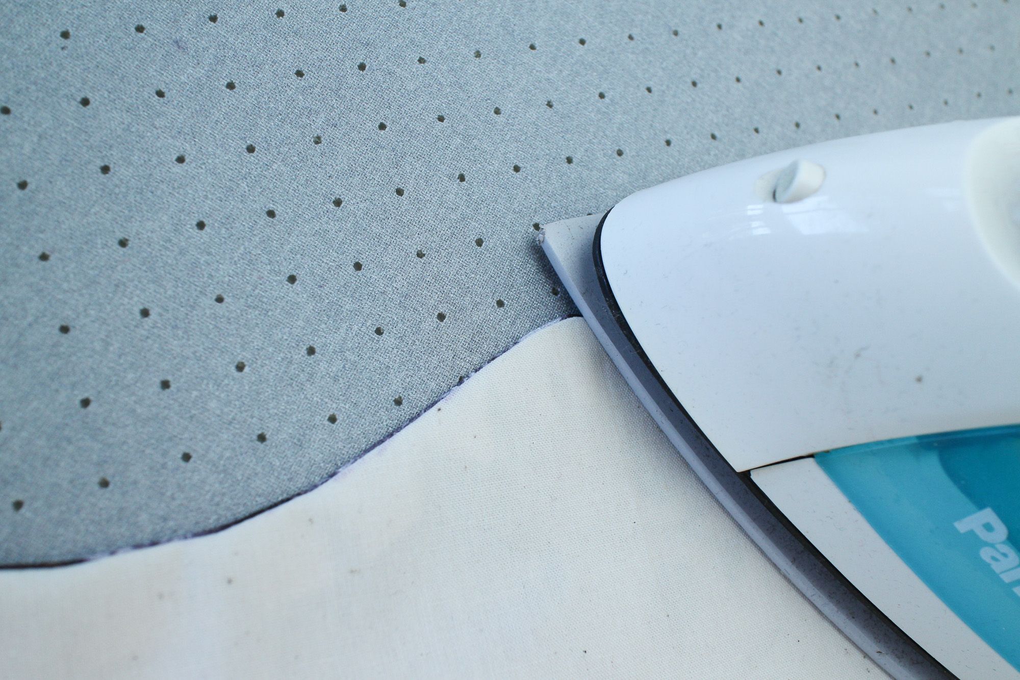

Now flip the whole thing right side out. Use something pointy like the end of a pencil or a ruler to push out the seam from the inside and round the curves.
Press with your iron to create a neat, smoothly curved edge.
If you look in between the two layers, you will see where the seam allowance is spreading and squeezing together on the two different kinds of curves.

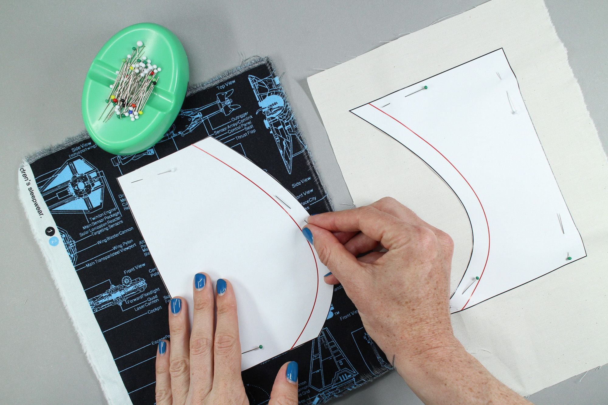

To show you how to do this, I'm going to use a very simple pattern. The pattern is attached at the bottom of this section if you want to download and print it, or just create your own.
Cut out the two paper pattern pieces and pin them onto the right sides of two different kinds of fabric, lining them up with the grain. It helps to put pins close to the edges of the paper, to hold it down as you cut.
Use your scissors to cut around the edges of the paper.

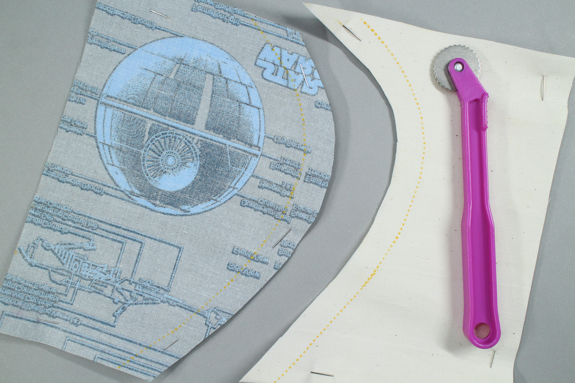

Now we're going to mark our seam allowances using a transfer wheel and transfer paper. Spread the transfer paper out face up and lay your pattern pieces on top of it with the patterns still pinned on (if you're using light fabric, use dark transfer paper and visa versa). Trace the sewing lines of the curves with the tracing wheel, pressing down fairly hard.
You should see a line of dots on the wrong side of the fabric. This is how you will usually mark seam allowances when you're using a sewing pattern.

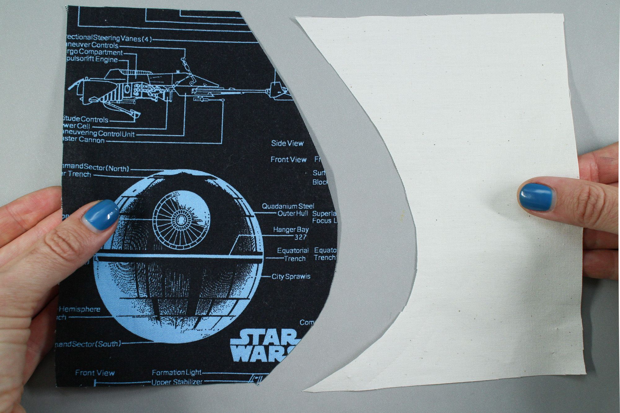

To create our seam we need to sew these two pieces of fabric together with wrong sides facing out, but as you can see, when we lay them on top of each other they don't match up at all! In fact, they are the opposite of each other! So what do we do about that?

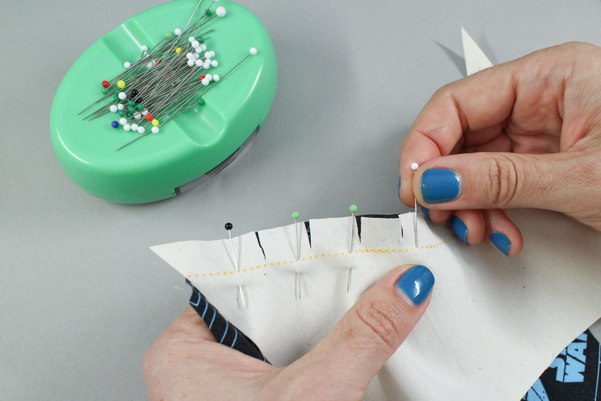

Much like we did with the curved facing, we need to snip our concave seam allowance so it will stretch around the convex one. Cut slits in your concave seam allowance, about every inch, stopping 1/8" away from the sewing line.
Now lay the concave piece over the convex piece, with right sides facing and start pinning them together so the sewing lines match up. The concave piece will end up bunched up beyond the seam allowance, and that's ok.
Now sew along the sewing line, pushing the bunched fabric out of the way as you sew and being careful not to sew any folds into the seam.

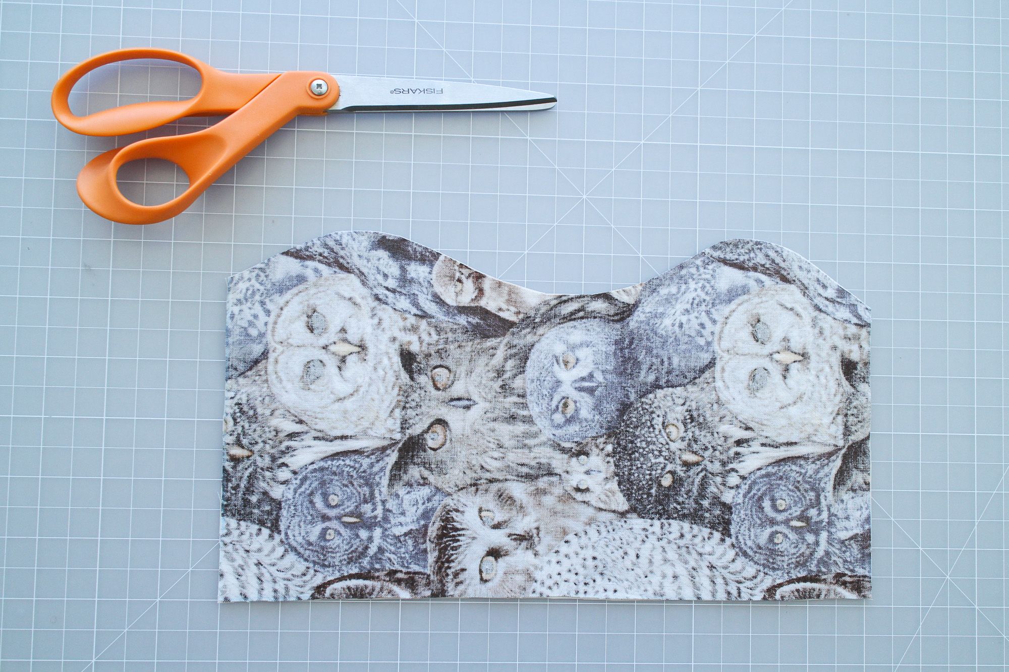

When you're done the two pieces should open up and lay flat. Press them with your iron with the the un-snipped convex seam allowance over the snipped concave one.
Trim the ends of your seam allowances and you have a nice paneled square!
