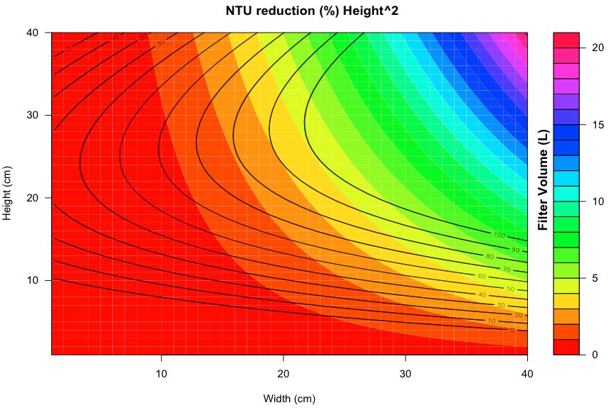

Because the water should always be cleaned 100% or as close as possible the table NTU Reduction (%) above should be consulted if using different dimensions for the filter. NTU stands for Nephelometric Turbidity Units. It is a unit of measurement for the amount of particles floating in water. Drinking water has a value under 10 NTU, generally around 4 and visibly dirty water has an NTU over 15-20. NTU is measured chemically or optically. We have some design ideas for an open-source sensor, or several and would like some making them.
Although technically a 10W UV lamp can be sufficient for the removal of E.coli which is used as an indicator of water quality, other bacteria and viruses are much more potent and so we chose to use very high concentrations of UV light in order to create a safety buffer. According to our research the powerful lamp is more than sufficient in removal of bacteria even when the filters fail which means that even if the water looks, feels or tastes funny there shouldn’t be adverse health effects due to microbial action. If it does though, then it’s time to check, maintain or replace the filters. Using multiple UV lamps might be a good way to both ensure that the water is always bacteria free and all excess heat goes into maintaining water temperature.

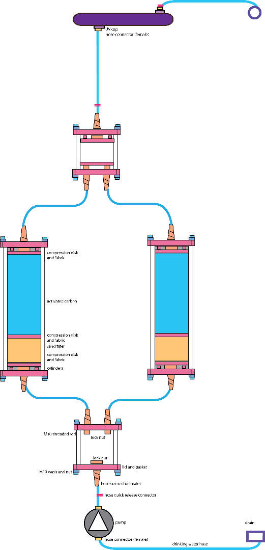

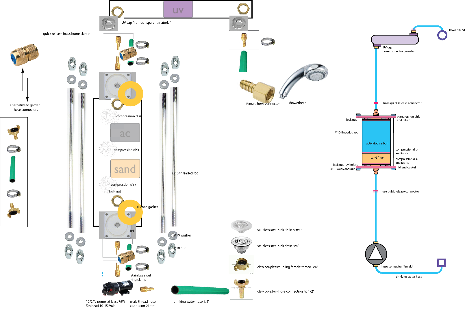

Step 2: Overview - Theory

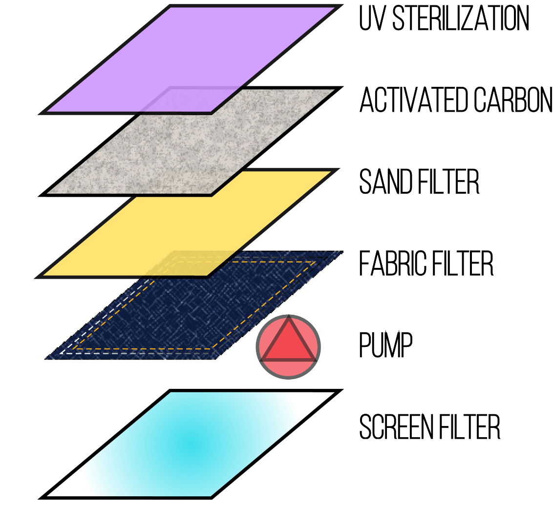

So the main components of the filter are the pump, filter housing with the sand and activated carbon filter and the uv-lamp.
Large particles like skin cells are trapped by a layer of compressed sand. Finer particles are adsorbed by a layer of compressed activated carbon, including some chemicals like nitrates (in sweat), sulphates (in soap), chlorine and fluorine (in tap water). Finally the UV-lamp is used to sterilize the water so that bacteria can no longer reproduce. It might not seem like a big deal since our bodies are covered in bacteria but the main concern is bacteria from your bum coming into contact with your eyes.
- Cut filter parts
- Cut the filter housing pipes
- Cut or make gaskets
- Assemble flow regulators
- Assemble filters
- Assemble the UV
- Connect all the parts together

Step 3: Assembly Overview
I hope this isn't too confusing but there are many ways to setup the filters depending on your needs. Here are two different ways of setting it up. The first one is the most simple build (simply called 'Simple'). The only down side is that the filters quite wide with a 20mm tube with compression disks and lids also made to fit this. For this instructable I'll be going through the 'Showerloop POC21' version because it was designed and built at the POC21 innovation camp (poc21.cc for more information) in France. I had an amazing experience and met awesome people that have really contributed to the project and making this Instructable possible. The photos shown, are from there. I don't mean to confuse you but just to show that there's are alternative ways connecting things together.
Simple
POC21 Build (this Instructable)

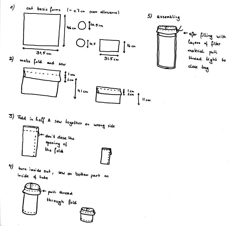

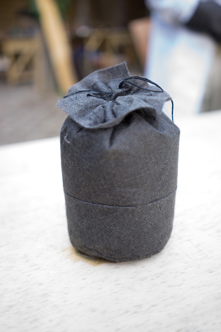

How to assemble the filter bag. Also for this there are two options, either just cutting the circle together (and either bolting it to the compression disk or just compressing it between the filtrates sand or activated carbon) or making a filter bag out of a landscaping geotextile. The benefit of using the filter bag is that changing the material is much easier, the down side is that you can't see what's going on with the filter. Personally I like to see the water flowing through the filter. Thanks to Katharina for actually making the bags and these simple and amazing instructions:

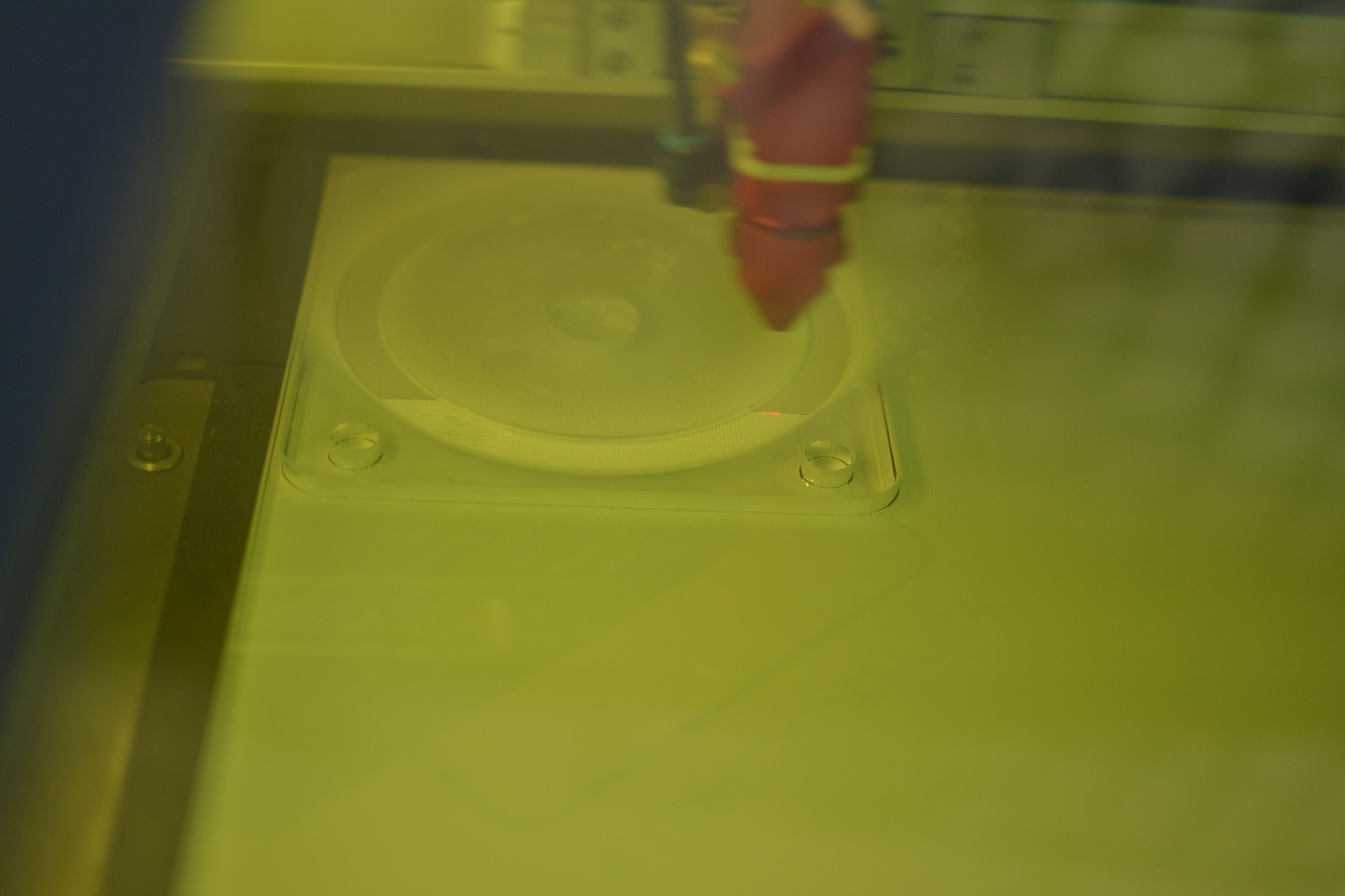

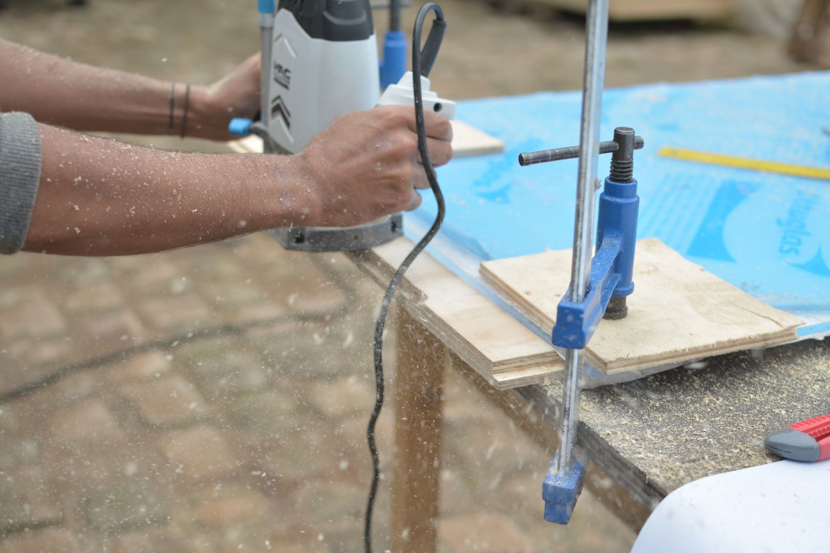

Laser cut or CNC the files in the pdf Showerloop_filter_lasercuts_POC21_v3.pdf
Since laser cutters handle cutting a bit differently there may be come problems with the file. Generally red / hairlines (0.001mm) is for cutting and black is for engraving.
!If you don’t have access to a laser cutter or CNC machine, a manual router can be used to cut out the groove in the filter and the whole shape if need be. To cut a perfect circle with a router a special tool may need to be made (look for circle jig on youtube).
The lids and mounting plates can also be a single piece if you are using thick material. Four 10cm diameter x 50cm filters are required to have an appropriate flow rate of 10l/min. With 6.6l/min two filters are sufficient and 1 filter for 3.3l/min. The surface area is more important than the length of the filter because that determines the flow rate through the filter and thus reaction times. I use 10mm thick acrylic sheets for the lid and compression disks but I have used 4-5mm acrylic sheets in previous prototypes and glued them together with decent results.
A CNC machine is preferable and much, much faster.
About laser cutting: People usually only think of laser cutters being able only to etch text or a picture or to cut through a material, but playing around (carefully that is) with the settings on the laser cutter you can basically mill into a material with millimetre precision. Be warned etching deep into acrylic is probably the slowest thing you can do and making a lid can take up to two hours or more once you have figured out the ideal settings. >> Settings for Aalto FABLAB EPILOG LEGEND EXT - 60 Watts: VECTOR: POWER= 100%, SPEED= 2%, FREQUENCY= 5000 Hz, ENGRAVE= POWER=100%, SPEED=8% (etch away around 4mm), FREQUENCY= 5000 Hz ! Be careful and minimize the flame size (there shouldn’t be any).

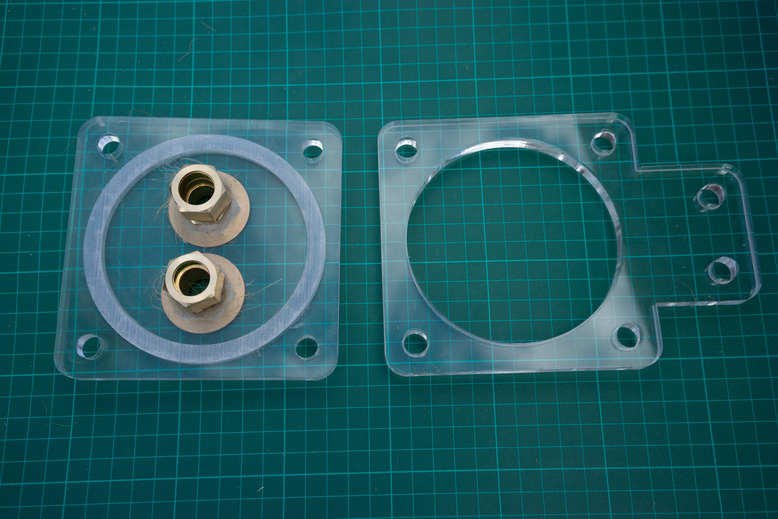

Lids for filter

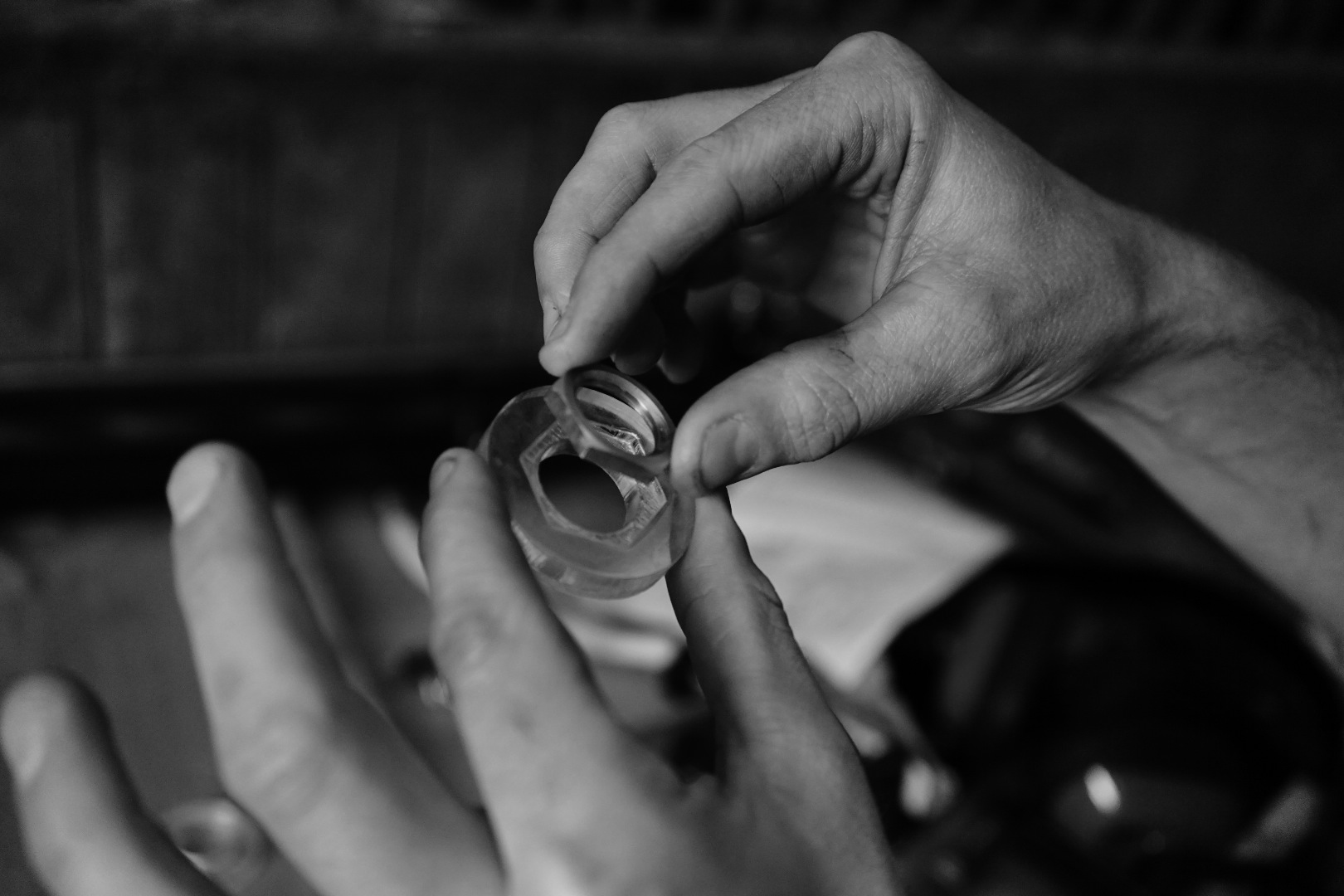

There are 2 lids per filter, the top lid and bottom lid - duh.
A hex nut is used to fasten the hose nipple (facing away from the filter) to the filter lid. The dimensions of hex nuts and/or hose nipples may vary regionally so it's best to get them first,check the measurements and modify the file if needed. In the picture of the lid only a circle was etched/milled into the acrylic lid to fit the hex nut but the design was later revised to have the shape of the hex nut itself, thereby fastening it to the lid so that it could no longer rotate (and prevent fastening) when adding the hose nipple on the outer side of the lid.

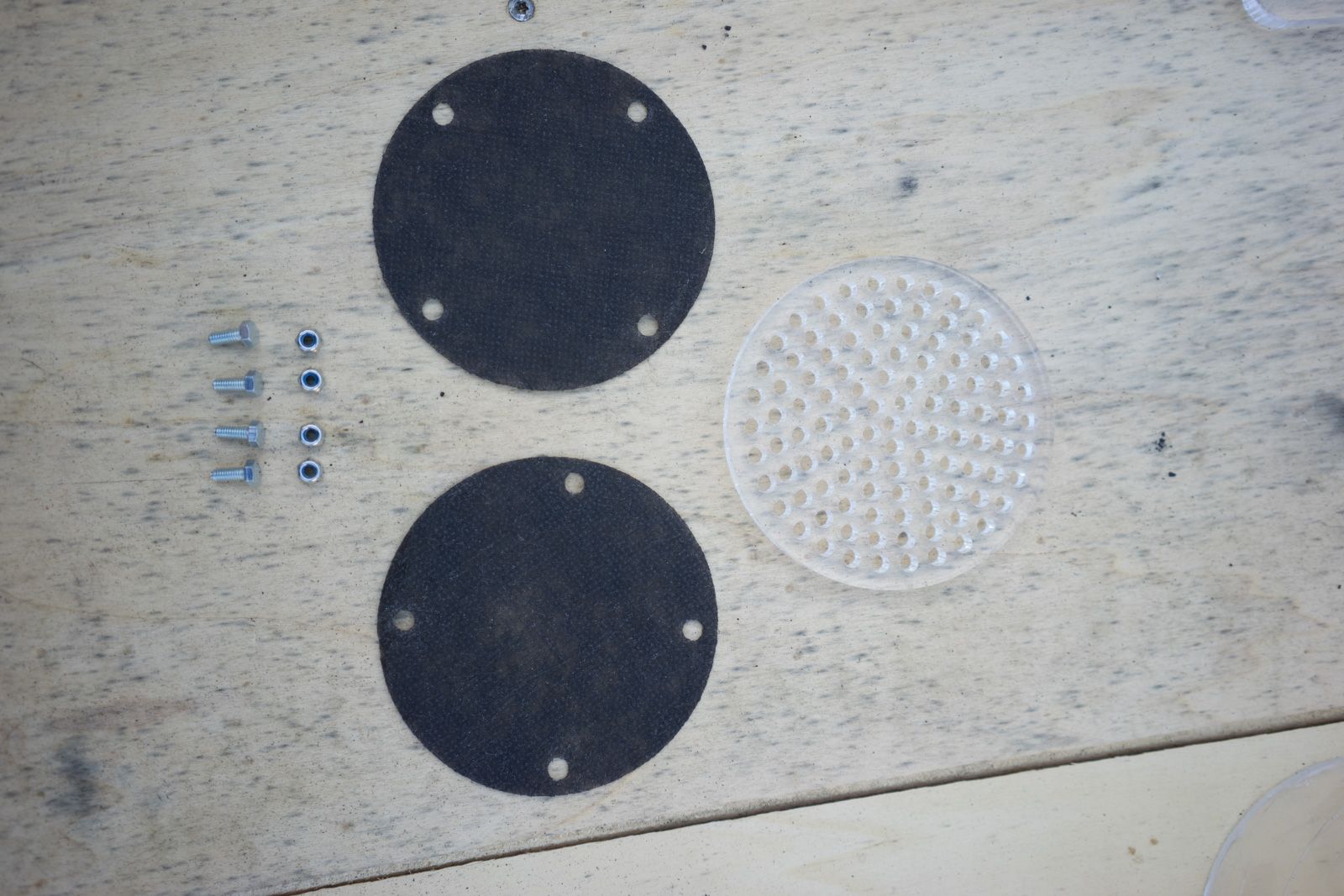

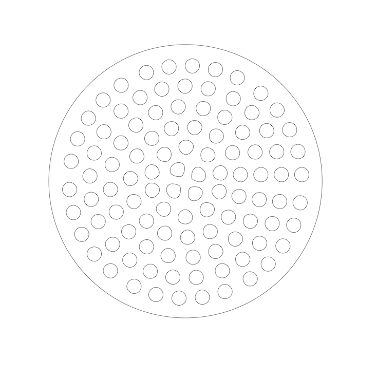

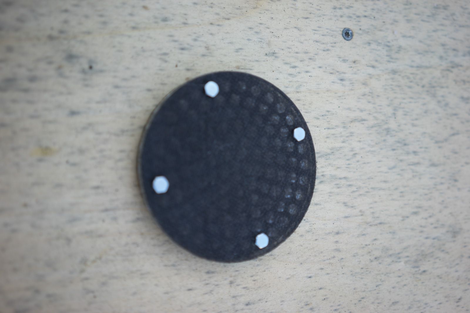

Compression disks
There are 3 compression disks per filter. Two on both ends for squeezing in the sand and activated carbon and one in between the sand and activated carbon! The compression disk in the file is nested inside the void of the mounting plate to save materials!
Fabrics
3 per filter. Width should be 10-15% larger than the inner width of the filter housing, in this case it's 115 mm. Lasercut (low power) or scissor cut the fabric membrane.

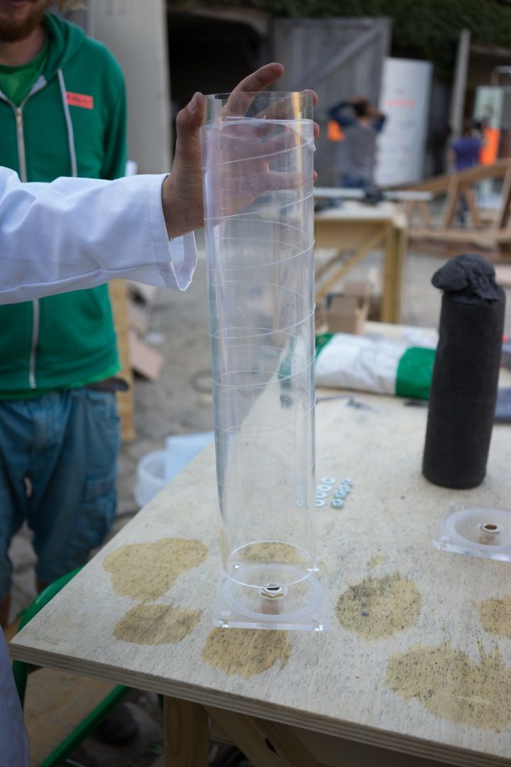

Cut the transparent acryclic pipe with a band saw if available or with a hand saw.
The filter housings should be 55 cm long and the flow regulator pipe should be around 10 cm long but shorter bits may work just as well and therefore require less water. The flow regulators can be left out of the build completely but there's something great about being able to see dirty water in the lower one get cleaned up by the filters and to get visual feedback in the top one which should be around eye height.

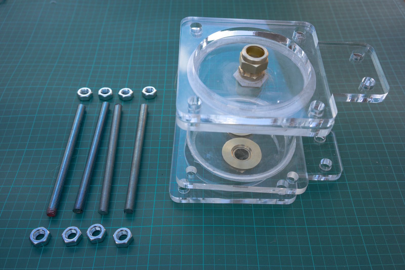

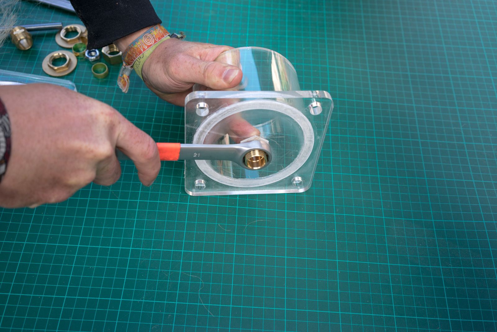

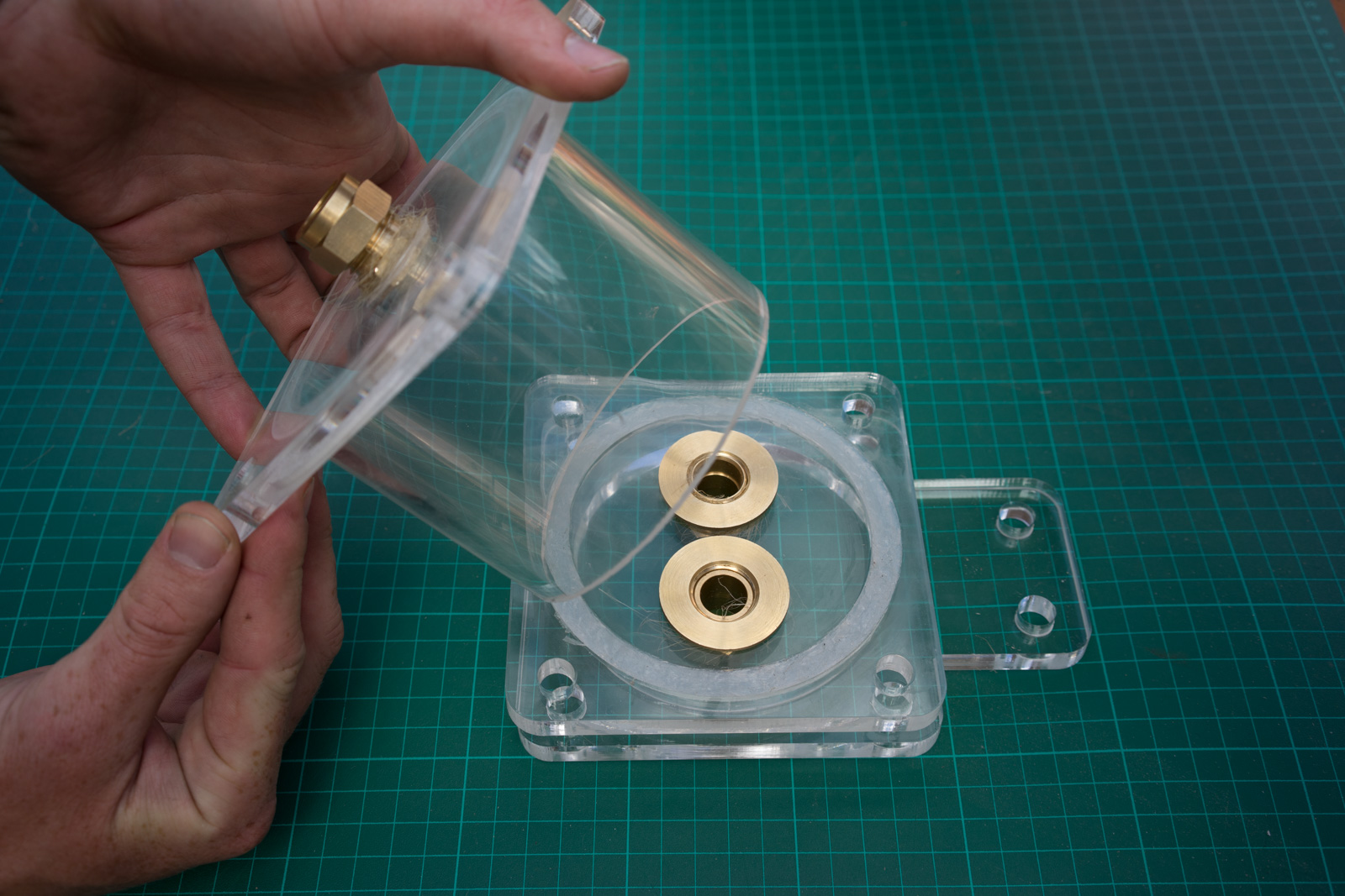

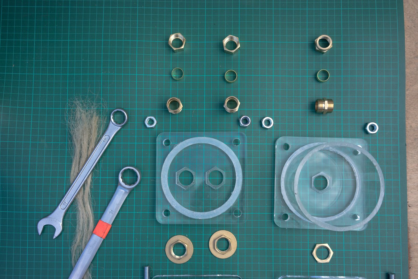

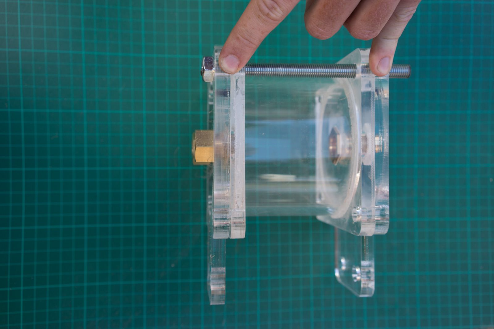

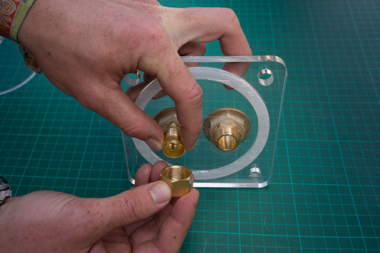

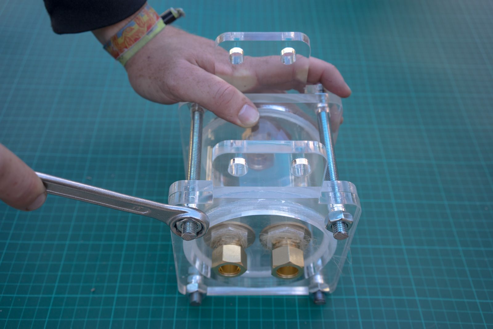

Step 7: Assemble the Flow Regulators

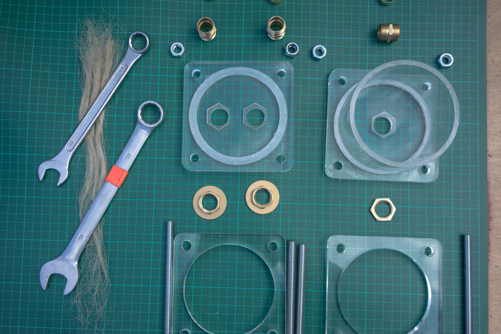

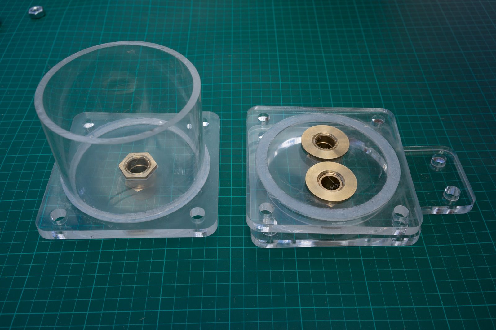

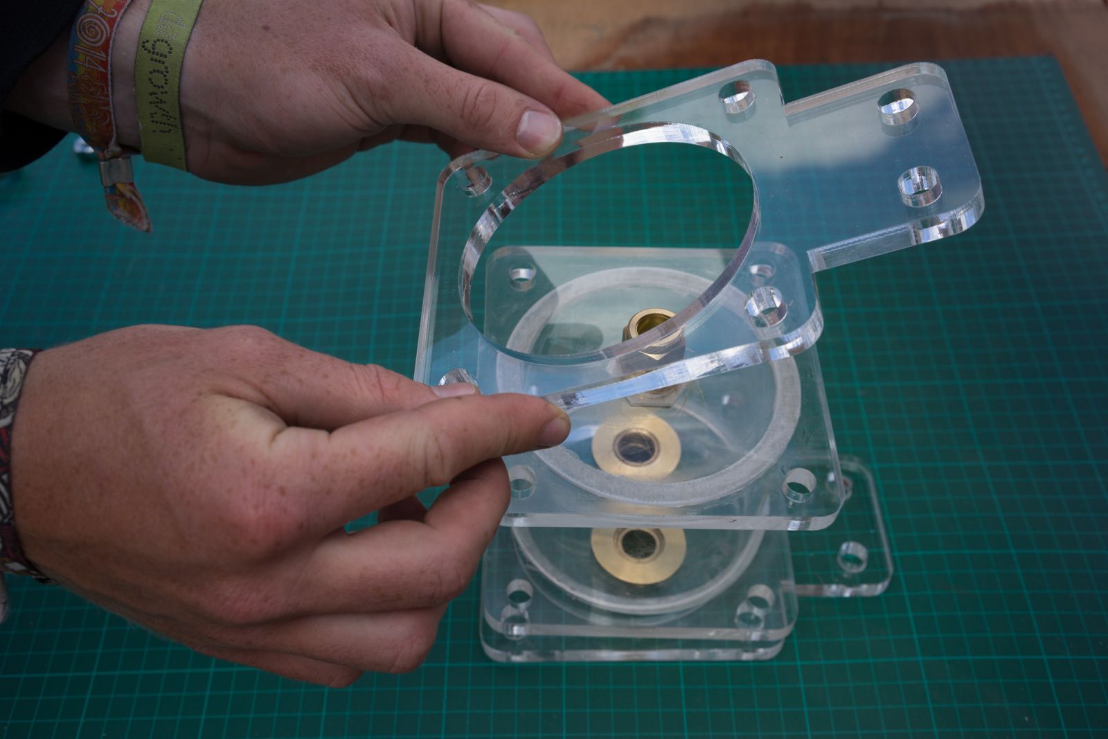

For the flow regulator build:

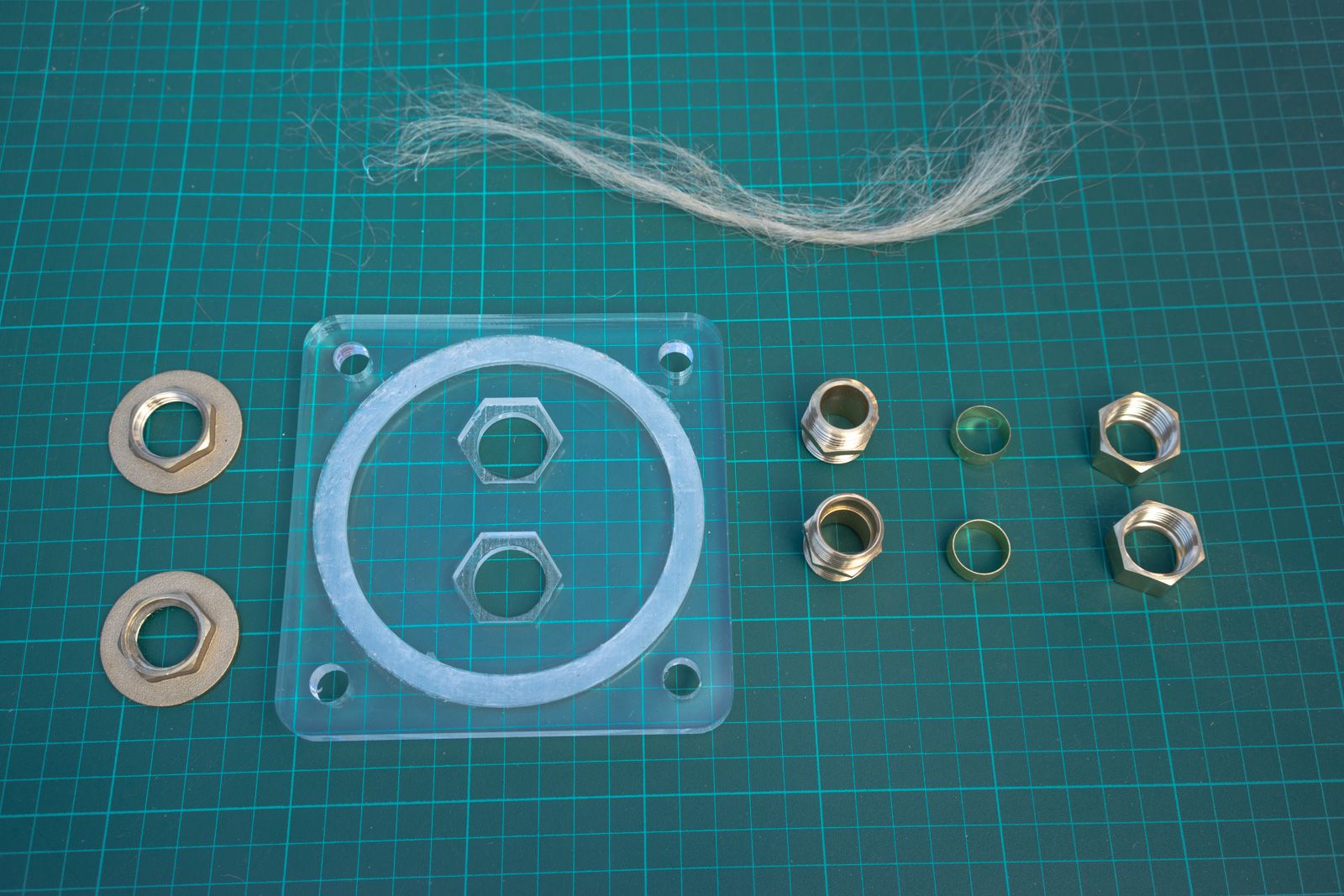

The flow regulators go together in the same way that the filters do but because they are somewhat simpler and the shape of the locknut was added I'll explain this part first.

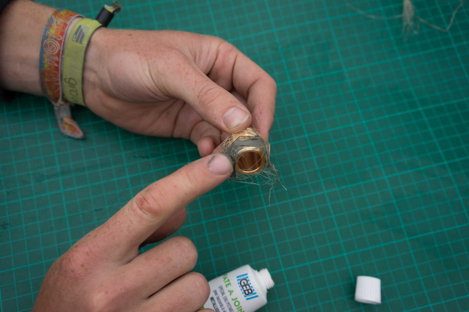

Parts: hemp fibre, mineral oil, brass union with pipe connector (3), pipe rings (3), locknuts (3), threaded rod (14mm x4), acrylic tube (10 cm) lid 1 (10 mm), lid 2 (10 mm).
If you are using 3 filters make sure the flow regulators also have 3 outputs and 1 input for the top flow regulator and vice-versa for the bottom one. This flow regulator is only connecting to two outputs. This whole step could be replaced by a simple 3-way t-connector, but seeing the dirty water enter the bottom flow regulator and clean water enter the top one is cool.
The tube is much shorter with 10 cm length and is glued with silicone to the lid. Filter connectors on the left, pump connector on the right. As pressure is higher on the input end, if you use silicone (instead of gaskets) it's best to glue the input side.
The lids and the mounting plates would probably survive being a single piece. It's possible to heat and bend the acrylic to have a 90 degree angle and there by allow you to screw the filter into the wall and not through the wall.

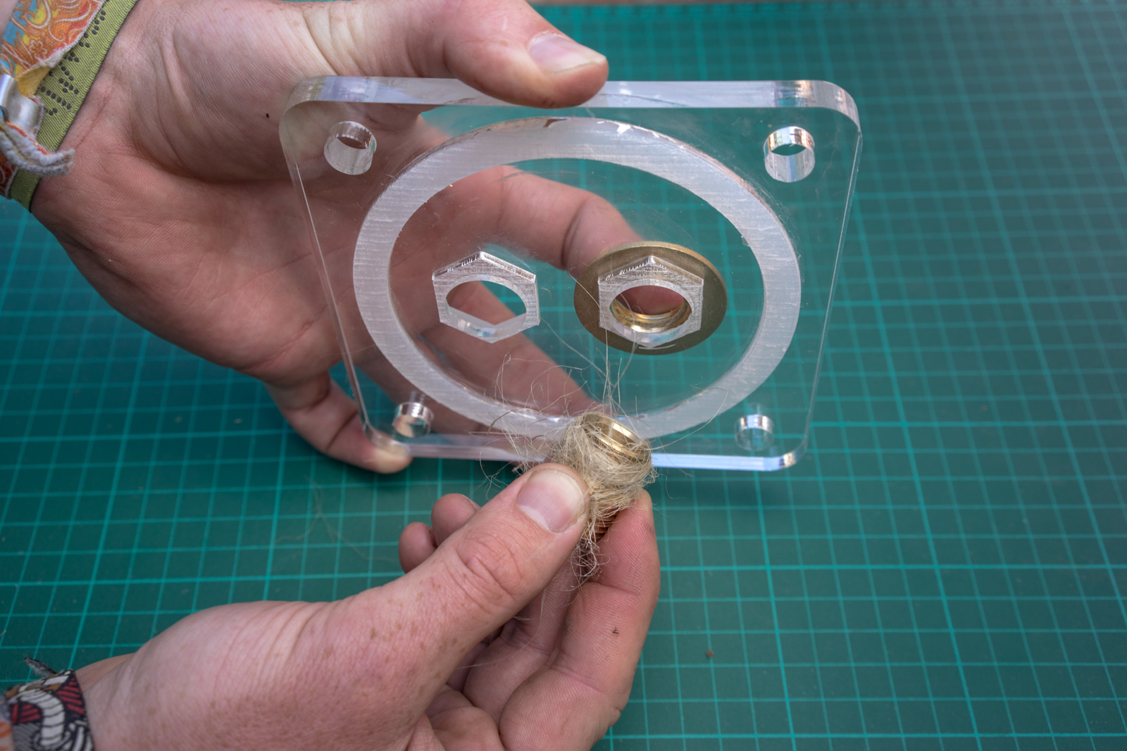

Attach the locknut and the copper union together with the lid in between. The bottom flow regulator has one input (from the pump) and two outputs to the filters and the top flow regulator has two inputs (from the filters) and one output (to the UV).
This part may take some practice figuring out just how much fibre to use. You can also replace the fibre with teflon tape (pipe tape) and as a rule of thumb I do about 8 layers (times around) but it depends on the size of the hole.
hold the lock nut in place while using a spanner to tighten the union to the lock nut. a hose nipple can also be used instead of the copper union.
Then do the lid on the other side.
So the order is mounting plate, lid 1 (with lock nut and union), tube, lid 2 (with lock nut and union), mounting plate, threaded rod, nuts.
Tadaa

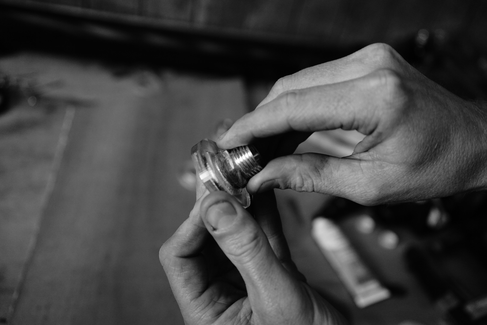

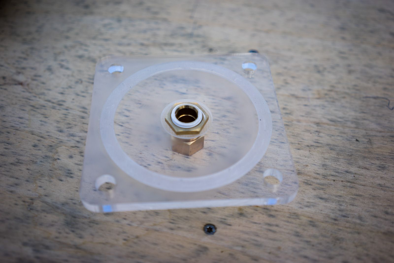

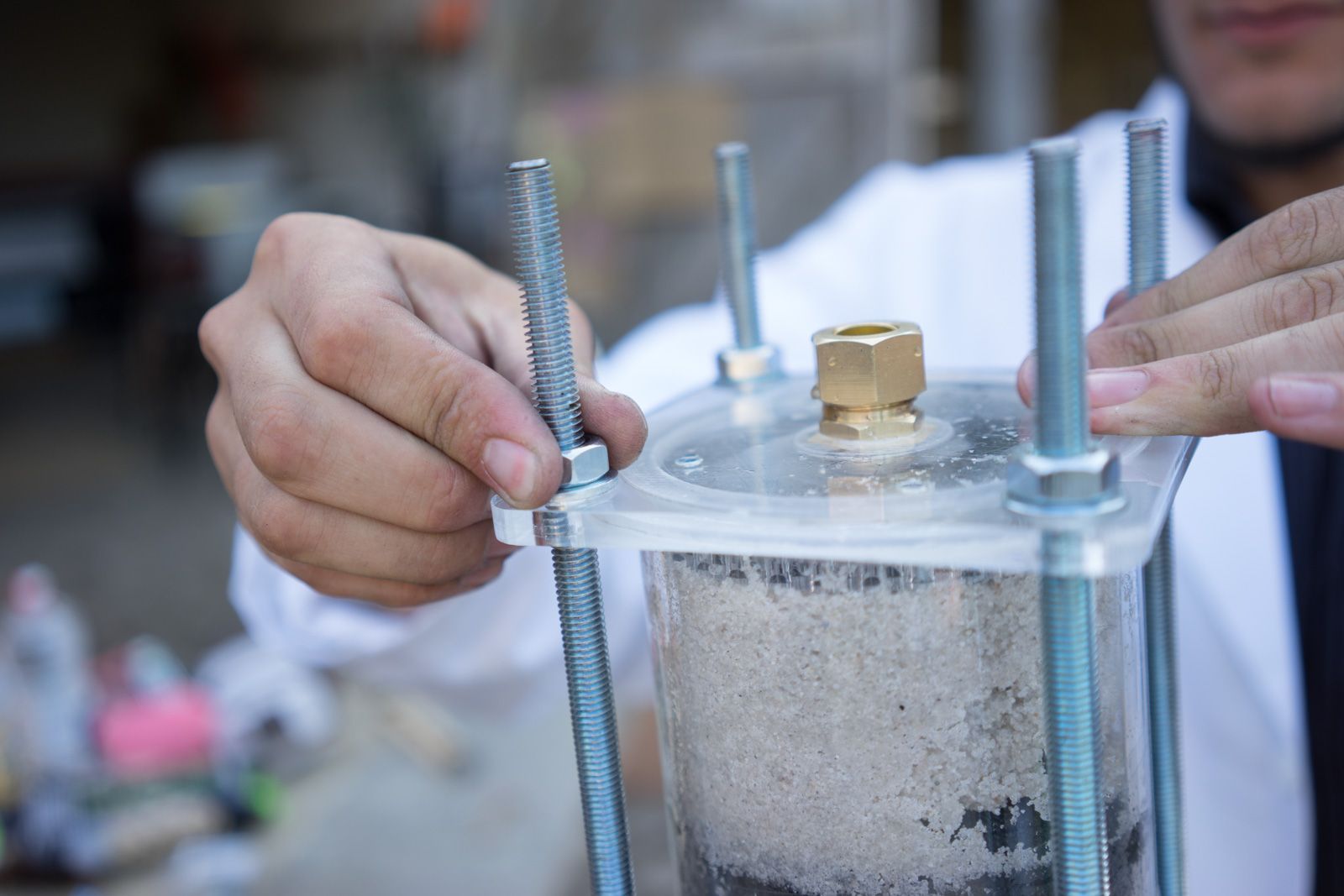

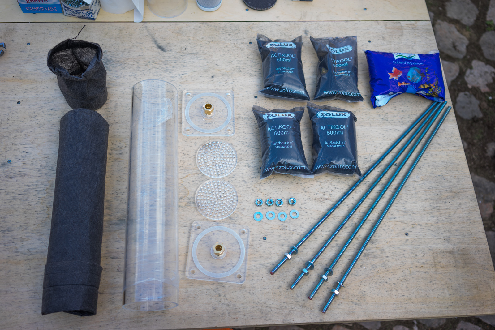

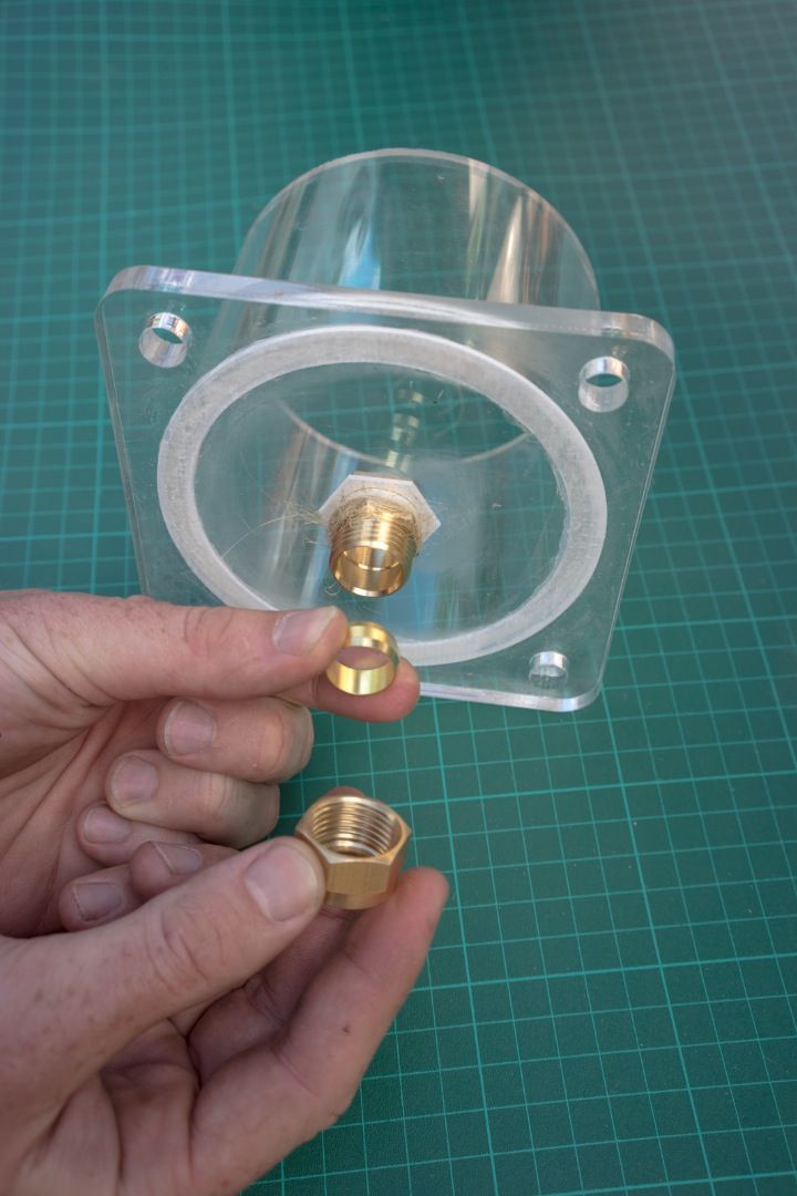

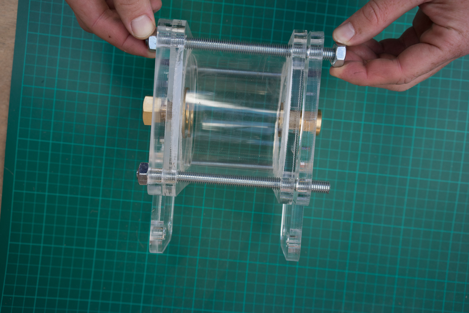

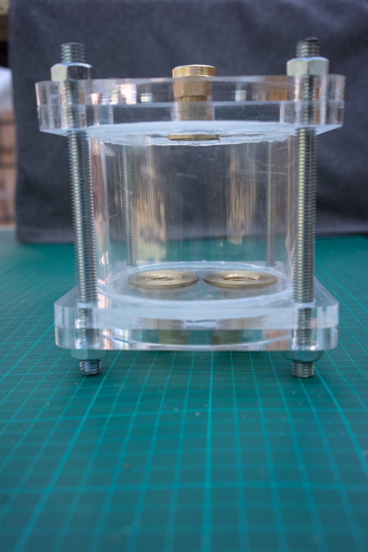

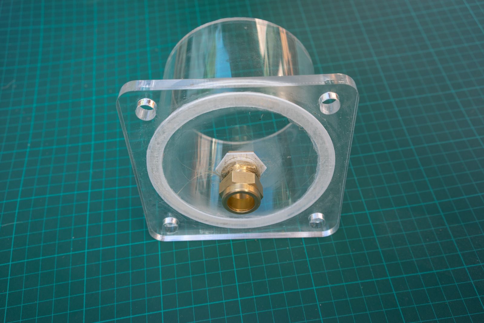

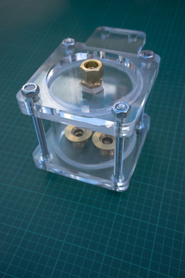

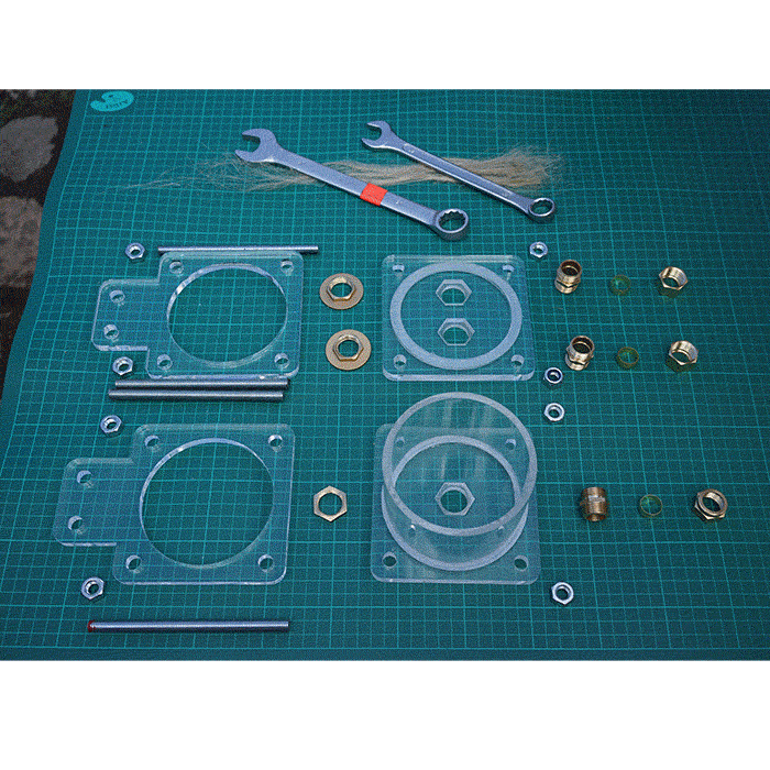

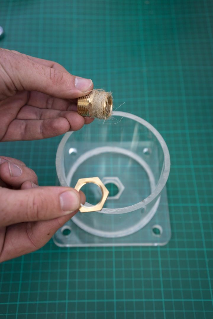

Step 8: Assemble the Filters

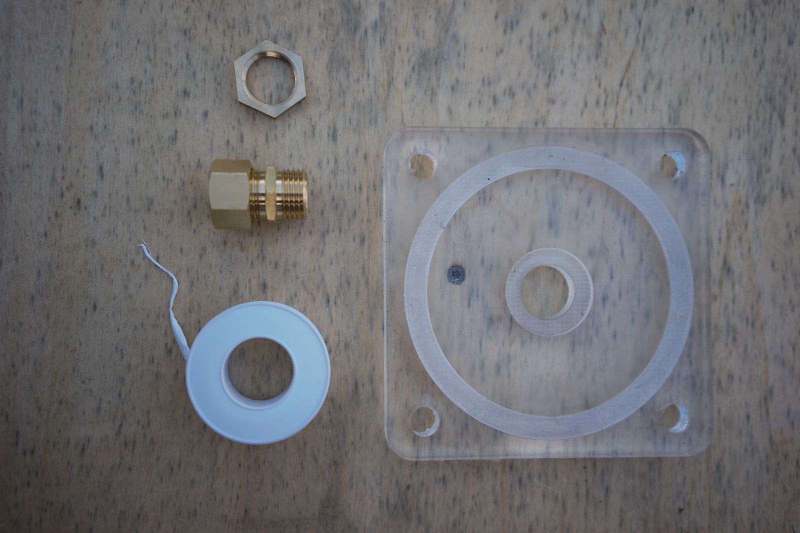

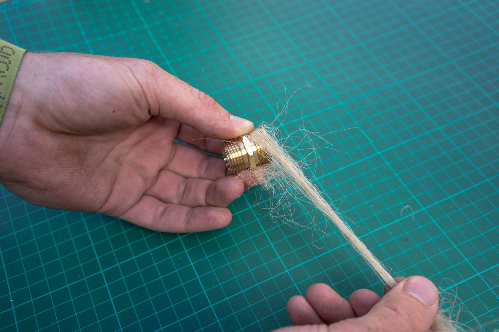

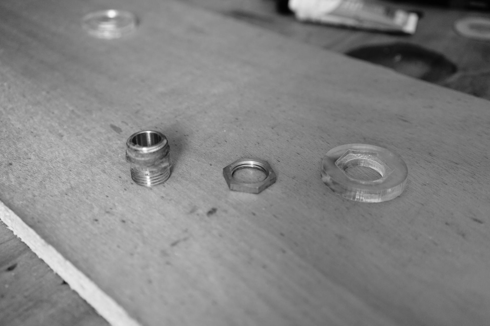

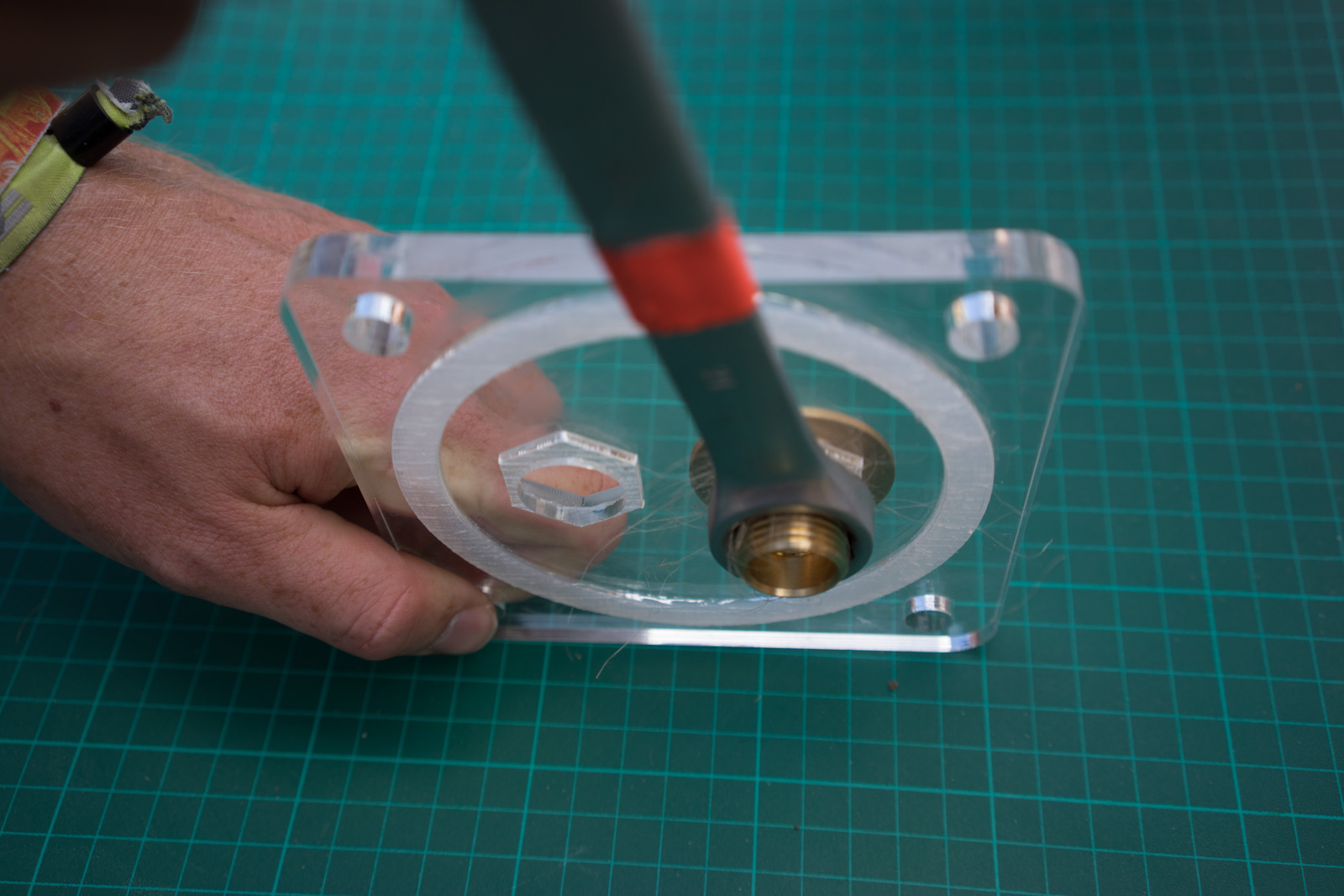

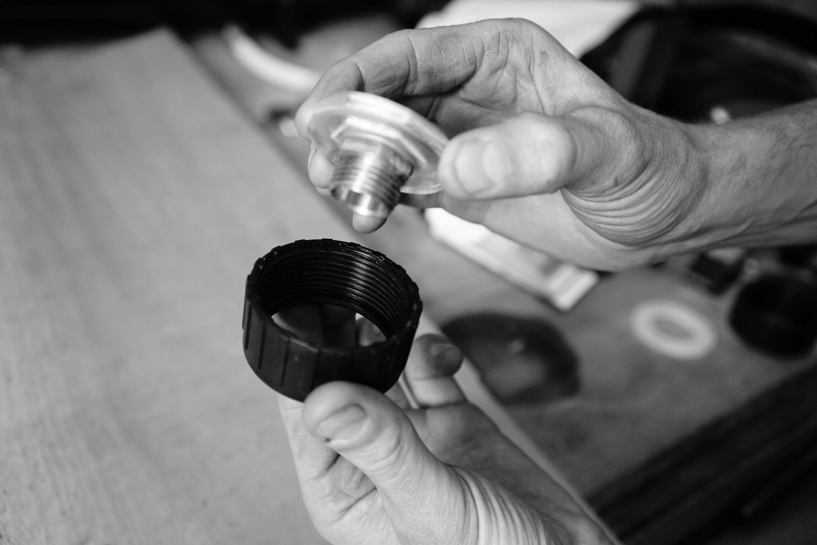

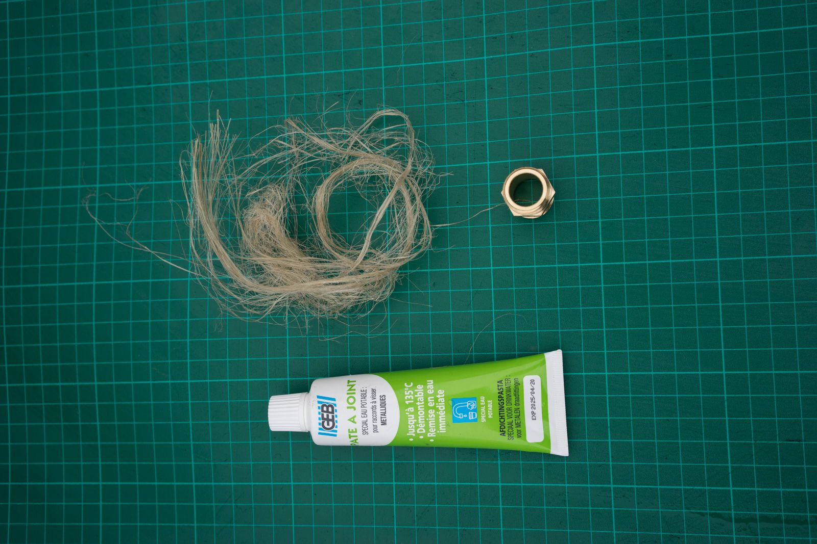

Just like with the flow regulator, slot the hexnut into the groove in the lid and screw in the brass male-male union (or male thread hose connector) on the flat outer side of the lid.
ABOVE: Filter lid, teflon tape, male-male union for copper pipes and hex/lock nut.
Use hemp fibre and mineral oil or a lot of teflon tape around the union and hex or + use silicone to seal the thing for good.
Do this for both lids. Go back a step for more detailed instructions.

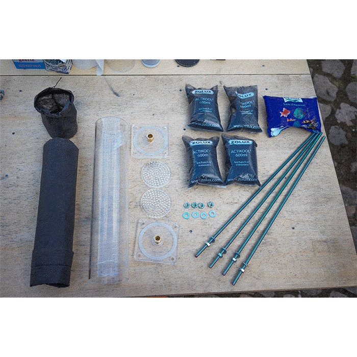

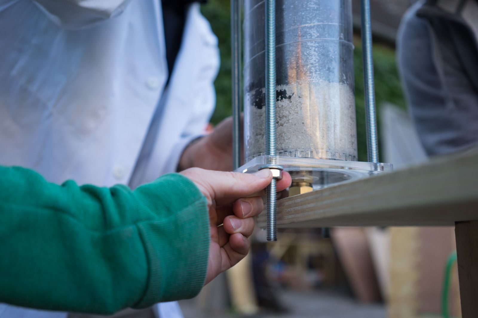

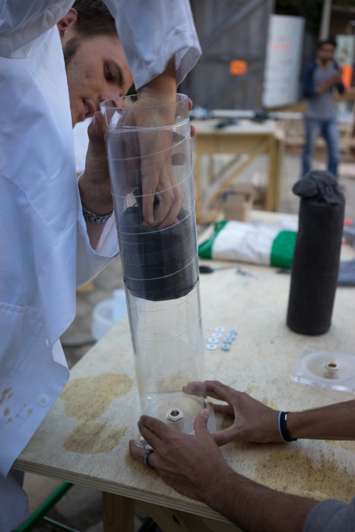

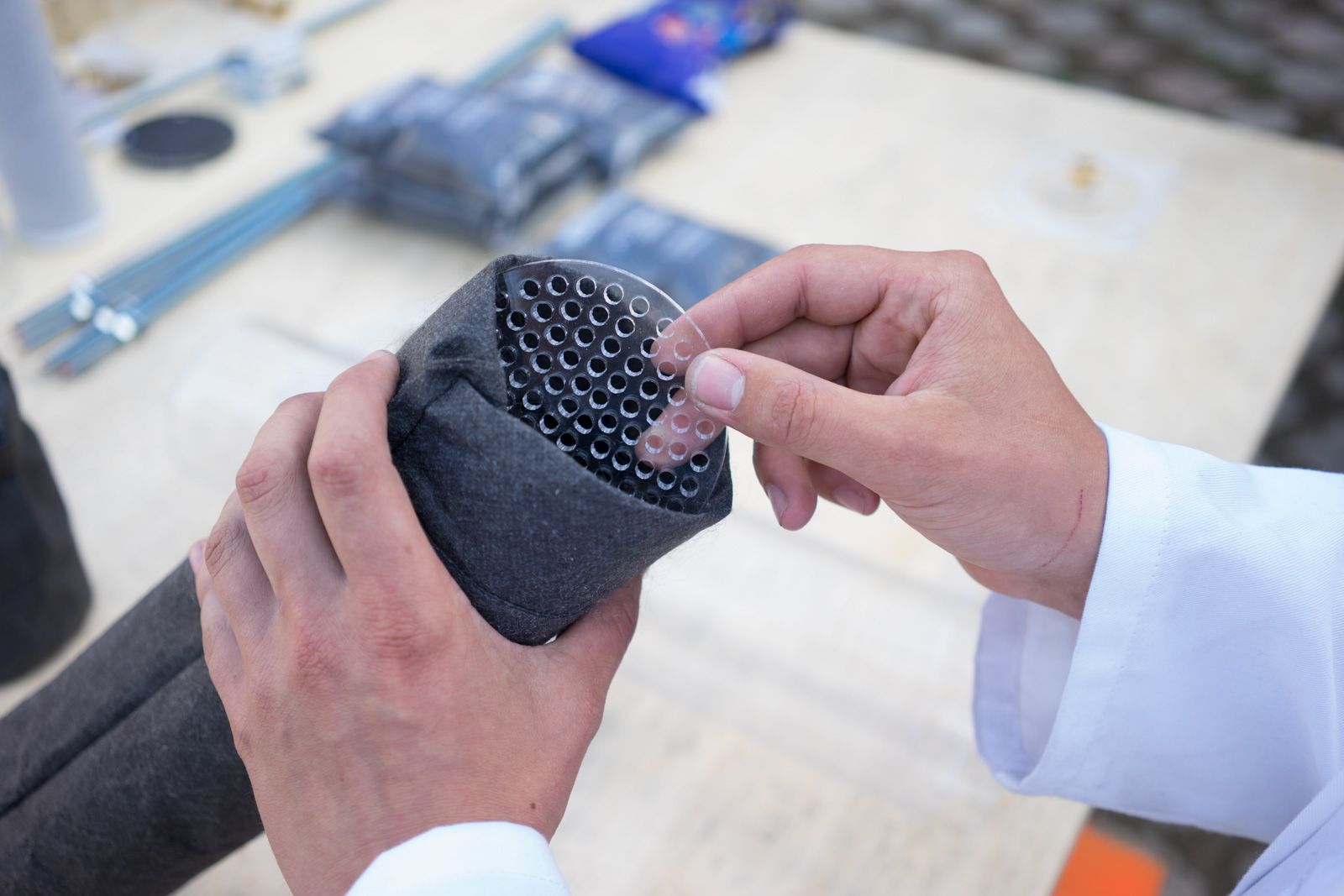

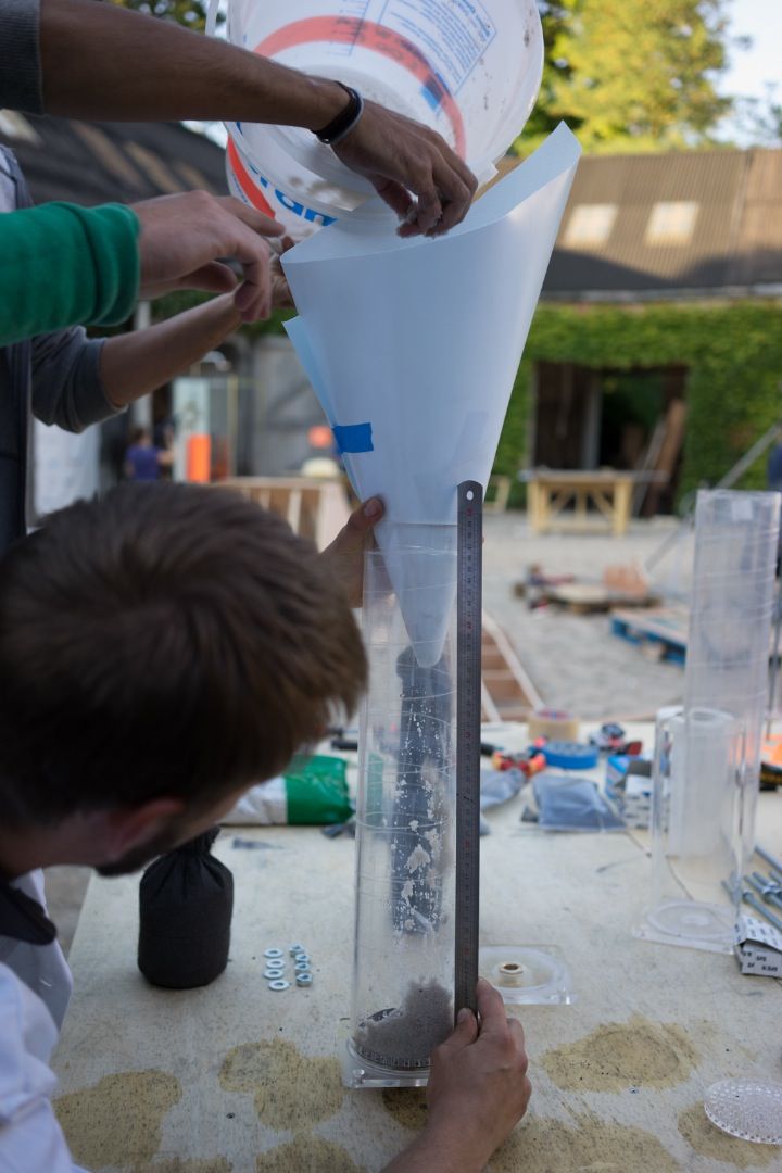

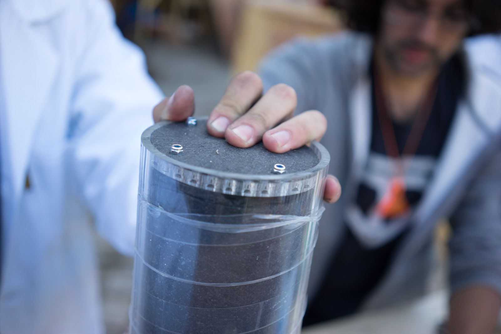

Place the bottom lid on a flat surface and add the 50cm pipe on top. Clamp it to the table or have someone help you.
Insert the left over acrylic 'coins' from the laser cutting into the bottom lid (maybe glue them in). It's best to have two people for this step or use a clamp to hold the filter in place while adding the filtrates.
Insert compression disk 1 with the fabric piece on the bottom so it swoops up and covers the corners of the inner lid - this makes a tight seal, or use water proof nuts and bolts like in the images above (M3 or M4).
Sand filter with compression disk, activated carbon bag in the background.
Pour in 10 cm of washed quartz sand either into the sand bag or just straight into the filter. Level it out. Insert compression disk 2 and squeeze it in to the pipe. Pour in 40 cm of activated carbon, either into the activated carbon bag or just straight into the filter. Level it out. Insert compression disk 3 with the larger fabric piece on the bottom so it swoops up and covers the corners of the inner lid. Squeeze it in. The level of the compression disk should be above the pipe at this point, if it's not, add more activated carbon.
Insert left over acrylic coins into the top lid (maybe glue them in) like you did for the bottom add the top lid add mounting disks to the top and bottom (same as with the flow regulators). Place threaded rods through all the corner holes.
Attach washers. Make sure everything is aligned together. Adjust the rods to the desired height and screw/wind in the nuts. Use the corner of a table/ worktop for tightening the bottom nuts. Compress the top and bottom lids together using a spanner or monkey wrench to tighten the nuts. You need to fasten both nuts while tightening or the rod will just keep spinning around Apply a little bit of lateral pressure on the threaded rod (squeeze it towards the filter housing) while tightening. If you did it correctly, the lid should now be water tight with hex nuts on the inside of the filter, the filtrate inside and the connector bits / hose connectors on the outside. If the filter housing leaks when pumping water through the filter; the nuts need to be tightened more. If it still leaks check the alignment of the lids and the gaskets. Don't tighten it too much or you'll likely crack the lid.

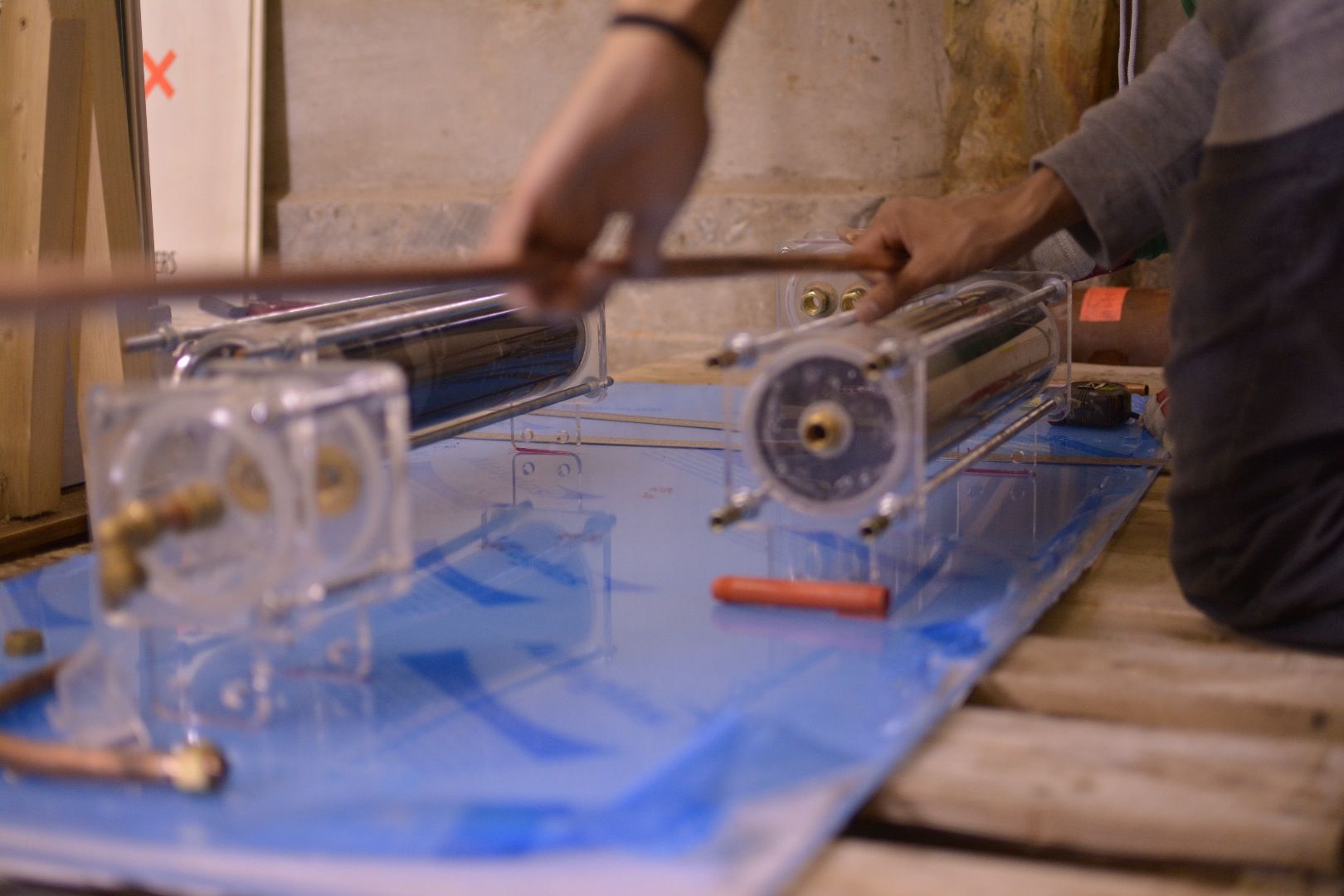

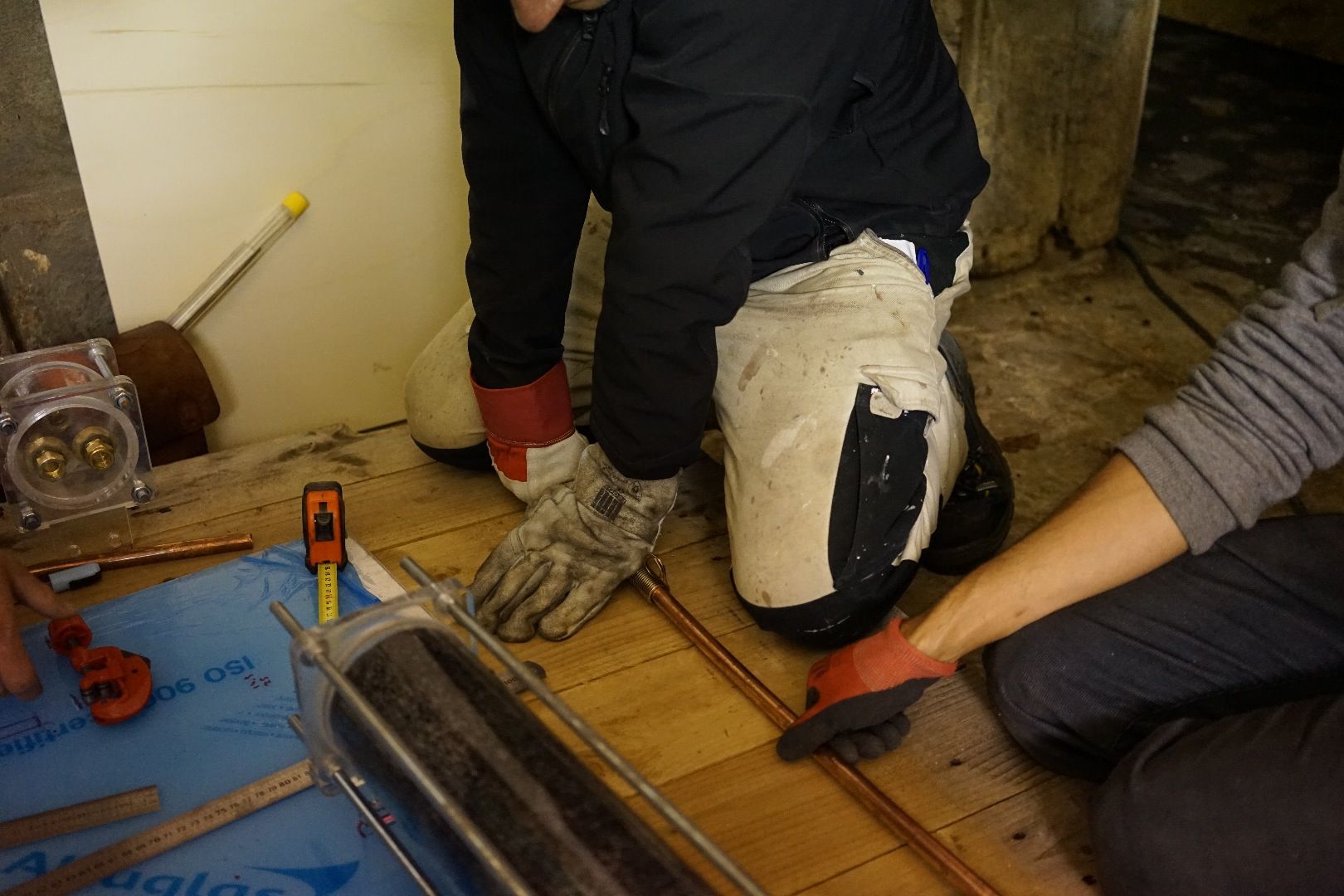

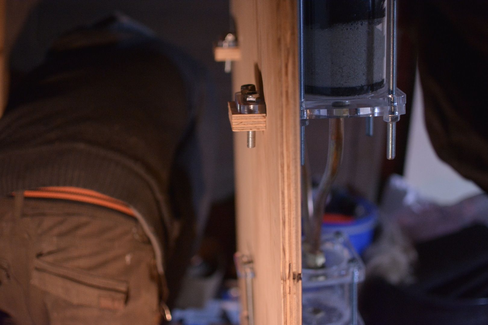

Step 9: Connecting the Piping? -> Mounting the Filters to the Wall.
*This part varies a lot depending on your build*
I accidentally broke the back panel of the shower stall and quickly built a new one with plywood that was routered to fit the frame of the shower stall. This mishap allowed for access to the back which is not very common and so modifications will be required for this step.

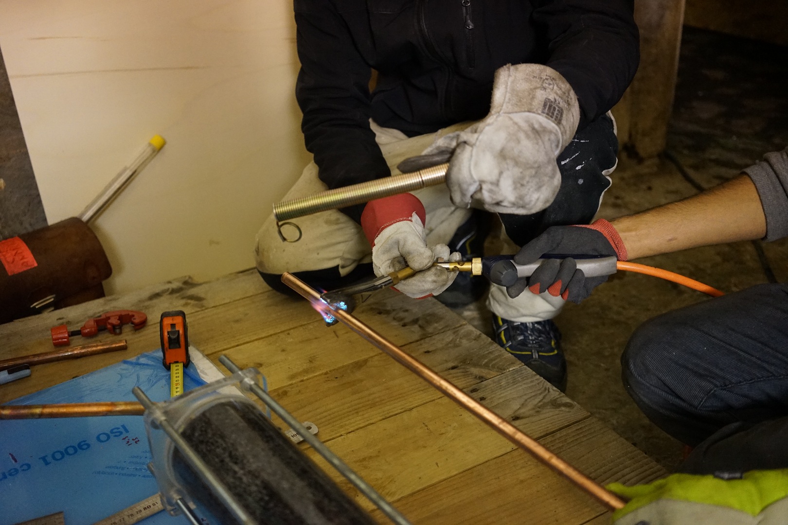

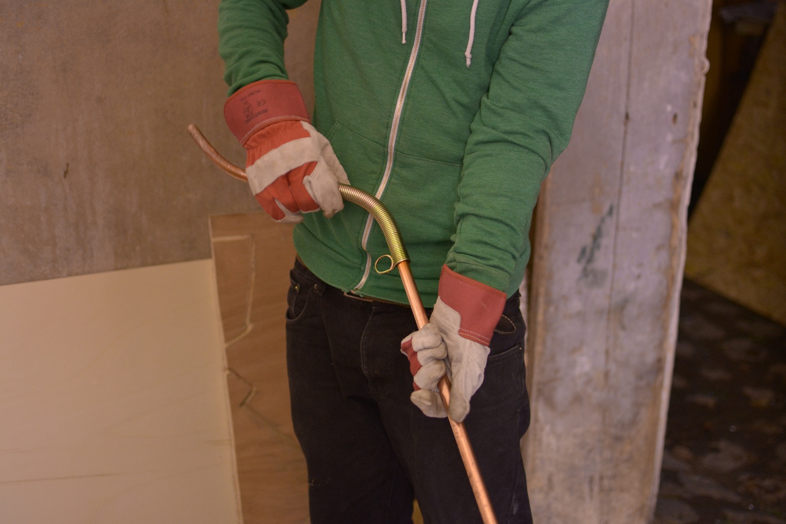

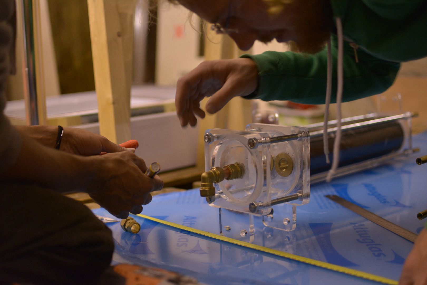

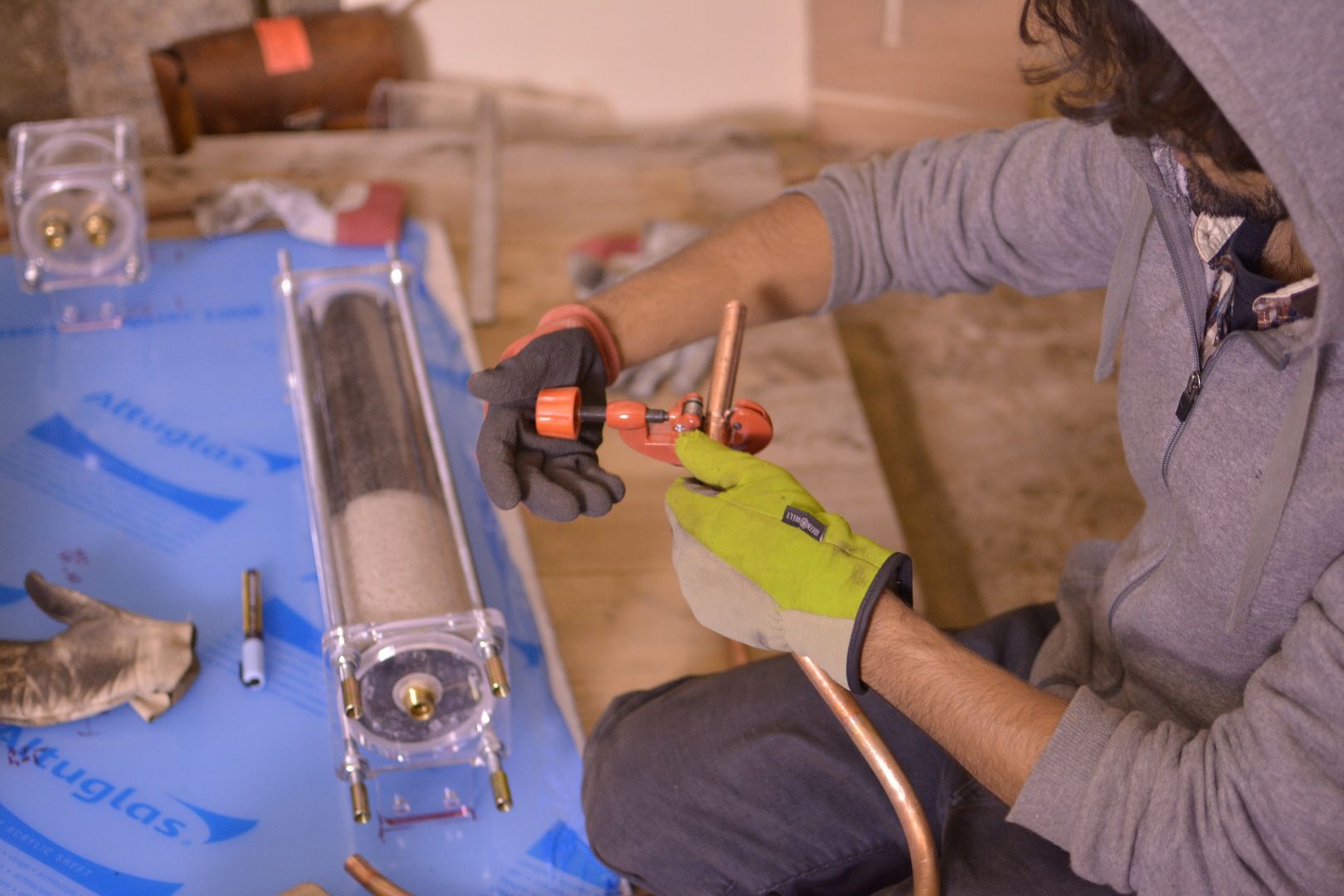

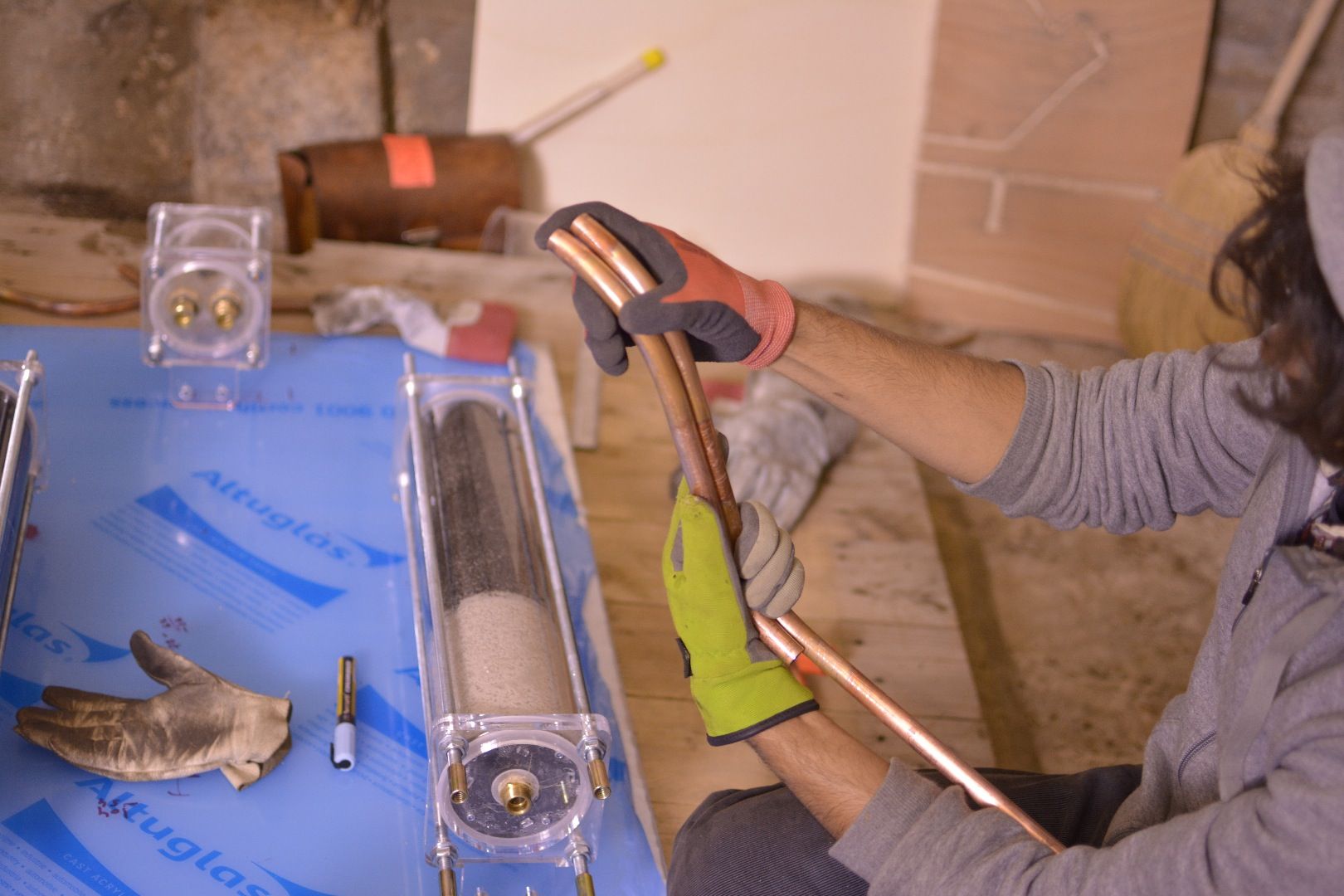

Bend copper pipes or just connect the hose
Basics - heat up your copper pipe with a blowtorch. Focus the flame on the areas above and below where you will do the bending so that part doesn’t get hotter and thus weaker than the rest of the steel. Once the copper turns blackish and starts making a cool psychedelic rainbow effect you know the copper is warm enough to begin bending. Turn off the flame and wait a moment. Once the pipe has cooled a little use the pipe bending tool so make an appropriate bend. This is more craft than technical skill and you just have to observe and see how the metal flexes. Don’t put too much pressure on one spot, this may result in a distorted pipe. You want to keep the diameter of the inner pipe as even as possible. Use a pipe bending tool.
+ hose connector Using rubber hose [or PEX] it is much easier than copper but perhaps it won’t look as cool. Transparent tube isn’t too bad but the most common material is PVC (which is kind of nasty). The best and perhaps easiest option is to use drinking water hose (16mm?). The hose connection is simple, use a hose nipple instead of the threaded connector and fasten the hose with a ring clamp. Make sure it’s really right. For really easy access you can you quick release/ quick connectors that allow you to connect and disconnect individual components without twisting the tubes around. These are usually used with garden hoses and are available as plastic or metal pieces. There's a diagram of how to do this with hose earlier on.

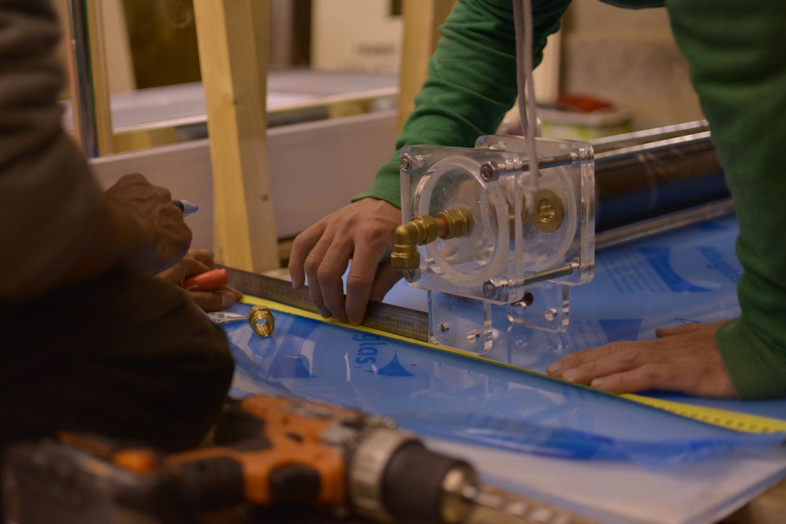

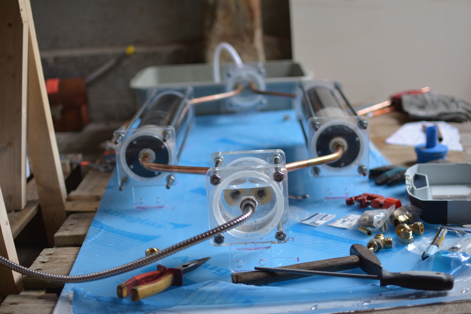

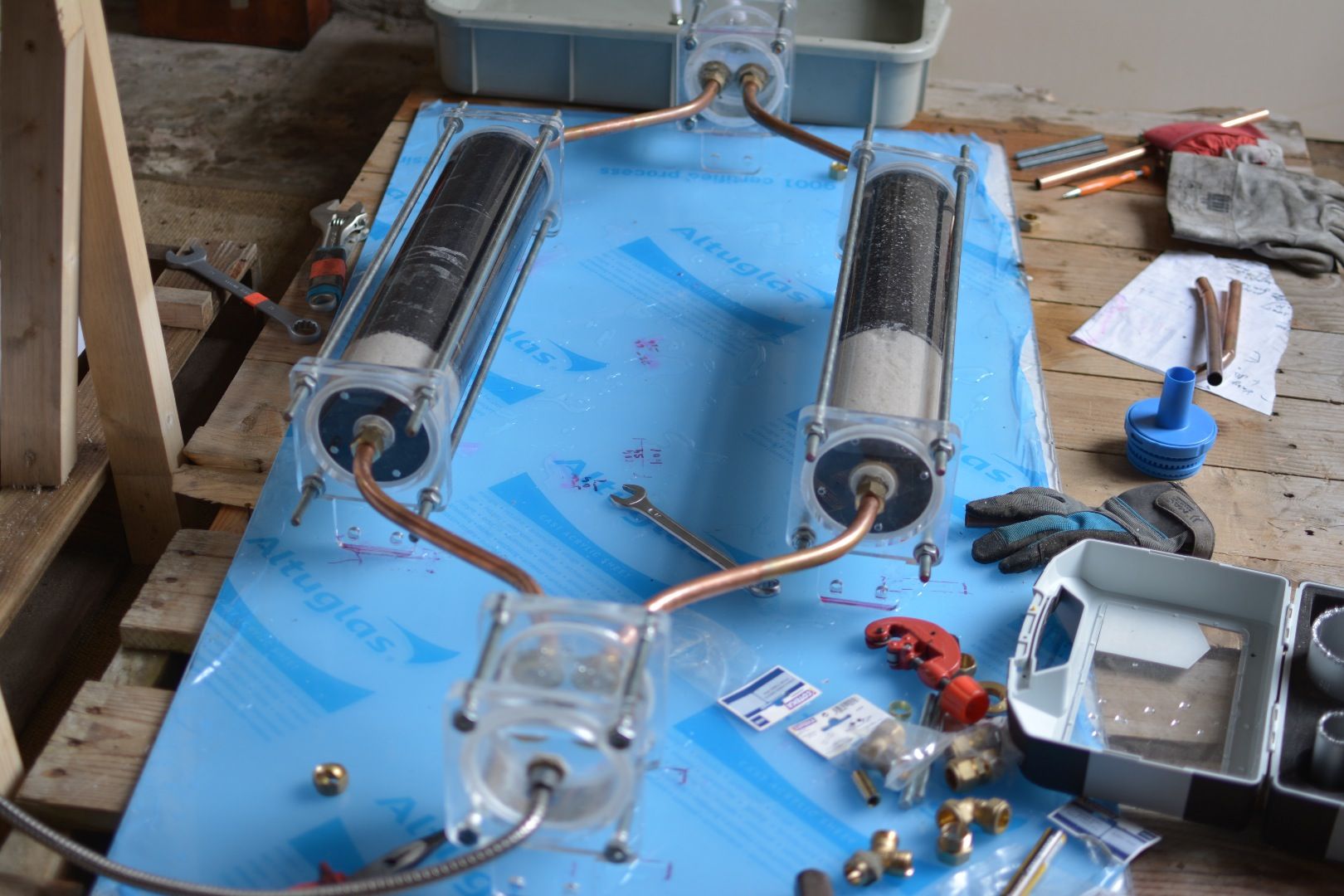

Lay out all the filter components onto a surface. Using common sense and a ruler you can centre everything perfectly.
Once you're happy with the positions bend the pipe accordingly.
To help cut the pipe you can use a pipe cutting tool but the cheap ones get dull really quickly.
Finally ready to test the filters by attaching a shower hose to the input and output of the flow regulators.
There's a short stop motion I'm having trouble embedding linked here: https://www.facebook.com/showerloop/videos/1703777059842454/

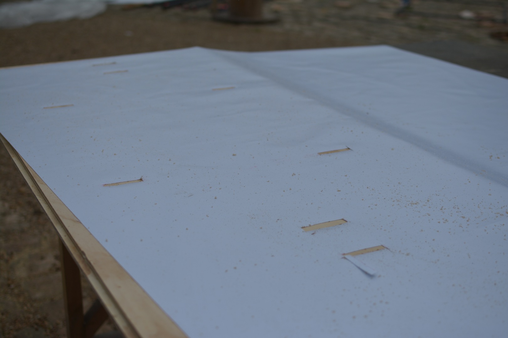

The placement of the filters was drawn onto a waterproof material and holes cut where the mount plates go through.
The mount plates can be bent by 90 degrees which would allow for the filters to be hung directly into the wall. To bend acrylic you need a special device that's basically a heated up wire that weakend specifically the bend point. Once it's warm enough you can just bend it by hand and into the shape you want (it's good to have a template that you can push up against). Let it cool and it will harden into shape. It may be prudent to space the holes in such a way that they screw in between tiles as drilling into tiles without cracking them can be tricky. If you have a basic cement wall you are good to go. Alternatively the threaded rod can be extended all the way from the ground to the roof and fastened with tension (pushing up and down) or simple legs or L-bends can be made so that they can be screwed into the roof and or floor. Or just attach the metal rods used to compress the filter directly to the wall.

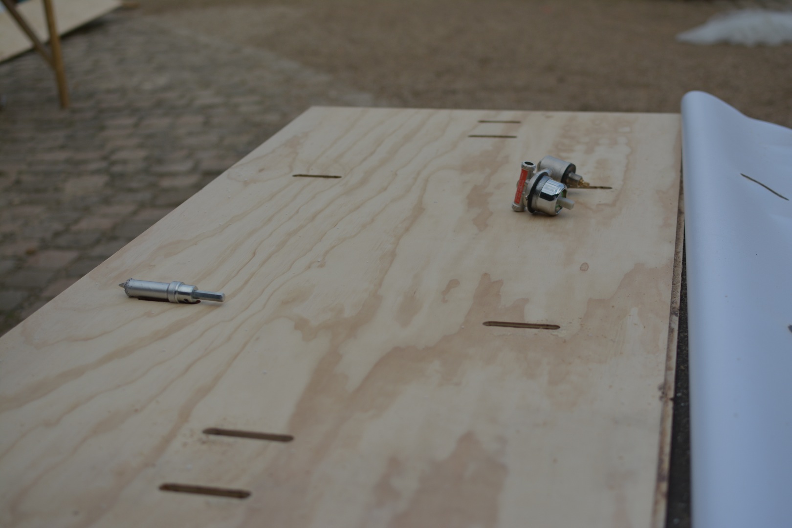

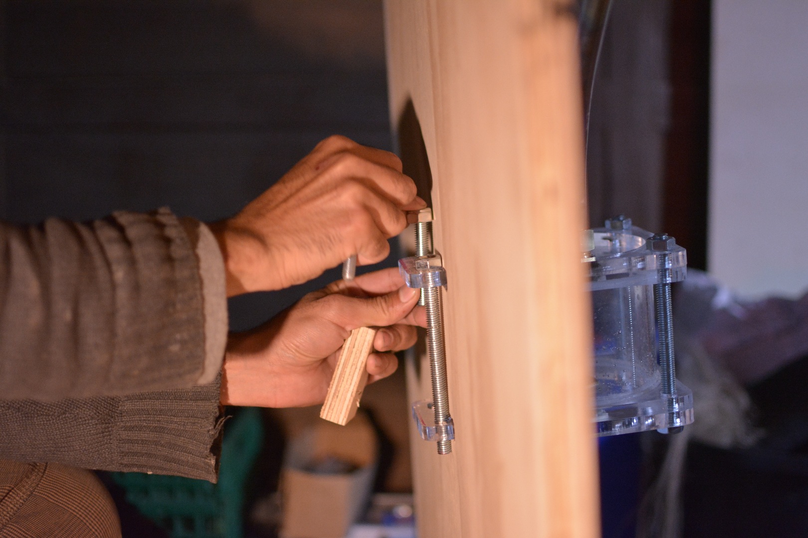

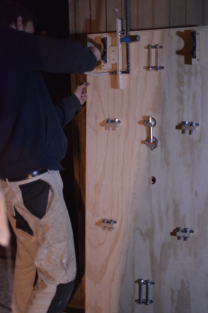

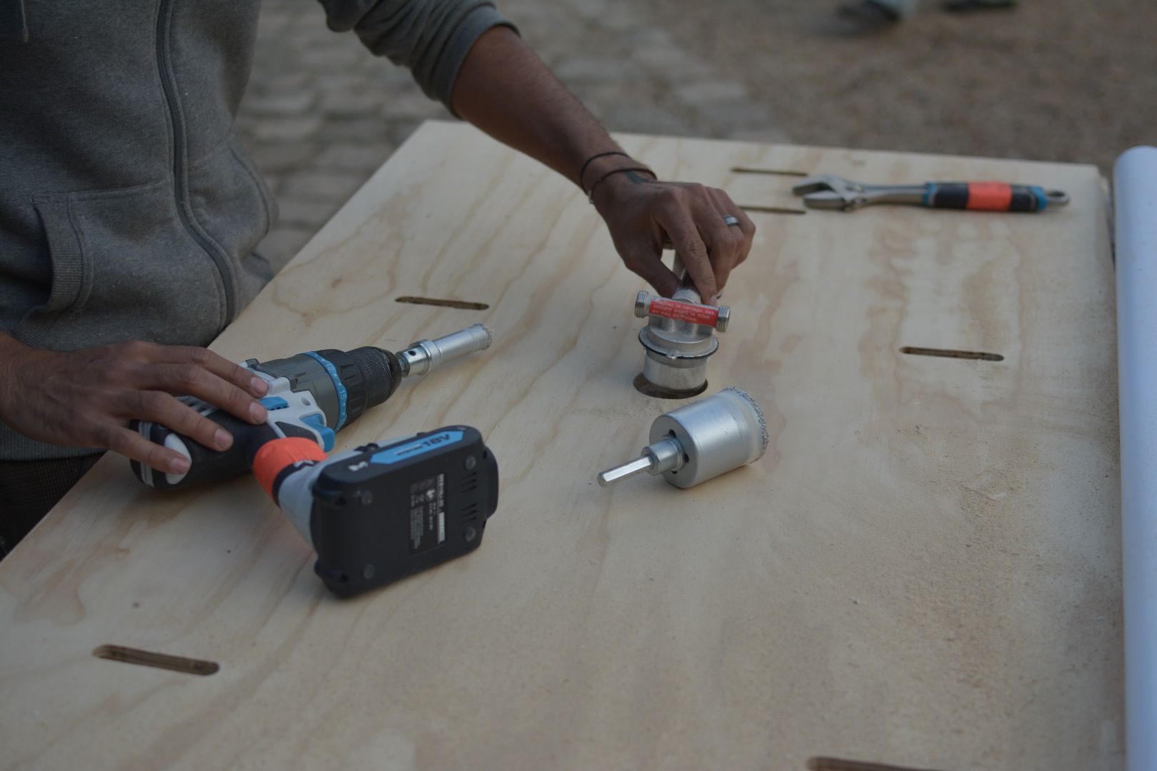

Step 10: Make the Backplate

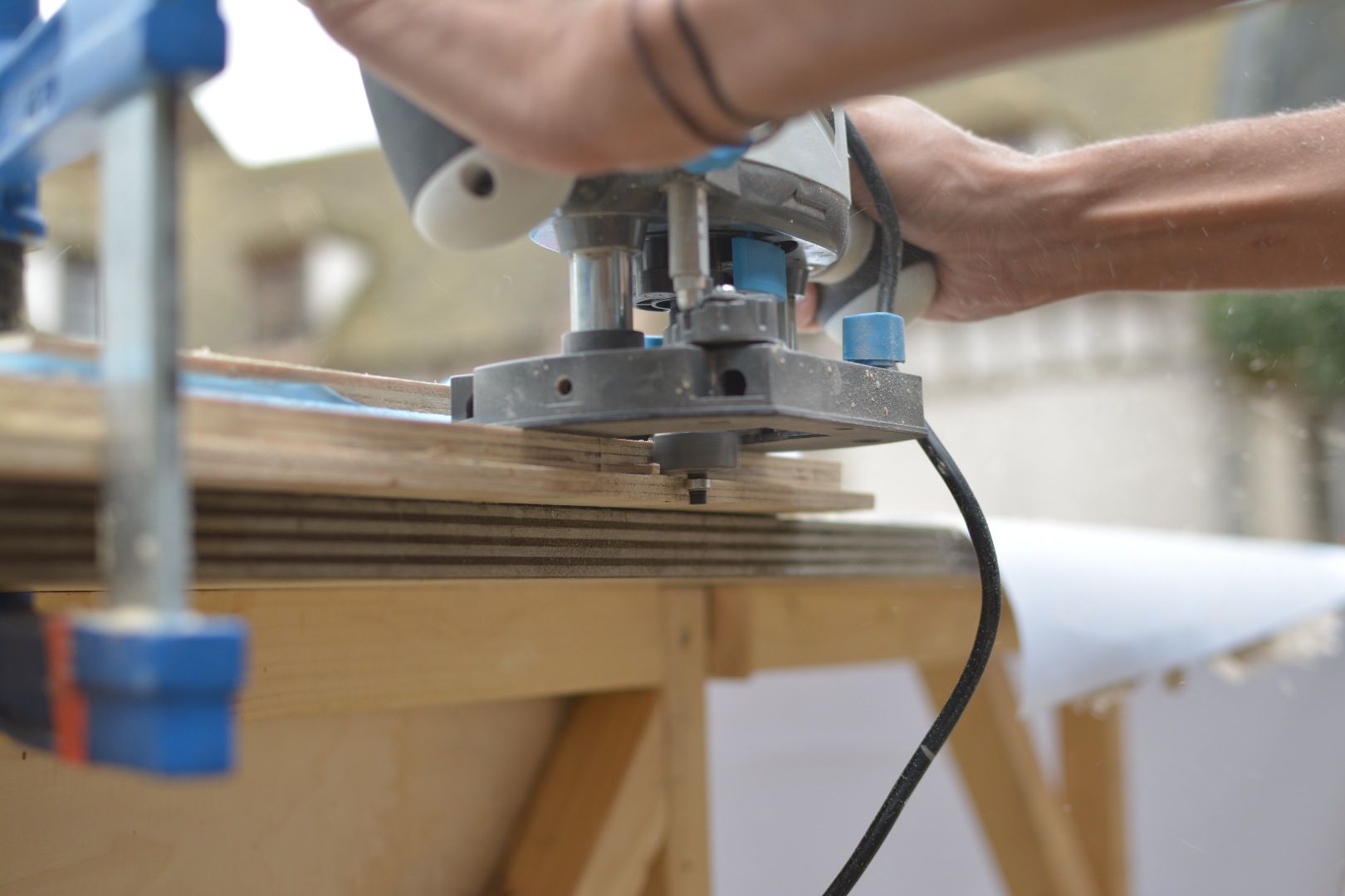

To fit inside the existing frame I had to bevel my 20mm plywood to half way. By clamping a straight piece of material onto the edge I could simply push against it with the router while moving laterally to get a clean and straight cut.
Lay out the cut lines on top of the plywood (and clamp/tap it down)
Use a circle saw to cut the holes for the hot/cold water mixer.
Missing from the step is how the water proof membrane was attached to the 'wet' wall. Ideally some kind of glue would make the most sense.
Insert the mount plates through the wall and using bolts or cut threaded rod, washers and nuts fasten the mount plate/filter or regulator to the wall. The holes where a bit too far out for the mount plates so there was too big of a gap to just use nuts to hold everything tightly together, so some 20mm plywood was cut and holes attached (in the same positions as the mount plates) to get a tight fit between the mount plate, plywood and wall.
Here's a picture of Timm and the back wall in it's entirety. The black semi-circles are something that came with the UV-lamp which let's us mount it easily. Normally this would be on the inside of the shower but this version was so big it couldn't fit inside the shower horizontally. While smaller UV lamps of 20W should be sufficient for 10l/min the numbers seem to vary from supplier to supplier and I would lean on the side of caution. A cool set up could be to have a small UV pre filter and after the filter whereby the pre filter UV may be good enough to reduce or stop bacterial growth inside the filter all together which does occur even in drinking water filters, but the type of bacteria isn't harmful. In either case this is what the post-filter UV is for, to make sure that there are no negative effects.

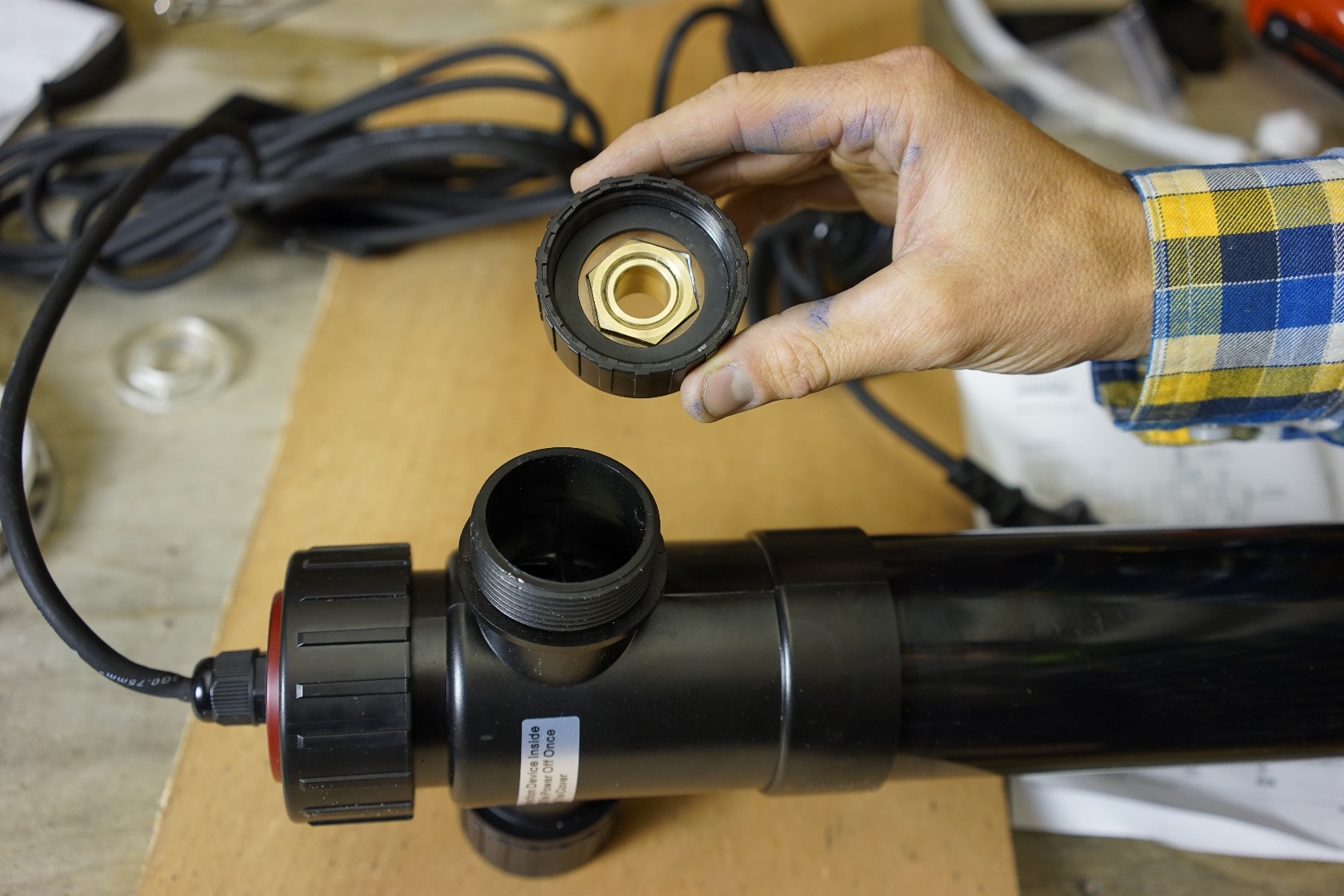

Step 11: Assemble the UV

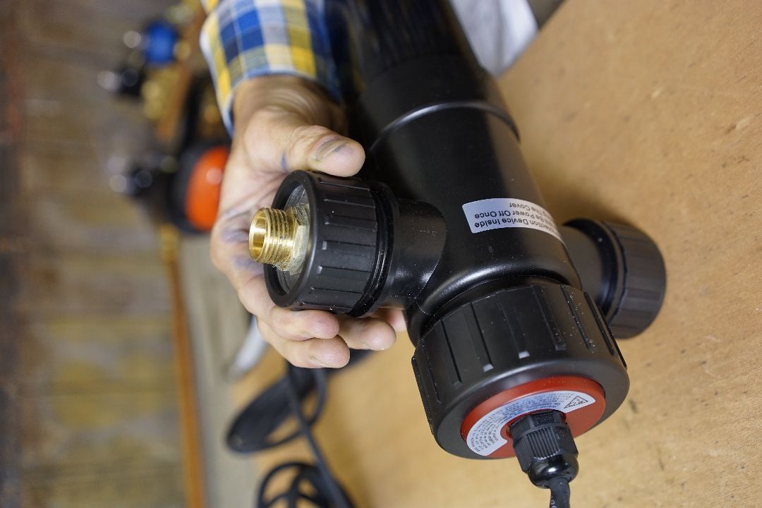

The UV lamp comes with it's own 'ice-cream' cone shaped hose connectors, but generally they are for 1" or larger hoses and it extends out too far to look cool so it's nicer to make a custom cap which reduces the form factor.
You should have laser cut the cap from the previous step. It can be seen in the picture on the right, next to the lock nut and brass union.
! the cap should actually be made from something that's UVC resistant as Acrylic will allow for the transmission of harmful UV rays. PTFE is one option and the same material that the teflon tape is made from as is PVC (but you shouldn't vaporize it/laser cut it because it's harmful to your health to breathe and so don't let it into the environment either). A very simple solution would just be to coat it in several layers of white paint containing titanium dioxide which is basically where the pigment comes from. Do this for both the inner and out layer to ensure good protection. Machining this component into rustproof steel like alumnium or die casting may be the best solution in the long run. Remember the UVC is on a non visible spectrum so be practical whenever dealing with UV light.
More information and links on the bottom of the page.

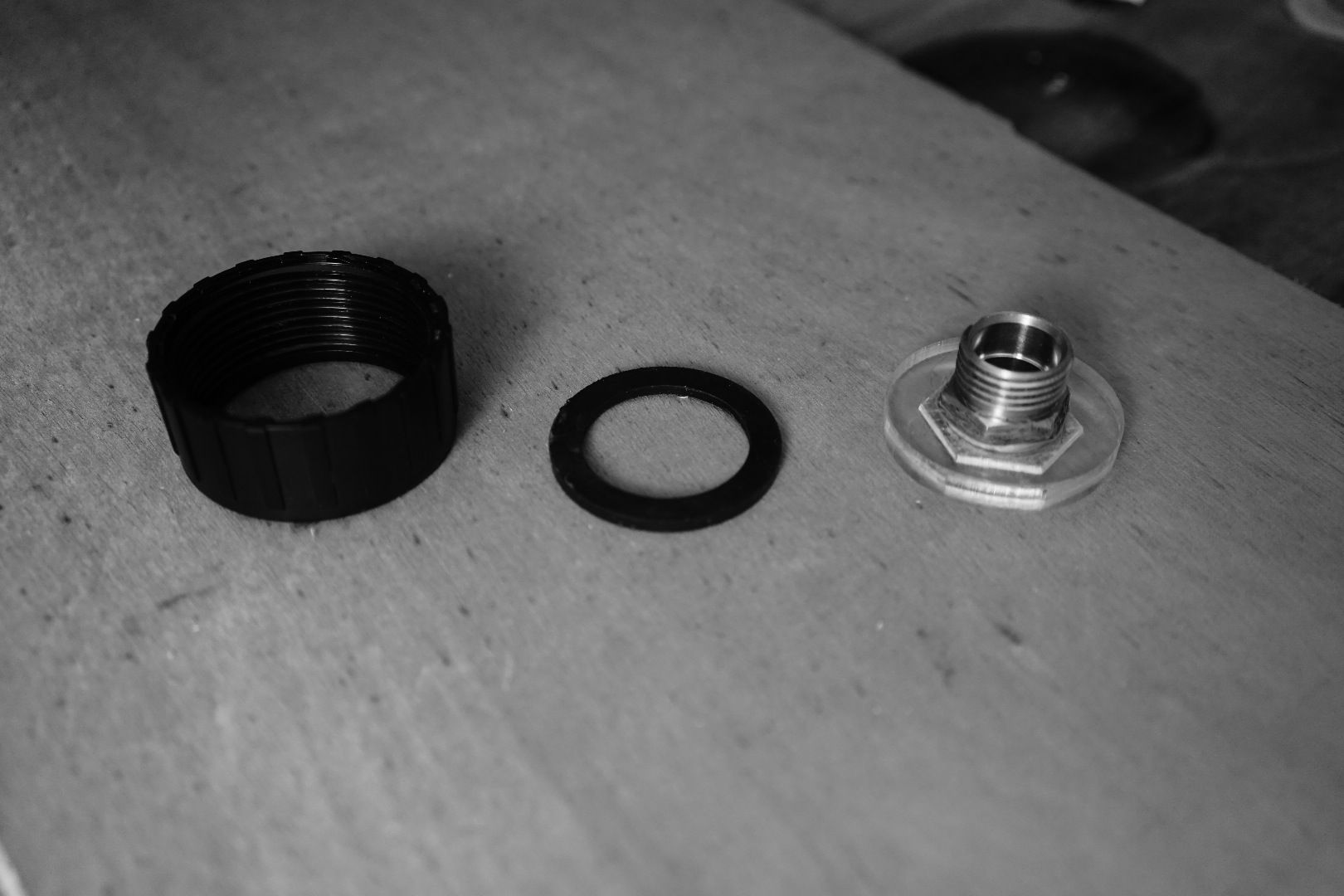

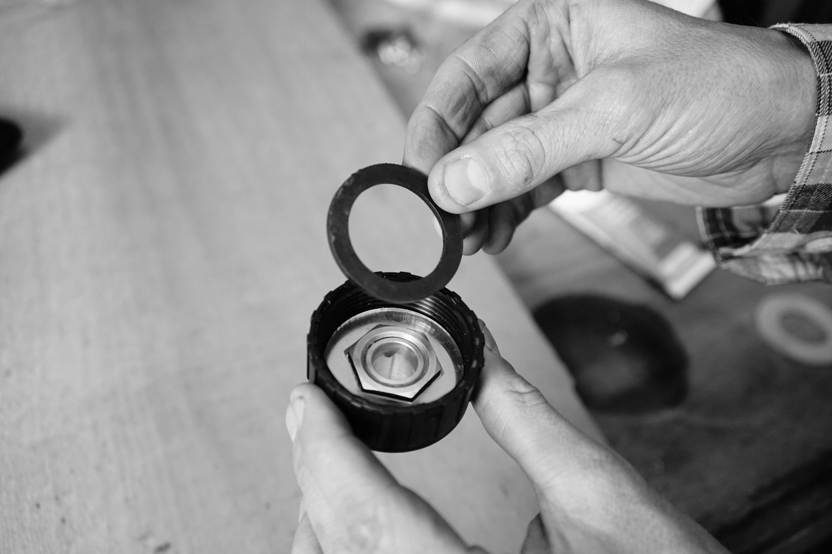

Place the lock nut inside the UV cap. Use teflon tape or hemp fibre with some mineral oil and place it inside the UV cap.
Place the brass union inside while holding in the lock nut. Use a spanner and possibly clamp to fasten the union to the locknut.
Place the UV cap inside the threaded hose connector lid and add the gasket to the inner side that comes into contact with the UV lamp.
Tighten and you're good to go. Add a desired hose connector to the threaded union to connect the UV to the shower head.
