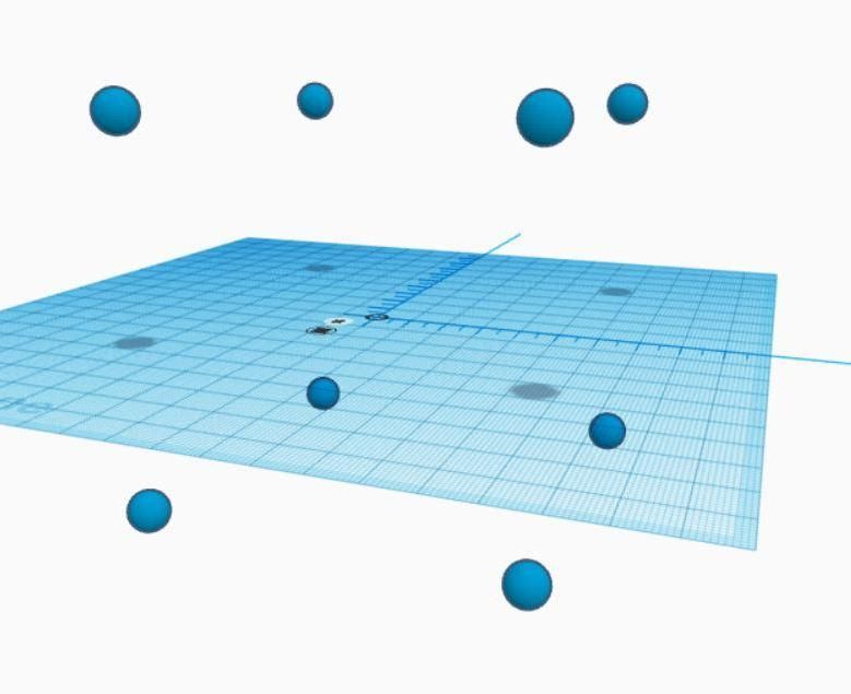

While they are drying you can 3D print the jig I made for drilling the holes for the rod. I have attached the stl file and you can also find it on Thingiverse. I used HTPLA and it held up pretty good to the heat of the drill. If you don't have access to a 3D printer I would recommend making some kind of jig so all the holes line up perfect with each other. In addition, drilling the tiles with a drill press is a much easier endeavor . A drill press vice is also recommended to hold the pieces while drilling. The jig works great, as long as you put the pieces in the right way. Yep, I learned that lesson the hard way also. The jig is a little tight and it can be a little difficult to get the tiles out of the jig. I need a jig for the jig!
