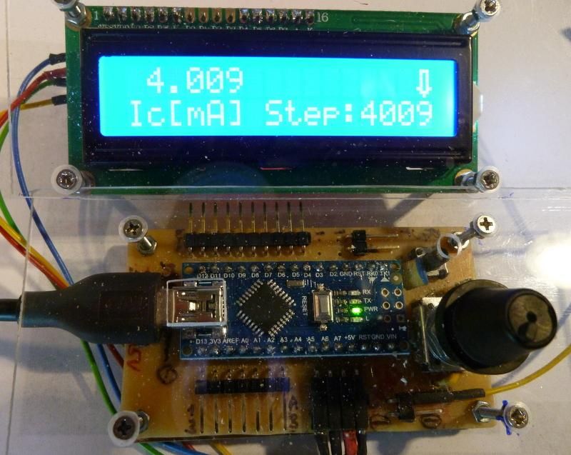

Step 3: Using a Two-Line LCD
mausi_mick has redesigned the circuit to use a 2-line LCD and a rotary encoder instead of the OLED and pushbuttons. This Step describes his design. You can see a video of it here.
He has used a LCD1602 with an I2C interface piggyback board (approx £5 total). They are a simple way of connecting a LCD1602 to an Arduino and require only three of the Arduino's pins.
Alternatively, you could use a plain LCD1602 (£2.50) which requires 6 Arduino pins. Here's an Instructable.
He uses a rotary encoder which makes setting the menus much quicker. Turning or clicking the encoder triggers a "Pin-Change-Interrupt".
The menu has two new functions:
  • Changing frequency ( Low and High) from 0 ... 12 MHz
  • Changing delay (from 100µs,200µs,500µs,1ms...1s) (sweep-mode).
The signal gererator currently is powered from a USB-supply but he intends to change that to a Li-ion battery with a boost convertor to give 5V (using a MT3608 SMPS). USB supplies have a lot of noise so the battery will improve the quality of the signal. Of course, a boost convertor might also create noise. Personally, I'd use 4 AA cells or two Li cells and no booster.
The sketch can be downloaded below. A KiCAD PCB layout is available of his GitHub page.
