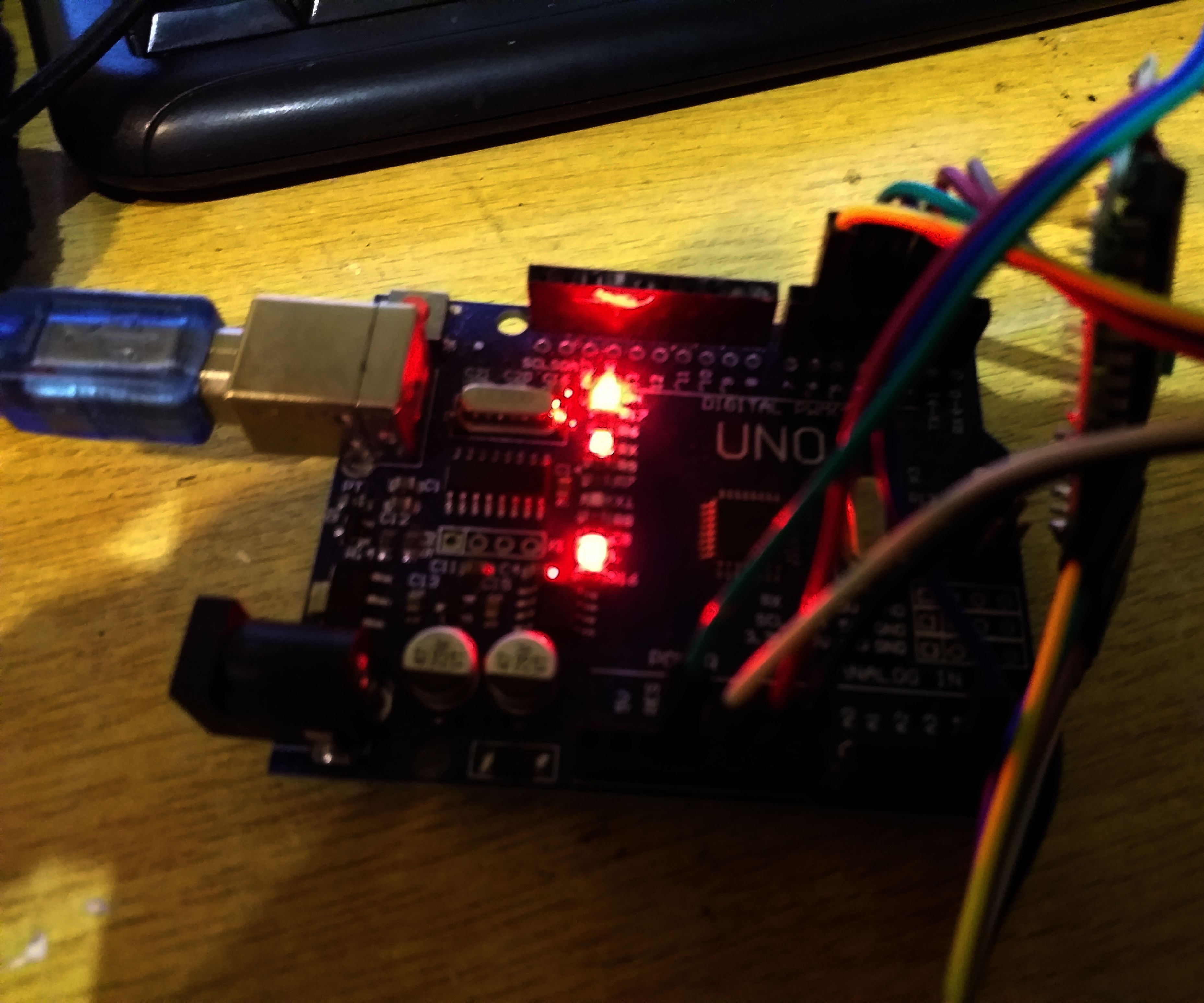

Step 2: Universal Infrared Receiver
Our universal IR receiver has a filter to receive only Infrared light and can really be used with any IR transmitter as all IR light signals will be detected by the IR receiver. A basic IR remote will send 8 hexadecimal digits, encoded in binary as IR light. Our IR receiver simply needs to decode this message and react on it. To make life simple, there is a great IR library available that will take care of actually receiving & decoding messages so that you can simply read the result as a set of hexadecimal values. The IR library is available here https://www.arduinolibraries.info/libraries/i-rremote
To know what messages are actually being sent by a specific IR remote control we simply load the basic IR sketch to dump any signals it receives to the serial port for us to visually inspect. By systematically pressing every key on the remote and saving the value that is received we can easily match signals received with physical buttons on the remote, and then react appropriately as required for that specific button.
Step 3: Arduino Robot Programming
Next up it is time to code the logic of the robot to act as traditional RC Car by responding to only 4 commands, namely Forward, Backward, Left and Right and, use this information to drive the 2 motors.
By pressing Up or Down we will move Forward and Backward respectively. Instead of making this complicated by adding variable acceleration to the robot we will simply crank up the power to both motors to the max. The downside of this is that there will be a big jump in current being drawn from the power source as the motors attempt to instantaneously reach the required speed. To avoid this surge in current usage a gradual climb to the required speed would be preferred. If your Arduino seems to reset at random times when just starting to move forward or backward then you are most likely drawing more current from your battery or power supply than it can provide and definitely need to use a gradual climb instead.
Because we do not want the robot to stutter around between waiting for signals from the remote control, we will give it a countdown time to keep on reacting to the last command given until the timer runs down to 0 or a new command is received.
Here is the full source code for a simple IR Remote Controlled Robot (RC Car). You may want to change the commands being responded to depending on your IR remote being used (as described above):
// Code By Leobot Electronics (https://leobot.net).
#include IRremote.h
// THESE ARE THE MOTOR PINS // Motor One int enA = 10; int in1 = 9; int in2 = 8; // Motor Two int enB = 5; int in3 = 7; int in4 = 6; // Remote Control IR Receiver Pin int RECV_PIN = 11; int count=0; bool state= 1; IRrecv irrecv(RECV_PIN); decode_results results; void setup() { Serial.begin(9600); // In case the interrupt driver crashes on setup, give a clue // to the user what's going on. //Serial.println("Enabling IRin"); irrecv.enableIRIn(); // Start the receiver // Serial.println("Enabled IRin"); pinMode(enA, OUTPUT); pinMode(enB, OUTPUT); pinMode(in1, OUTPUT); pinMode(in2, OUTPUT); pinMode(in3, OUTPUT); pinMode(in4, OUTPUT); pinMode(loutpin, OUTPUT); } enum EnumDirection { Stop, Up, Down, Left, Right }; EnumDirection currentDirection; int timeDown=0; int timerMax=100; void loop() { bool HasNewVal=false; EnumDirection nextDirection= currentDirection; count++; if(count>=1) { count=0; } if (irrecv.decode(&results)) { //Serial.println(results.value, HEX); irrecv.resume(); // Receive the next value if(results.value==0xFF18E7) { HasNewVal=true; nextDirection= EnumDirection::Up; // Serial.println("up"); } if(results.value==0xFF4AB5) { HasNewVal=true; nextDirection= EnumDirection::Down; // Serial.println("down"); } if(results.value==0xFF10EF) { HasNewVal=true; nextDirection= EnumDirection::Left; // Serial.println("left"); } if(results.value==0xFF5AA5) { HasNewVal=true; nextDirection= EnumDirection::Right; // Serial.println("right"); } if(results.value==0xFFFFFFFF) { HasNewVal=true; // Serial.println("redo last"); } if(results.value==0xFF38C7) { HasNewVal=true; nextDirection= EnumDirection::Stop; // Serial.println("stop"); } } if(HasNewVal) { currentDirection=nextDirection; timeDown=timerMax; } if(timeDown>0) { timeDown--; } if(timeDown>0) { //drive if(nextDirection== EnumDirection::Stop) { StopAll(); } if(nextDirection== EnumDirection::Up) { DriveForward(); } if(nextDirection== EnumDirection::Down) { DriveBackward(); } if(nextDirection== EnumDirection::Left) { DriveLeft(); } if(nextDirection== EnumDirection::Right) { DriveRight(); } } if(timeDown==0) { //turn off StopAll(); } delay(100); } byte speedx=200; void DriveForward() { // turn on motor A digitalWrite(in1, LOW); digitalWrite(in2, HIGH); // set speed to x out of possible range 0~255 analogWrite(enA, speedx); // turn on motor B digitalWrite(in3, LOW); digitalWrite(in4, HIGH); // set speed to x out of possible range 0~255 analogWrite(enB, speedx); } void DriveRight() { // turn on motor A digitalWrite(in1, LOW); digitalWrite(in2, HIGH); // set speed to x out of possible range 0~255 analogWrite(enA, speedx); // turn on motor B digitalWrite(in3, LOW); digitalWrite(in4, HIGH); // set speed to x out of possible range 0~25 5 analogWrite(enB, (byte)speedx/10); } void DriveLeft() { // turn on motor A digitalWrite(in1, LOW); digitalWrite(in2, HIGH); // set speed to x out of possible range 0~255 analogWrite(enA, (byte)speedx/10); // turn on motor B digitalWrite(in3, LOW); digitalWrite(in4, HIGH); // set speed to x out of possible range 0~25 5 analogWrite(enB, speedx); } void DriveBackward() { // turn on motor A digitalWrite(in1, HIGH); digitalWrite(in2, LOW); // set speed to 200 out of possible range 0~255 analogWrite(enA, speedx); // turn on motor B digitalWrite(in3, HIGH); digitalWrite(in4, LOW); // set speed to 200 out of possible range 0~25 5 analogWrite(enB, speedx); } void StopAll() { digitalWrite(in1, LOW); digitalWrite(in2, LOW); digitalWrite(in3, LOW); digitalWrite(in4, LOW); }
