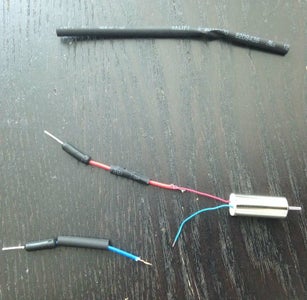

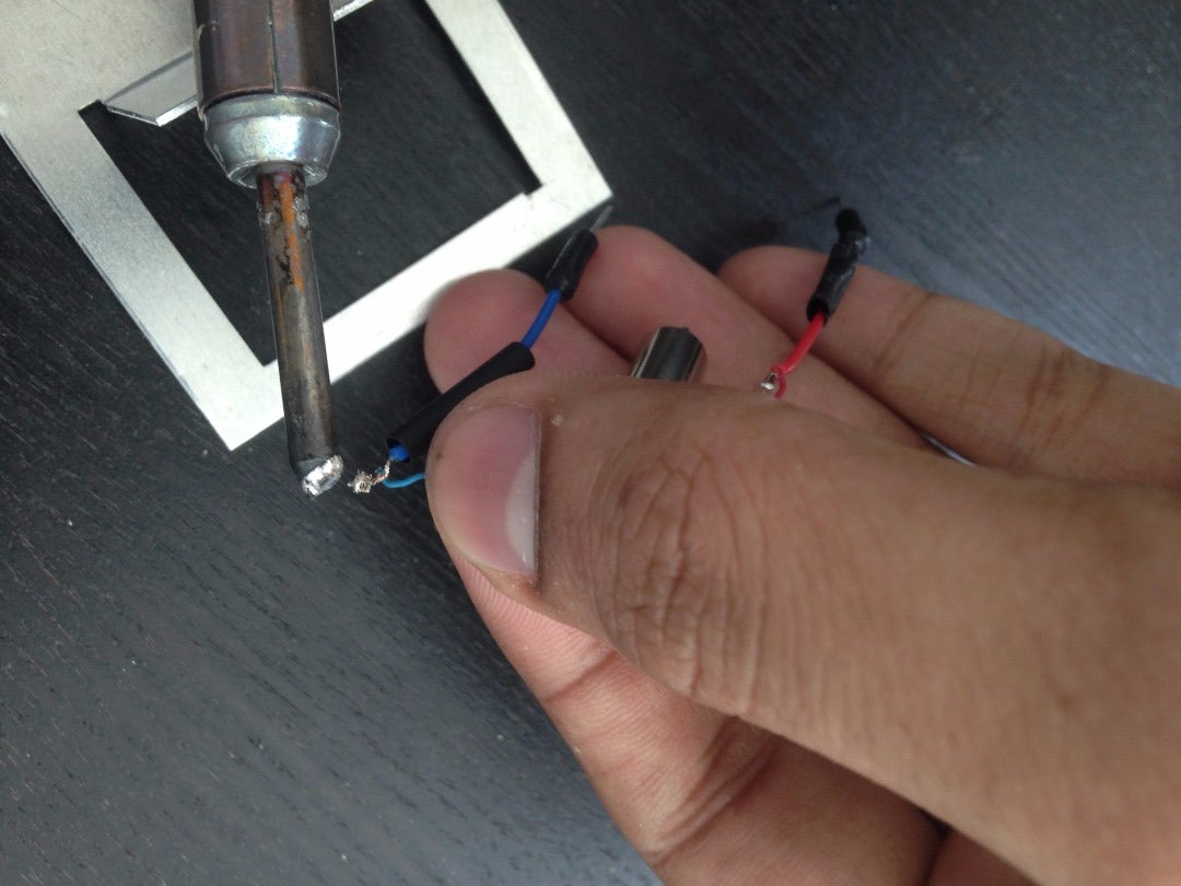

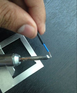

Step 2: Soldering the Motor to Breadboard Wire
Cut the breadboarding wire in half. And add a little solder to the wires to tin them
Now add the heat shrink and solder the wires to the motor

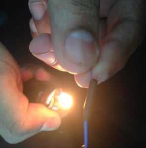

Once done use a heat source like a candle/lighter to shrink the tubing.

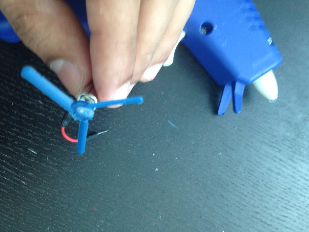

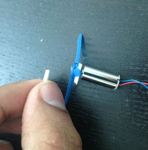

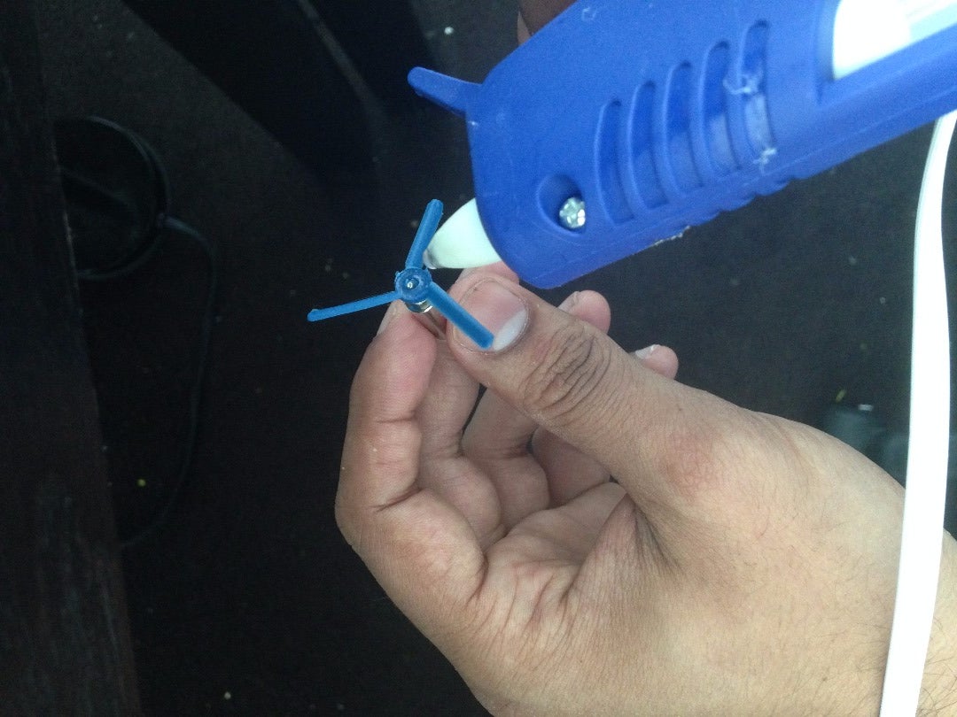

Step 3: Hotglue and Testing the Propeller With the Motor
Now add a small piece of foam or double side tape and attach the propeller.
Using hot glue,secure the propeller to the motor as shown in the picture above.
Connect the motor to lipo battery and give the motor a quick test as shown in the video above.

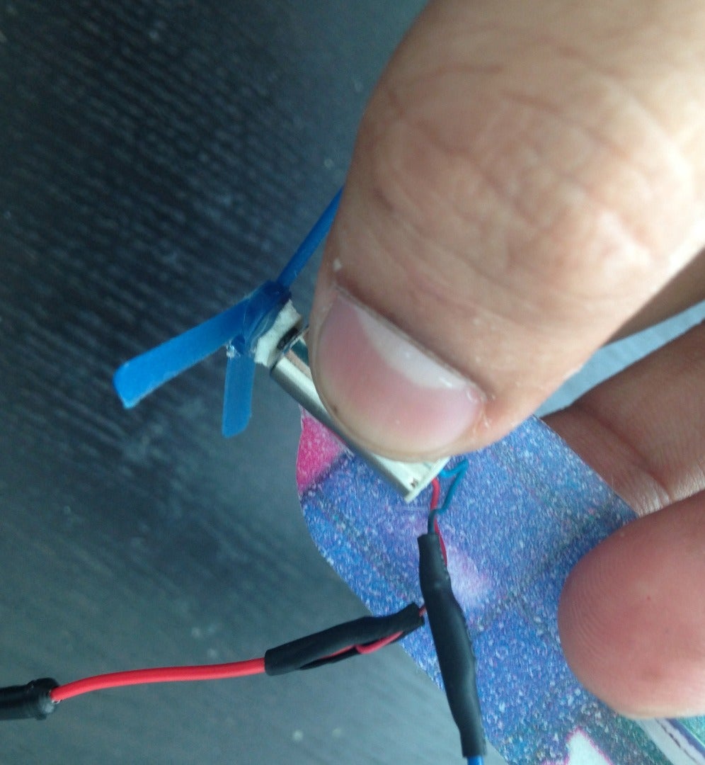

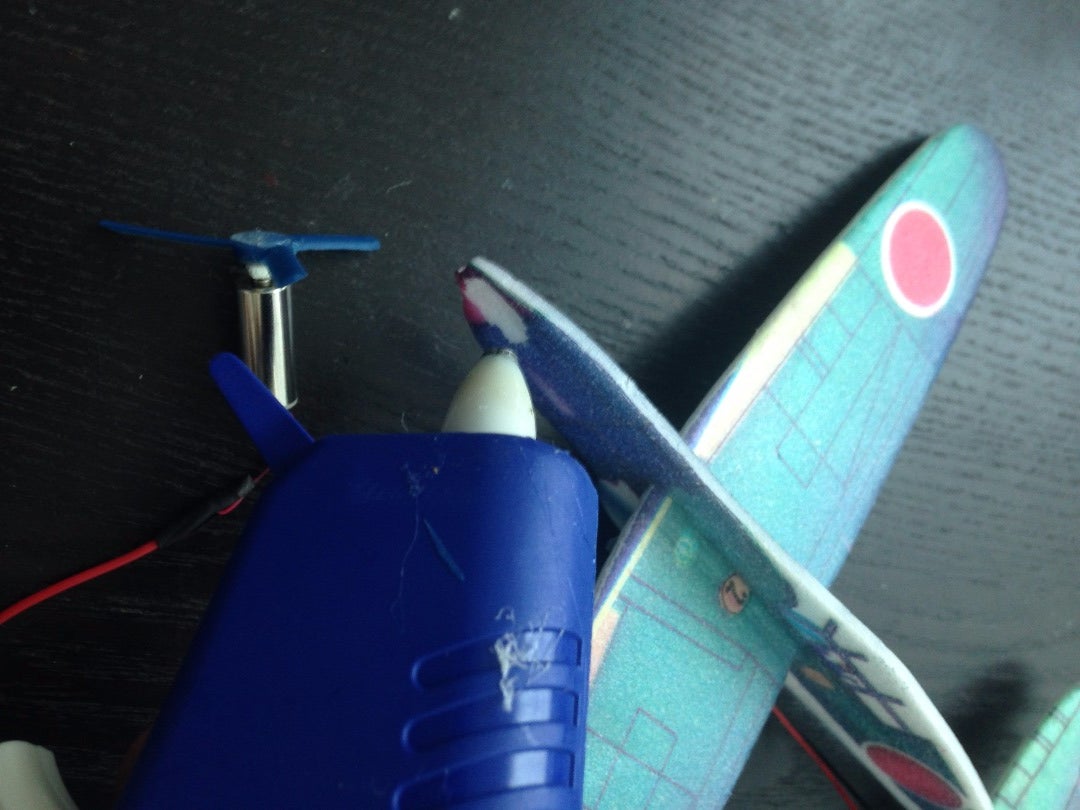

Step 4: Hot Glue the Motor to the Gilder Body
Once you've tested the motor with the Lipo , add the motor to the glider plane using hot glue.
Add a little bit of hot glue on the nose of the glider and then press and hold the motor for a couple of second.
Then to completely secure the glider add a ring of hot glue around the motor as shown in the third picture above.

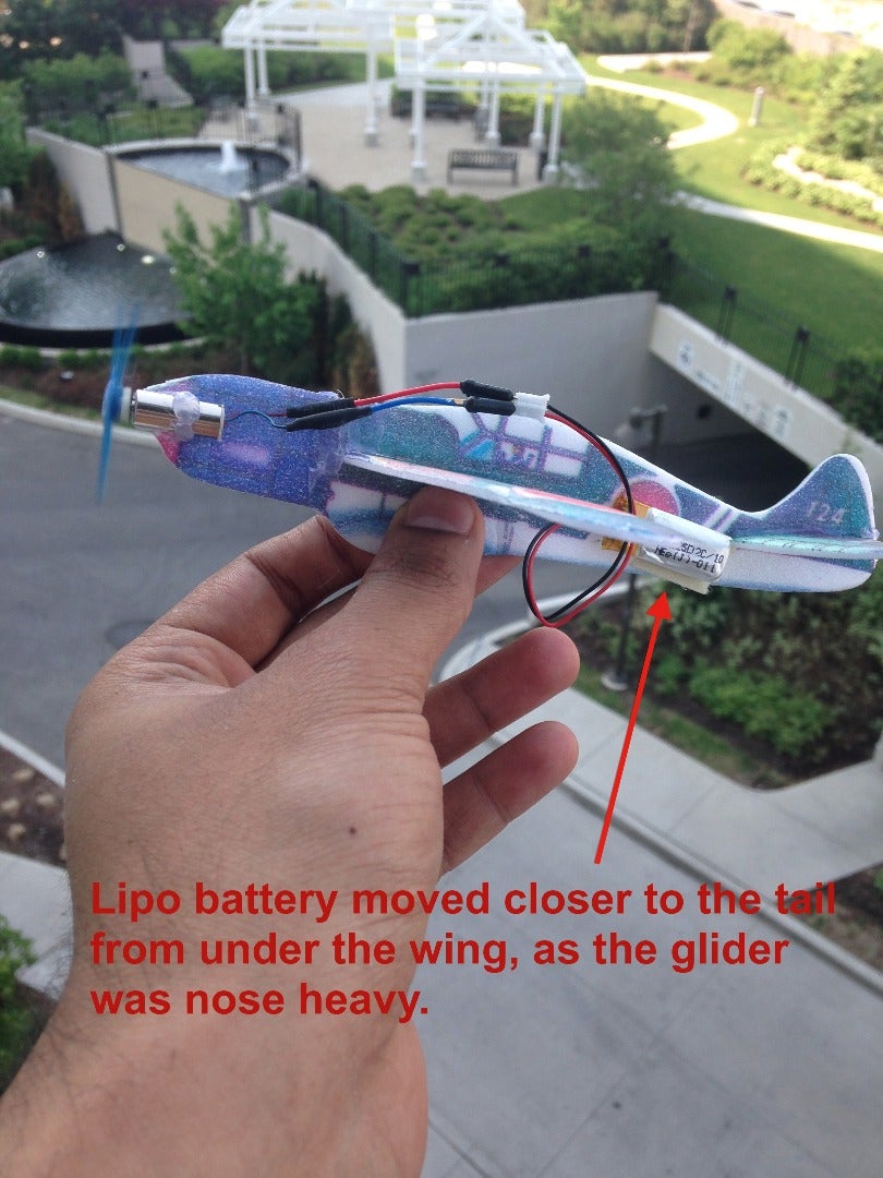

Step 5: Determining the Best Spot for the Battery
This is step could take a couple of flights/tries , so be patient !!
Here you'll have to move the Lipo battery around to prevent the glider from Nose heavy or Bottom heavy.
So before heading out to fly the glider to find the sweet spot for the lipo , carry a few pieces of double sided foam tape..
