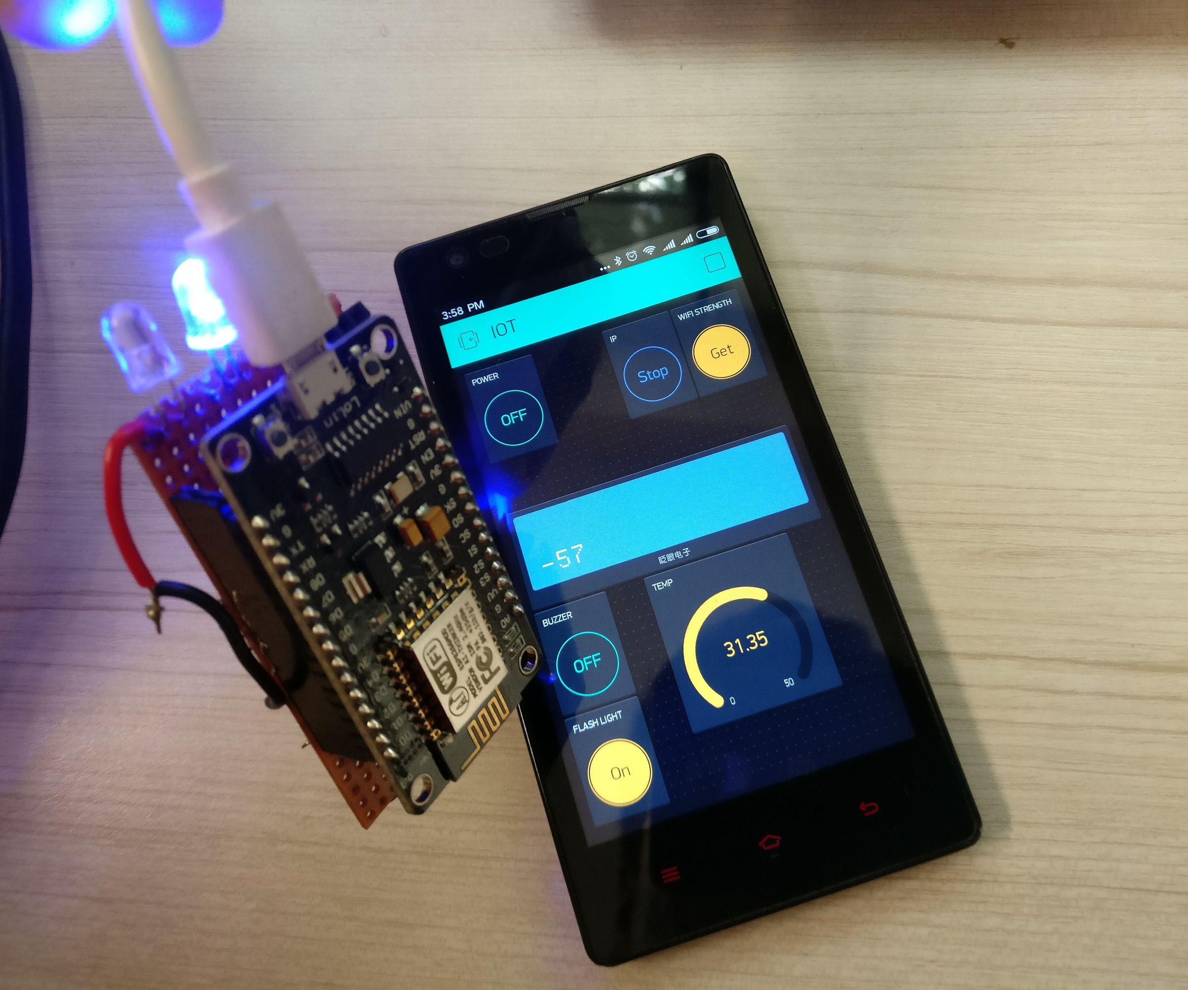

Step 5: Setting Up Blynk
1. First install the Blynk app from google play store and then sign in
2. After that Press on click on New Project and you will get a screen (Refer Screen shots)
*Enter the name of your project, I have given it as led
*Then Select the Board as ESP8266
and then you will see below the authentication token no. If you want it in your email you can send it through email also
*And then Finally click on to the create button
3. Now you will get your dashboard screen. Just click on the the top most button "+" on the right corner to add widgets to your project.
4. In this project we add a simple button and then configure its settings as Digital GP13 pin.(Refer Screen Shots)
5. Its your choice you can either have the button set as push type or as a switch
6. Then label the Button as ON and OFF in the settings
Note that since Blynk is free only to an extend, you have to choose your widgets wisely

Step 8: Final Execution
1. After uploading the code
2. Open the Blynk app in the Phone
3. Let it connect to the internet
4. Then you would see your dashboard with a button
5. Press Play button on the top most right corner of the app
6. Then Alas!! Press the Button and you would see the LED Turn ON!!!:)
