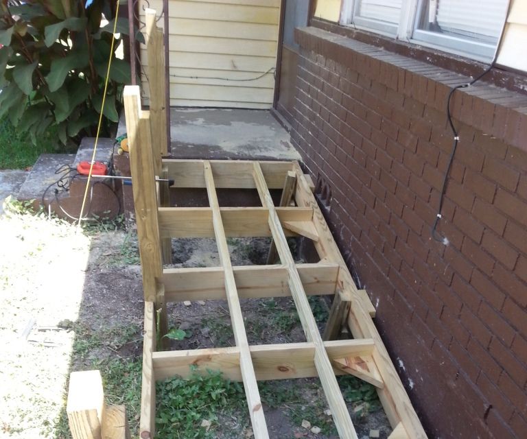

My parents wanted a gate that didn't touch the house & that the gardner could open from the outside & the inside as that the man they contracted to do it did a cheap job. So after a month of thinking, this is what I came up with
Single sided fence. On the top left is the gate the fence builder installed with the instructions to not touch the vinyl & it kind of worked opening from the inside, but not the outside
I installed the pipe onto it so it worked better, I used two different sizes of metal pipe where one fit into the other with a T connector & cut with a hack saw then used ultrablack (or a cheap RV sealant) to keep it in place & insure that it doesn't move under the metal straps.
But the key is making a strong box frame which makes the gate ridged and have a consistant way to stop instead of dragging on the ground sometimes.
