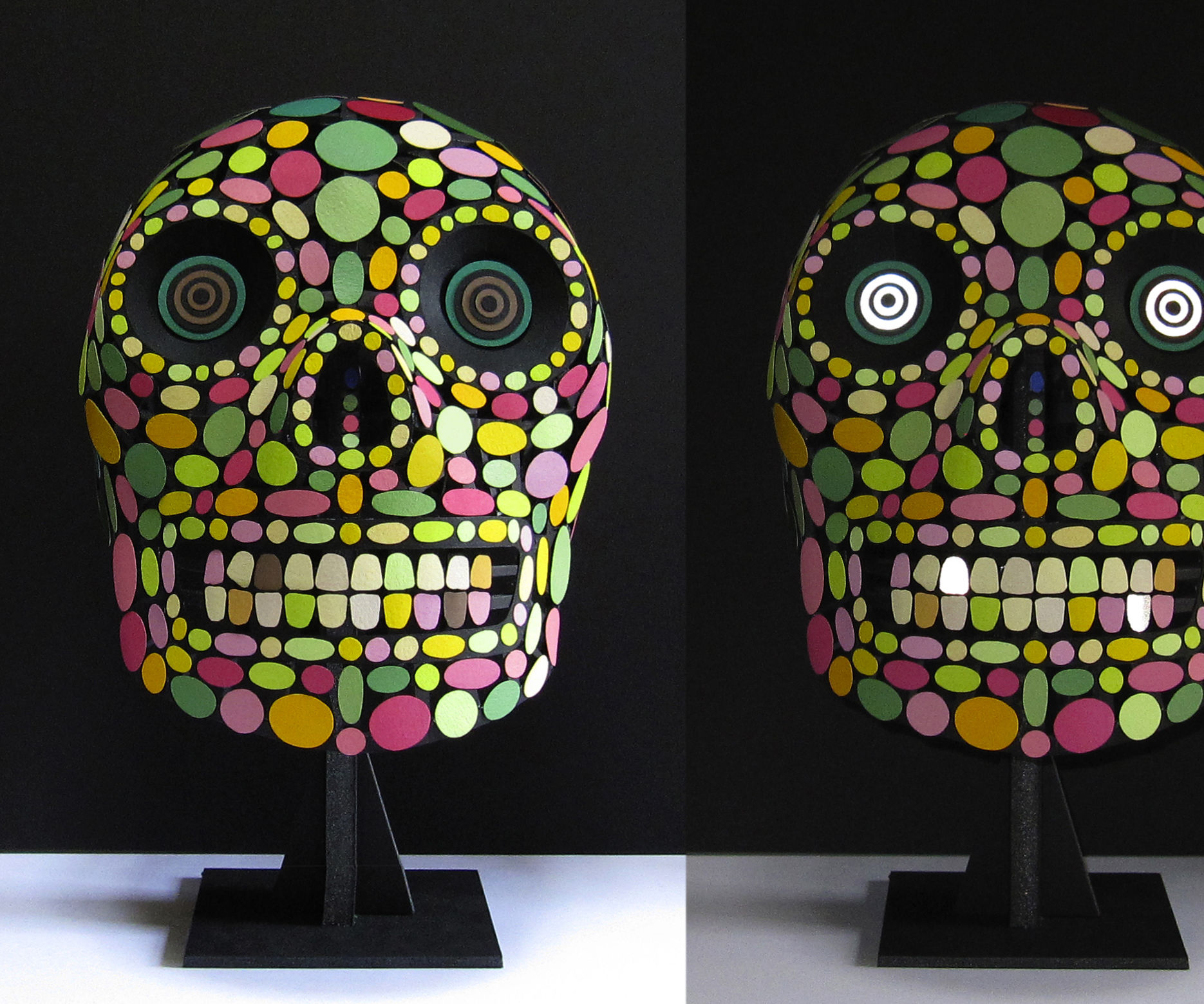

Step 5: Mosaic Process
Pre-cut a bunch of 'tiles' and get started. Apply hot glue, set tiles one at a time. This takes a bit of practice. If you aren't sure about placement, use a clear adhesive dot to temporarily fix tiles in place until you decide. The teeth in this image are held in place with adhesive dots.
Note: If you don't like hot glue you could use thinner paper and double sided adhesive sheet as an alternative. I like hot glue because it's reversible. If you want to make changes simply hold the tip of the glue gun to a fixed tile for a few seconds. It will soften the glue and you can remove the tile. Another thing I don't like about adhesive sheet is that it really gums up scissors.

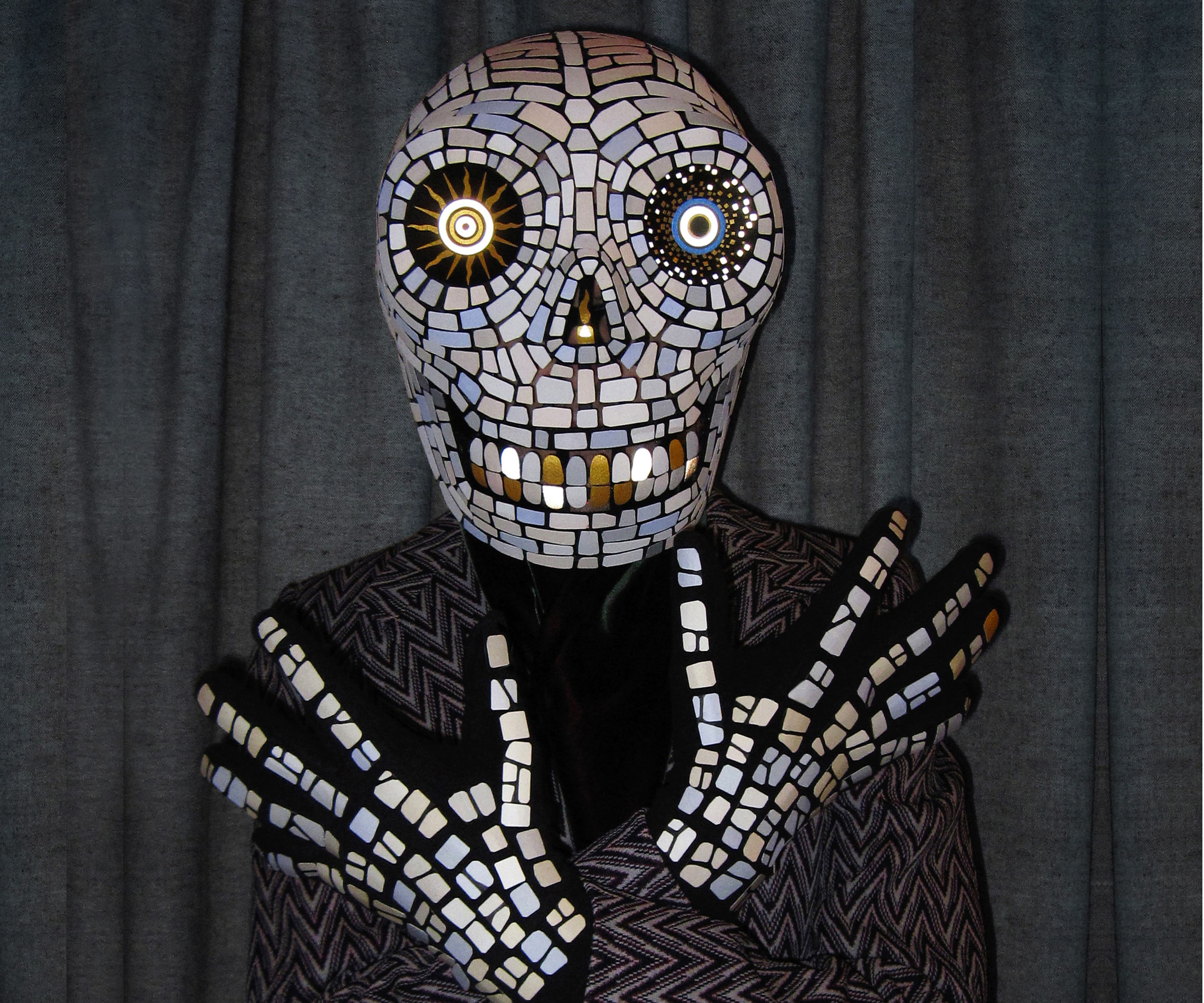

Step 7: Finished Piece
It'll take a while and a bit of effort and patience, but the result is worth it. The finished mask makes a nice object for display, or…
Step 8: Wear It With Your Favorite Hoodie!
