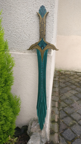

The 3d models did not include the texture on the sword so we laser cut out a thin acrylic piece and attached it to the model of the sword.
  • We used reference images online to just trace out the pattern.
  • You will need to come back after with carving tools to make this look more 'game accurate'.
  • If we were better with 3d modeling software, we would have embedded this piece into the model itself.

    • Using Epoxy Resin, and following the mixing directions on the container, mix dark blue Pigment Powder and blue Alcohol Ink.
      • Go easy with the colors as you want the sword to be transparent.
        • Too much pigment powder can darken the mold.
    • If we would make this again we would use Clear Smooth-On 325 as it cures much faster and would stay much stiffer.

Step 15: Remove the Mask and Apply UV Resin to the Entire Model
  • Apply UV resin to the carved hilt section, the carved pommel section, and the blade. This UV resin addition add all the shine to the piece.
  • Only apply as much as is needed to keep the area “wet”.
    • You do not want to flood the sword with resin and change the shape nor do we want to stretch the resin so that it pulls and creates uneven texture.
