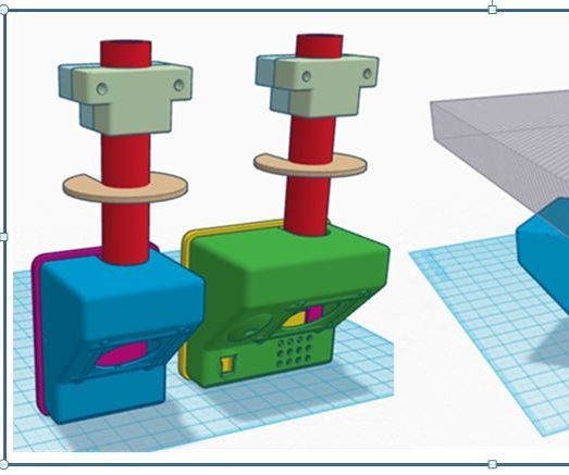

  5. The main control unit with a single control button and optional small OLED display for the local display of all main measurements, logged data and settings. An integrated web server & browser screens are available to read and set up the controller (The display is optional simply because the whole interface of the controller can be handled via its WiFi connection)

OLED display and Bezel (Optional)
I chose the ubiquitous 0.96" I2C IIC Serial 128X64 OLED LCD Display as a low cost simple local display module. This is actually not strictly required as you do all of the configuration via the onboard web server on your computer and/or mobile phone. The display just gives you a nice local display for viewing the main controller data. The firmware autodetects whether the display is fitted so you can just omit or fit as preferred. Fitting these displays neatly into a proprietary housing can be a bit of a challenge so I created a small bezel on my 3D printer. The resulting STL file is included in the list of downloadable files in the last section. Take care to use the I2C version of the display rather than the SPI version. Also worthy of note, you can get two versions of the display - one totally monochrome and one with the first two lines being yellow on black and the rest blue on black. You can use either but the display format is chosen to take advantage of the nice aesthetics of the dual colour!
Real Time Clock (RTC) (Optional)
I used the higher accuracy DS3231 RTC module available from Amazon and AliExpress in a variety of shapes and sizes (and prices!). Since the controller automatically updates the RTC at power up and every few hours via an online NTP server you do not need to do any initial set up of the RTC time. In fact given the regular NTP time correction, it is perfectly OK to use the cheaper lower accuracy DS1307 RTC module as they are both electrically interchangeable and both have an integral battery to preserve the time in the event of a power cut. It is also possible to use the controller without the RTC if you want to save assembly time and cost but the controller will take a few minutes to boot up as it MUST have the wifi connected at the start to set the internal clock from the online NTP server at power up. The RTC gives the advantage that once configured (via its own Web server), it will then run without any wifi connected and immediately on power up (Without wifi connected, the device can still be configured and viewed off line using its additional Offline web server running on the controllers own Access Point) that can be started by pressing and holding the control button for 6 seconds.
To mount the RTC on the front panel or anywhere convenient on the side of the enclosure you can simply use thick double sided tape bearing in mind that at some time you will need to change the RTC battery. If you prefer a more "elegant" mounting arrangement, I have included STL files for a dedicated mounting bracket that you can glue to the enclosure front panel/side wall that allows you to easily remove the RTC module for battery swap.
