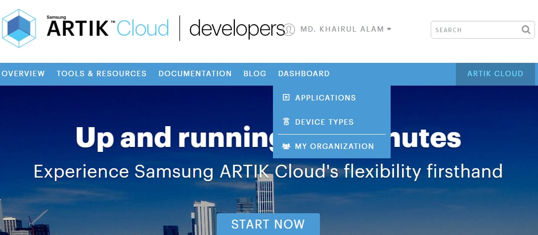

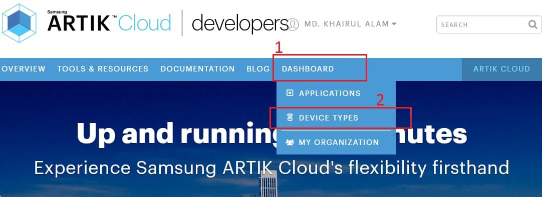

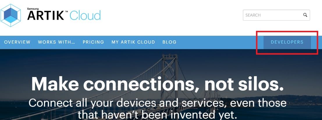

A) Log in to your Samsung account and Click on DEVELOPERS option from top right corner.
B) From the DASHBOARD select DEVICE TYPES.

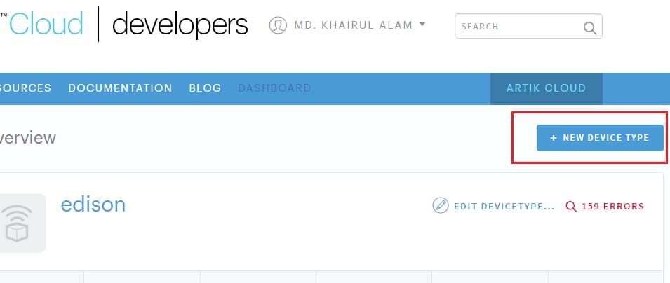

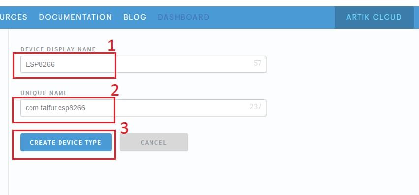

C) Click on + NEW DEVICE TYPE
D) On the DEVICE DISPLAY NAME type a name for the device and give a UNIQUE NAME, then click to CREATE DEVICE TYPE.

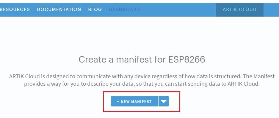

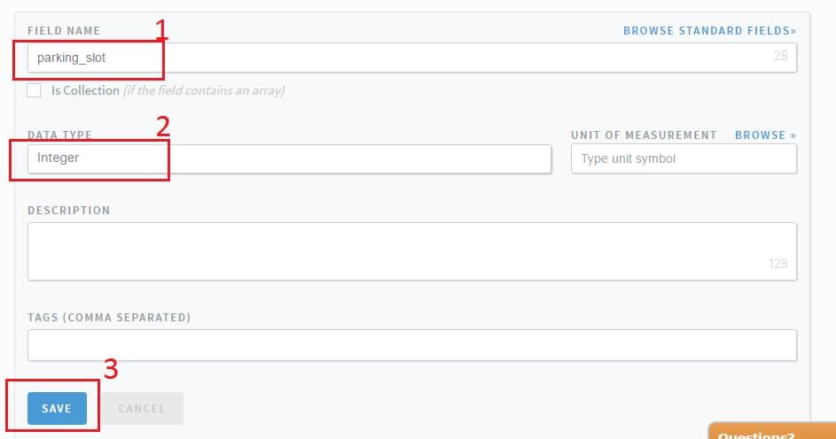

E) Click on + NEW MANIFEST
F) Type a FIELD NAME for your sensor data you will upload and store here and mention the DATA TYPE as integer. Then click to SAVE.
G) Then click NEXT: DEVICE ACTIONS

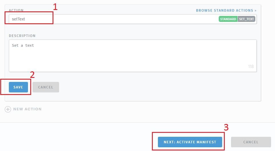

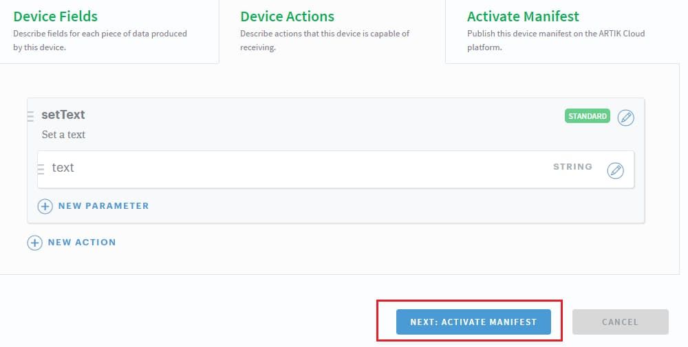

H) Make an action or select from the STANDARD ACTIONS. Click to SAVE. For our project actions will not be required. Then click to NEXT:ACTIVE MANIFEST.
I) Take a look to Device Fields and again click to NEXT:ACTIVE MANIFEST.

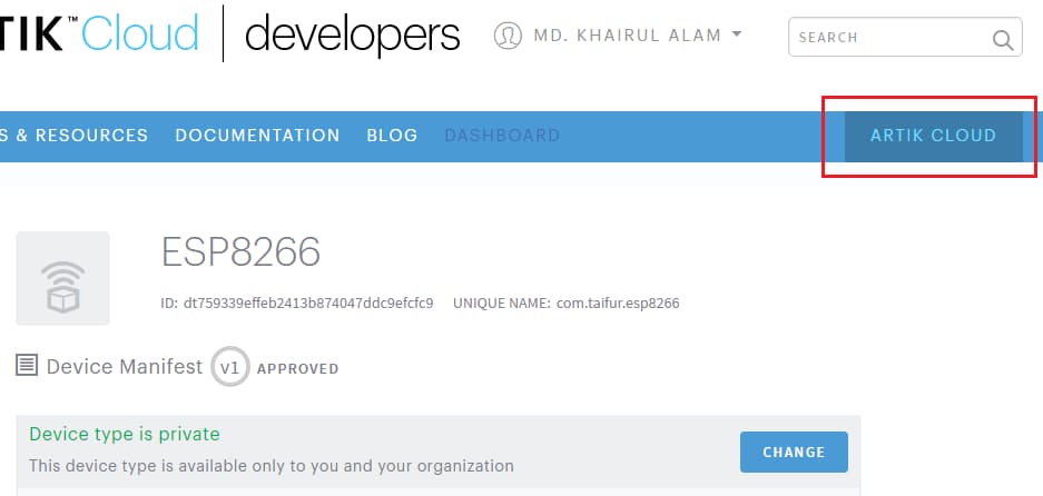

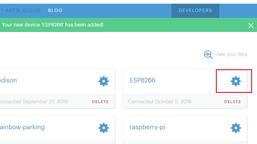

K) Go to ARTIK CLOUD from right top corner.

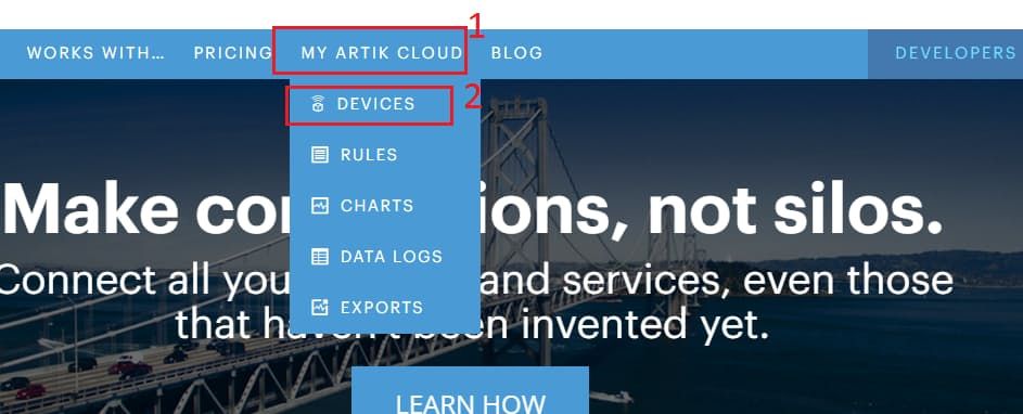

L) Click on MY ARTIK CLOUD and select DEVICES.

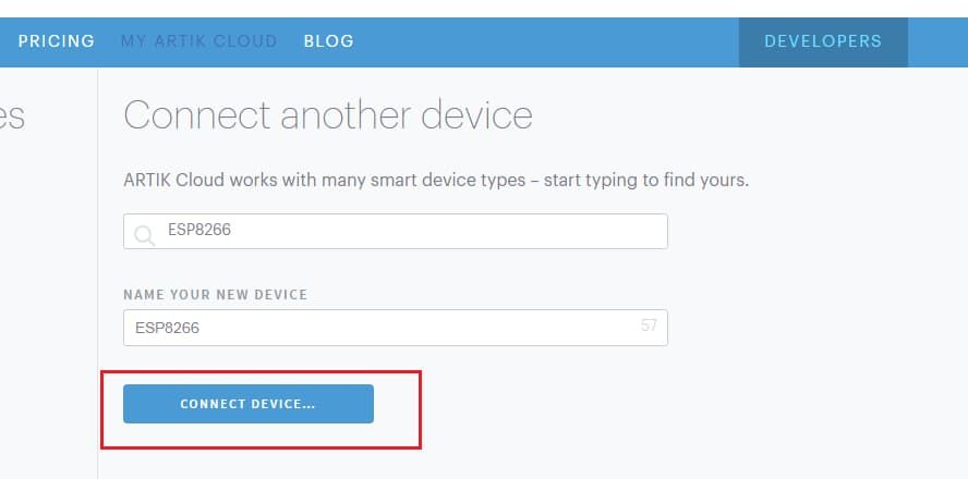

M) Click to +Connect another device.

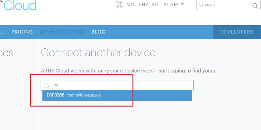

N) Type the name of the device you just created and click on it.
O) Click on CONNECT DEVICE... button.
P) Your device is connected to the CLOUD.

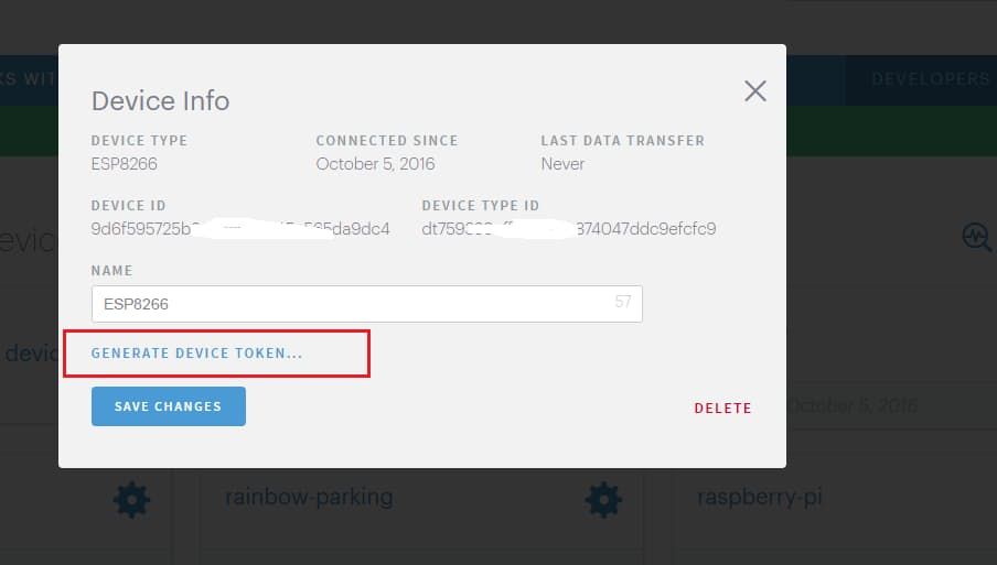

Q) Click on settings icon.

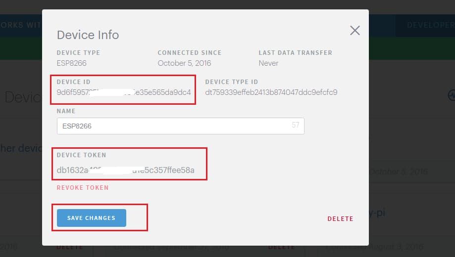

R) Click on GENERATE DEVICE TOKEN...
S) Note down your DEVICE ID and DEVICE TOKEN. These will be required latter every time you want to connect to your device from physical devices, web apps or android apps. Click on SAVE CHANGES.

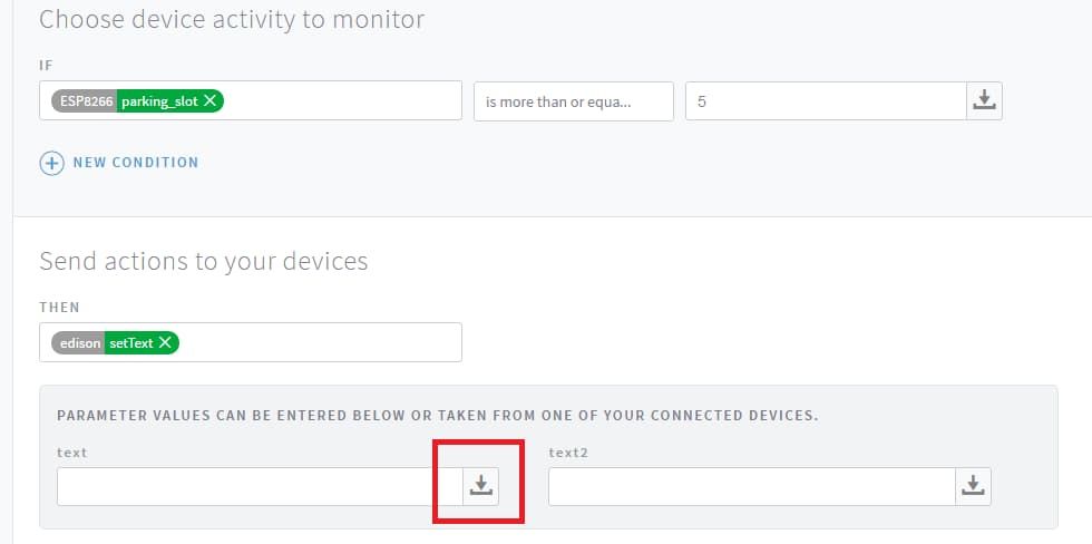

Step 3: Making Rule in Artik Cloud

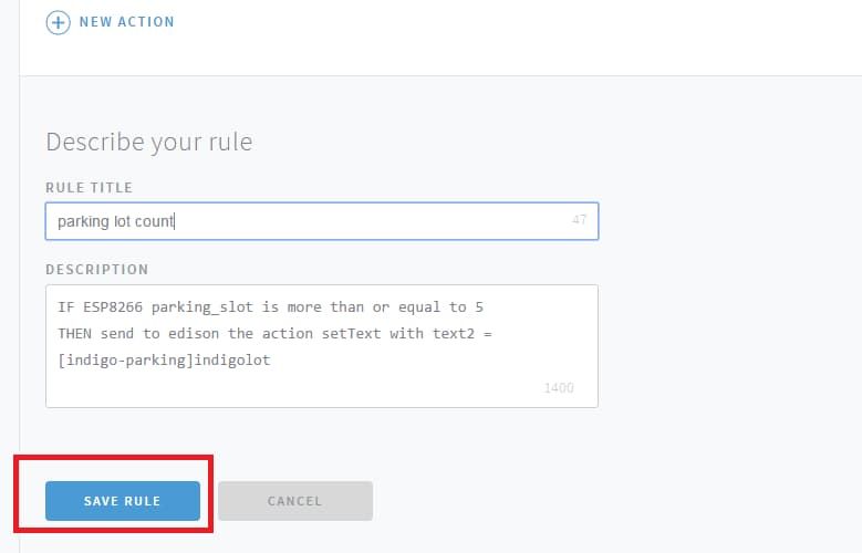

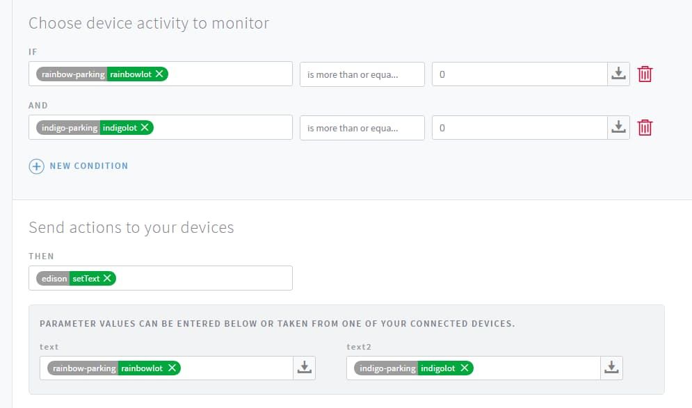

In this step we will make a rule where we set some conditions according to which Artik cloud will generate an action when the condition meets and the devices and applications subscribed to the action receive a message instantly.

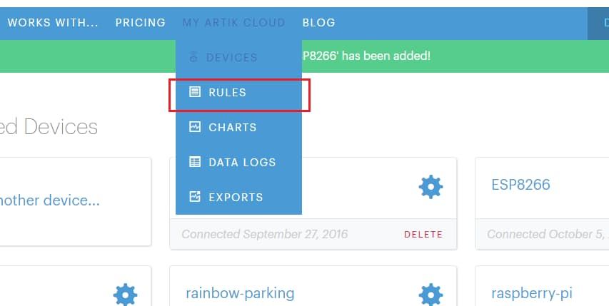

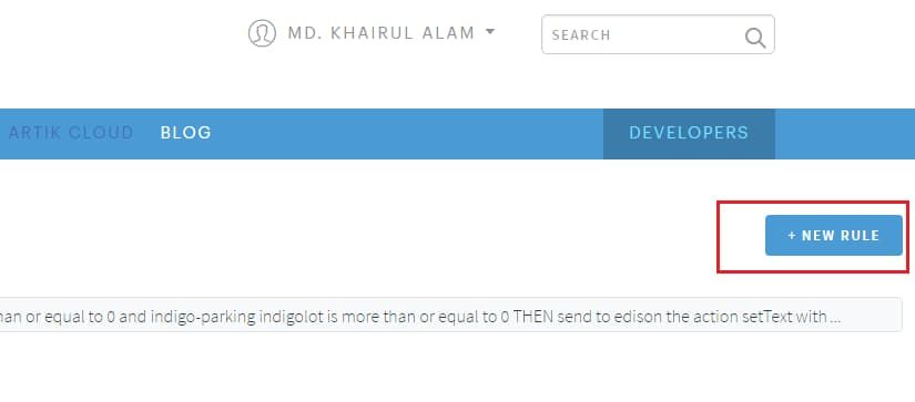

A) Select RULES from the MY ARTIK CLOUD menu
B) Click on + NEW RULE

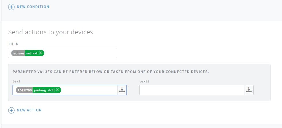

C) From IF selection box select a data field for a device and set a value and condition. Then select an action for a specific device from THEN field. You can set a constant parameter value or can select a value from another device data. To define a data field from another device click on download icon shown in red box.
D) Select a device from the drop-down and then select data field.
E) Then click on SAVE RULE.
F) The complete rule for our project should look like as following screenshot.

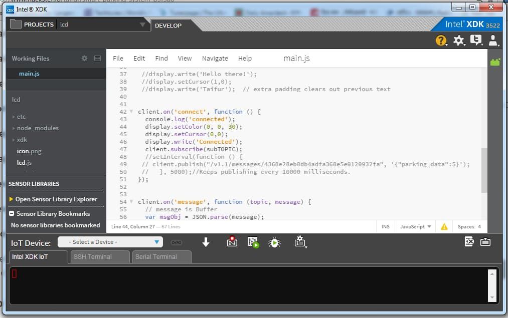

Step 7: Preparing Intel Edison
I am assuming you have some previous experience on working with Intel Edison board.
A). Download Intel XDK from the link and install it to your computer.
B). Find edison-lcd folder from attached zip file and open with Intel XDK.
C) Connect i2c LCD display with Edison board. You may use base shield for easy connection.
D) Connect Edison board with computer using serial cable and upload the code and then run it. Uploading and running code in Edison board is very easy using Intel XDK.

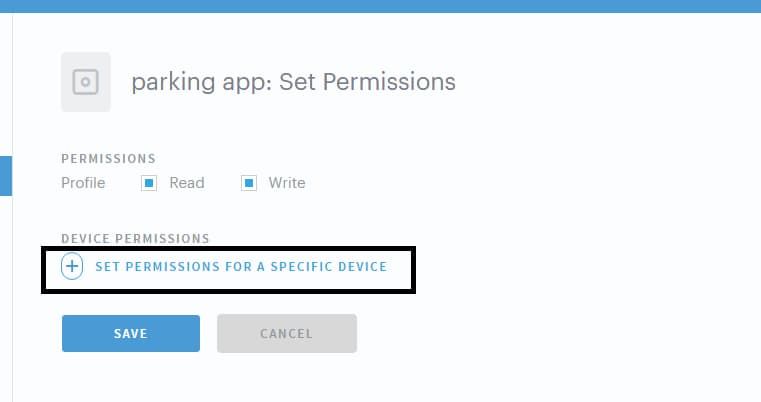

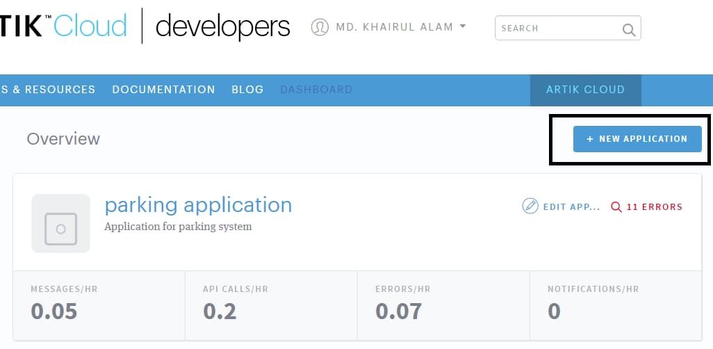

Step 9: Creating an Application in Artik Cloud
Before going to develop Android application you need to create an application to Artik Cloud. To do so use the following steps:
A). From the developer dashboard select APPLICATION

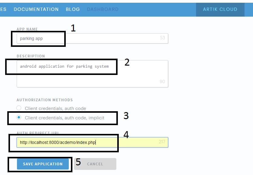

B). Click on +NEW APPLICATION
C). Put name and description. For authorization select Client credentials, auth code, implicit. Put http://localhost:8000/acdemo/index.php as redirect url and then click to SAVE APPLICATION button.

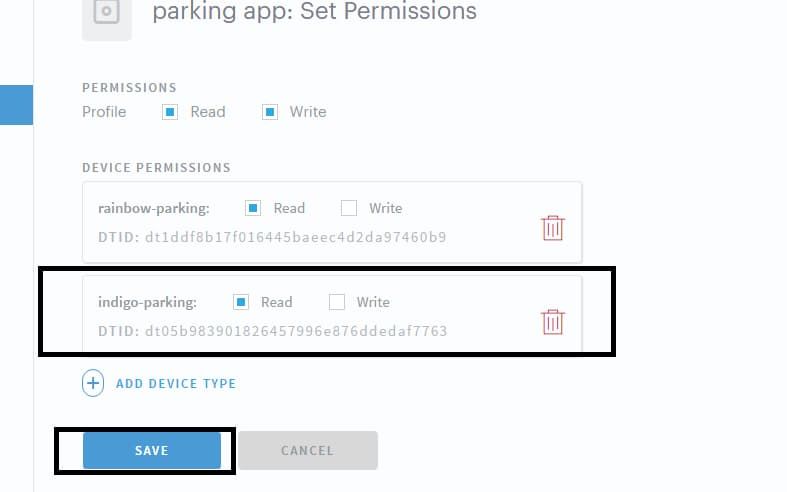

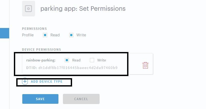

D). Click on SET PERMISSION FOR A SPECIFIC DEVICE.
E). Select rainbow-parking and click on Read check box. Then click ADD DEVICE TYPE.
F). Do the same for indigo-parking and click on SAVE.

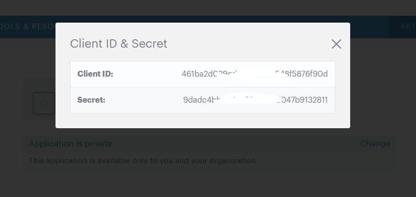

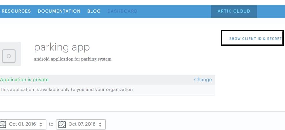

G). From the top right corner click on SHOW CLIENT ID & SECRET
H). Note down Client ID and Secret, these will be required for Android Application.
We are now ready to develop Android Application for our project.

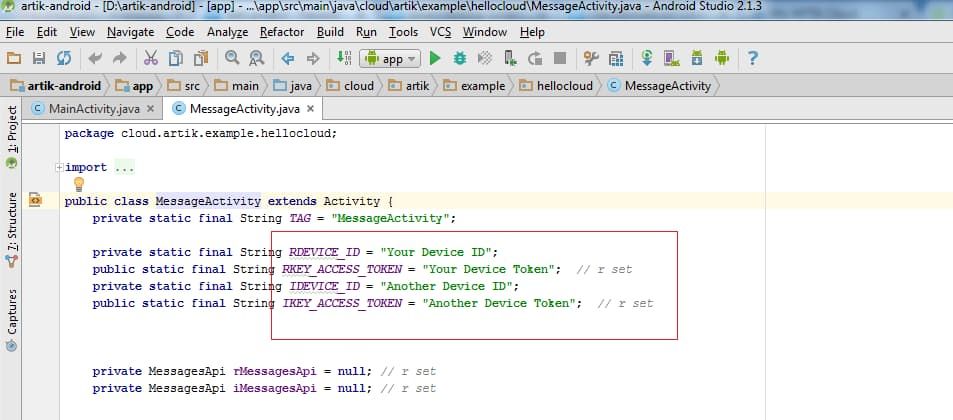

Step 10: Developing Android Application
I will show you here, how you can develop and Android application in Android Studio Platform. I am assuming you have some previous experience in Android application development.
A). Download Android Studio and install it to your computer.
B). Find android-app source code from the attached zip.

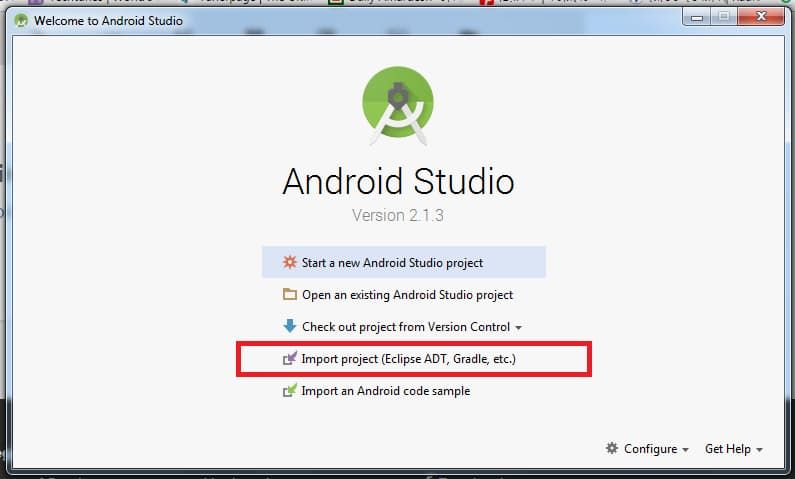

C). Run Android Studio and import the project by browsing the source.
D). Open MainActivity.java and put your CLIENT ID you got after creating application on Artik cloud.
E). Open MessageActivity.java and put DEVICE ID & ACCESS TOKEN for the devices you added to the application on Artik cloud.

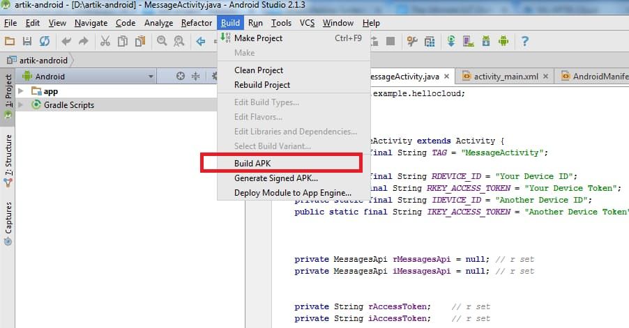

F). Save the changes, Build APK, install it to your mobile phone and enjoy.
