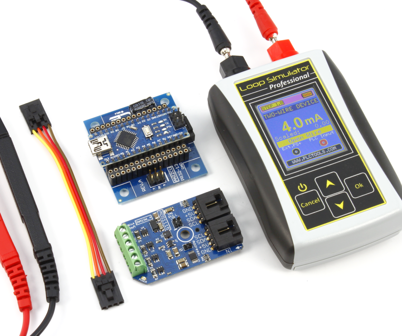

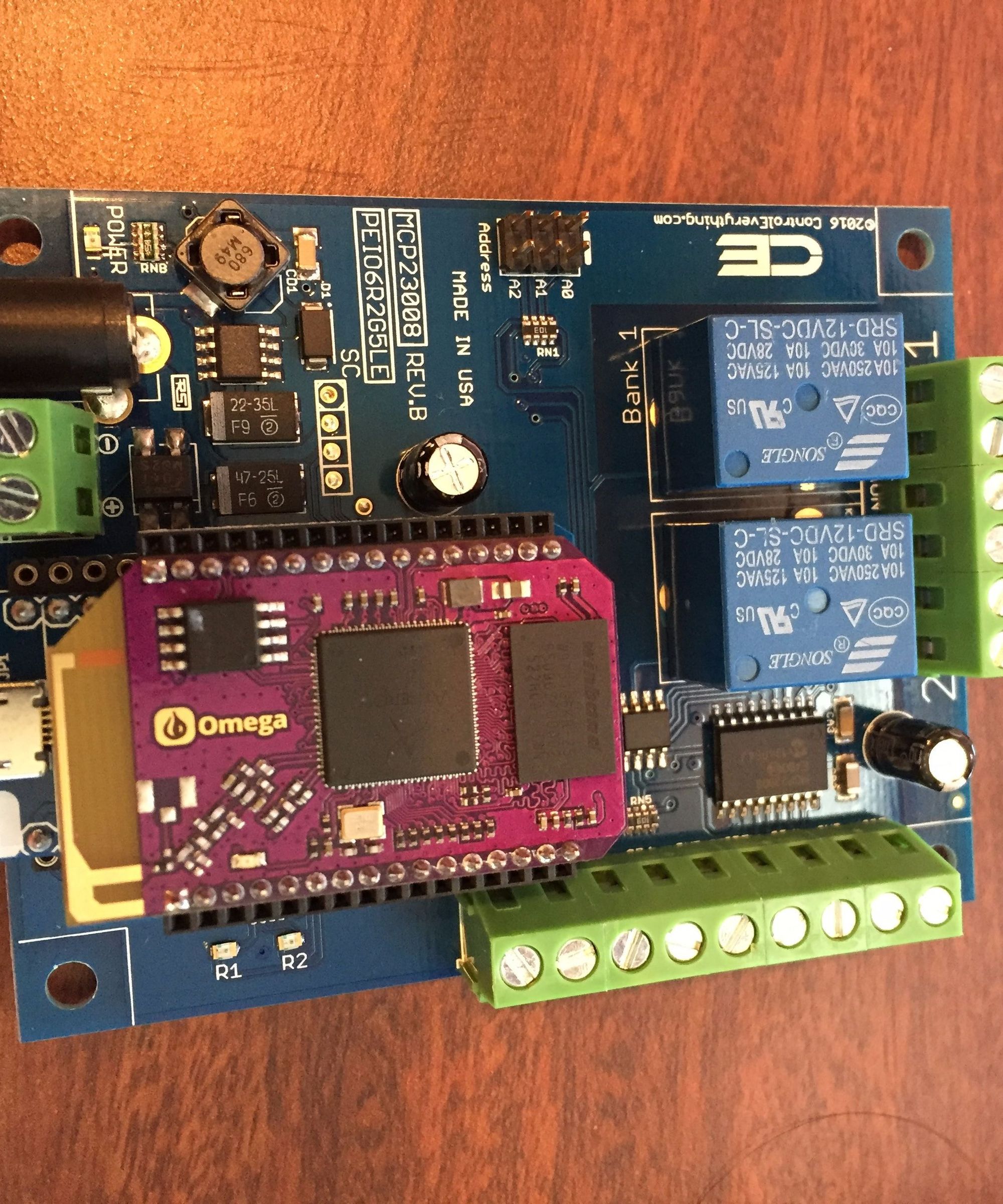

Step 2: Hardware Connection and Setup
The onion omega is plugged into the Onion omega I2C adapter.
This Onion Omega adapter has a USB port which will provide power to the Onion Omega and the relay board. It also has an I2C connector, which makes it really easy to connect it with all kinds of I2C devices. 1 Channel Relay board -- this board from controleverything.com has a PCA9536 chip and one SPDT relay on it. It also has an I2C connector so it's easy to connect with the Onion Omega I2C adapter. We will also need a 2.4mm barrel connector and a power cable. To make the connection plug the Onion Omega into the I2C shield and connect the relay board to the I2C shield. The barrel connector has 3 pins. The tip of the barrel connector will be connected to the Normally Open of the relay board and Sleeve will be connected to the power cable ( as shown in the picture). The other wire of the power cable will be connected to the relay common. So the relay board is simply working as a switch.

Step 4: Testing and Debug
After programming the Onion Omega it will turn on the power supply and will wait for our WiFi to connect. Once it's connected to WiFi it will constantly monitor the internet connection and when there is no internet it will reboot the router by resetting the power. You can also login into your Onion Omega and it will display on the terminal if the internet is working or not.
For testing purpose, I will disable the WiFi connection on my Onion Omega and it started to show no internet. Then I enabled the WiFi and it started to show that it was connected to the internet. You can also change the toggle time. So let's say if your router takes a lot of time to boot then you can increase in the code.(change this line time.sleep(100)). It depends on how quick your router responds. If your router takes a long time to reboot then increase the toggle time. You can also use this code to check if your website is working or not.
