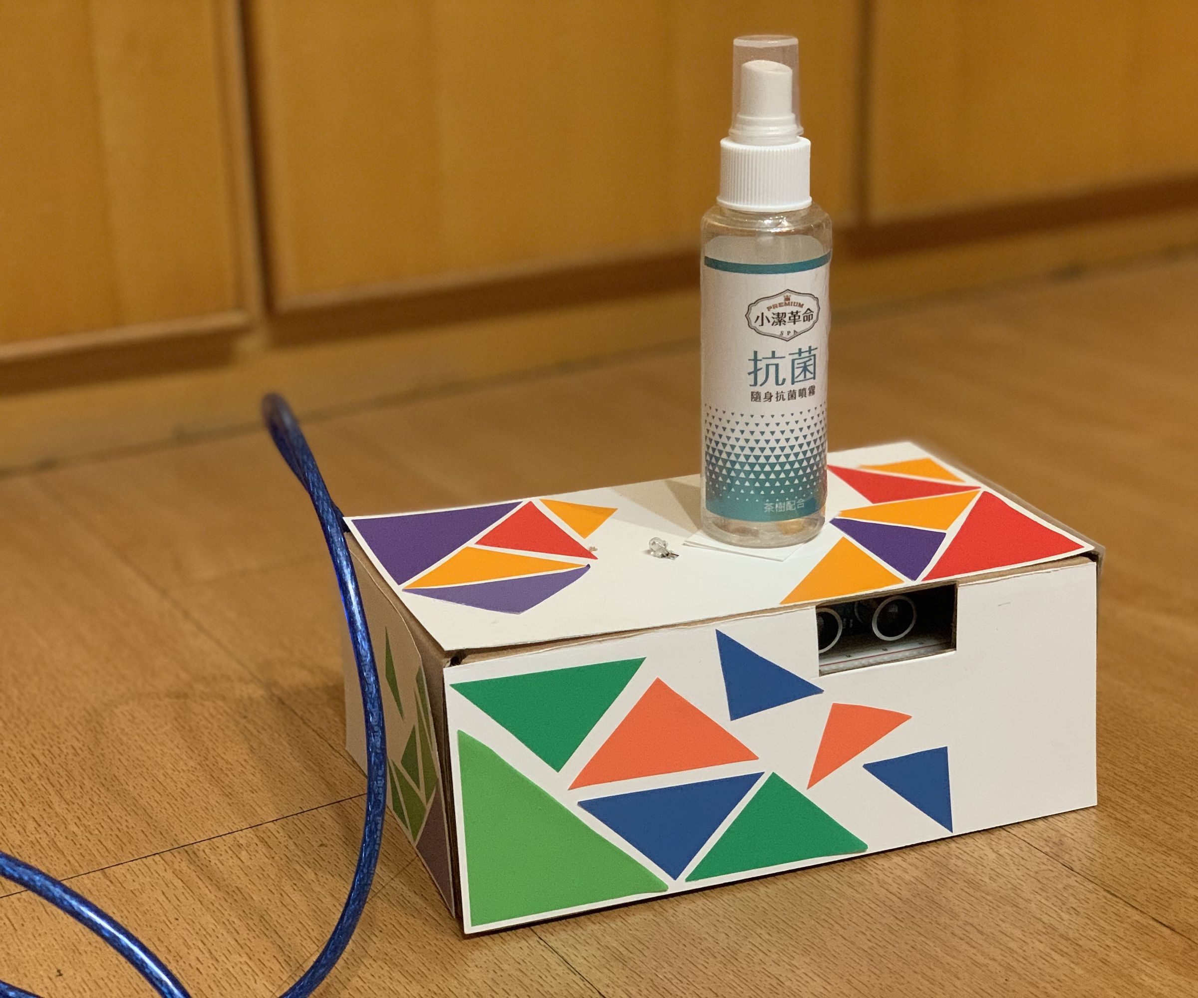

Introduction: Soap Dispenser With Built in Timer
With the coronavirus outbreak, the best way to prevent yourself from getting infected is constantly washing your hand. But simply washing your hand isn't enough, it is equally important to wash your hand for a long enough period of time, so I have decided to adapt a Arduino soap dispenser timer.

How have it been changed? I've added a vibration motor so that when the timer is over it can make a pitch

Step 2: Build the Circuit
Build the circuit according to the picture provided above
根據圖上的指示將電路接好
Step 3: Upload the Code
Upload this code: https://create.arduino.cc/editor/phoebe_lin/6c610...
將這個程式碼上傳:https://create.arduino.cc/editor/phoebe_lin/6c610d...
Test the circuit and see if it works
測試電路是否成功
If successful, it should have the effect shown in the video
若成功應該要有影片中的效果
Step 4: Decorate
Use a cardboard box and drill hole wherever needed to decorate the soap dispenser timer
拿一個紙箱並剪出需要洞的地方來裝飾此裝置
After that, use wrapping paper to cut and wrap the whole thing
之後,用包裝紙將整個裝置包起來
Step 5: Now You're Done!
You have made yourself a timer soap dispenser
你完成了!你現在做了一個有計時功能的洗手乳裝置
