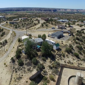

I live in Farmington, New Mexico which is located in the sunny southwest area of the United States. Farmington is located at an elevation of 5306 feet above sea level, higher than the mile-high city of Denver, Colorado. We enjoy an average of 273 sunny days annually (Farmington Convention & Visitors Bureau, 2017) making it a prime location to utilize solar energy. The combination of improved technology and decreasing equipment costs have made the use of solar power appealing to many. My initial total expense was $13,000 with a federal tax benefit of $5,000. The annual limit of funds granted for solar credit from New Mexico was reached so I was not able to receive a state benefit. My electric bill has been reduced from $130.00 to $10.00 per month. With the annual savings of $1440.00 it will take approximately 5.5 years to recover the initial expense of the system. The estimated life expectancy of a system is 20-25 years. There are several types of systems available, determination and personal selection is out of the scope of this presentation. I selected a SolarEdge 7.6 kW single phase inverter system that utilizes power optimizers (SolarEdge, 2017). SolarEdge includes optimizer-level monitoring for 25 years at no charge. I installed 20 panels with a maximum total output of 5.5 kW.
