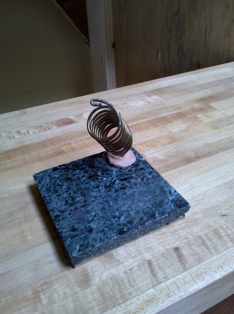

I decided to do one with a marble base and one with terracotta. They were made in the same way. This is mainly a step by step of the terracotta model with a few shots of the marble.

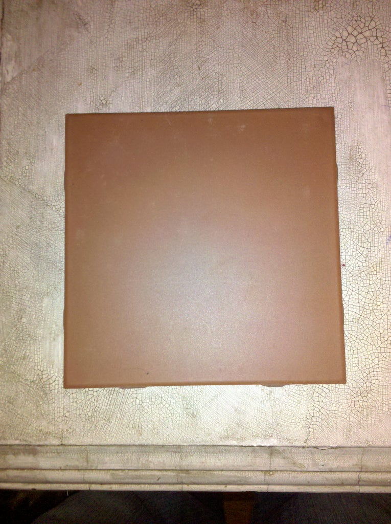

STEP 1: What You'll Need
A marble or terracotta tile in whatever size you want

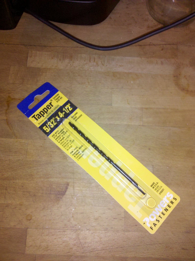

A drill
A masonry bit. I used 1/8th inch but you could use another size if you like

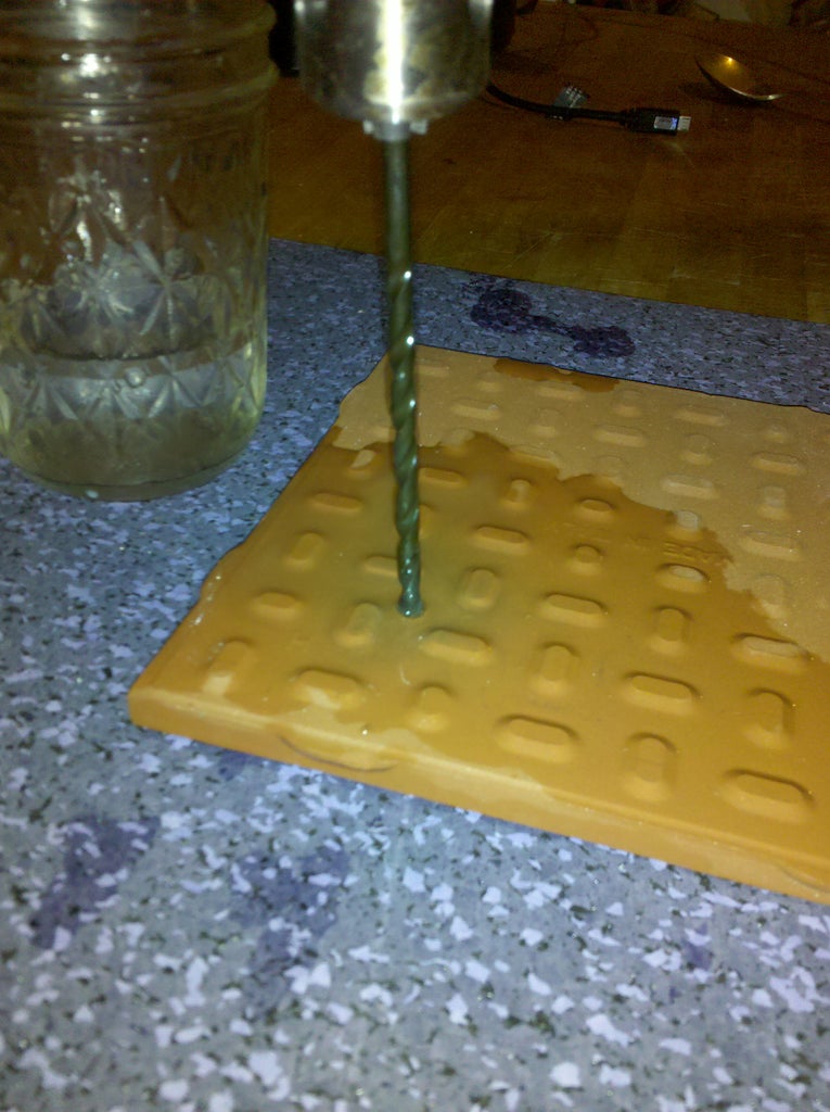

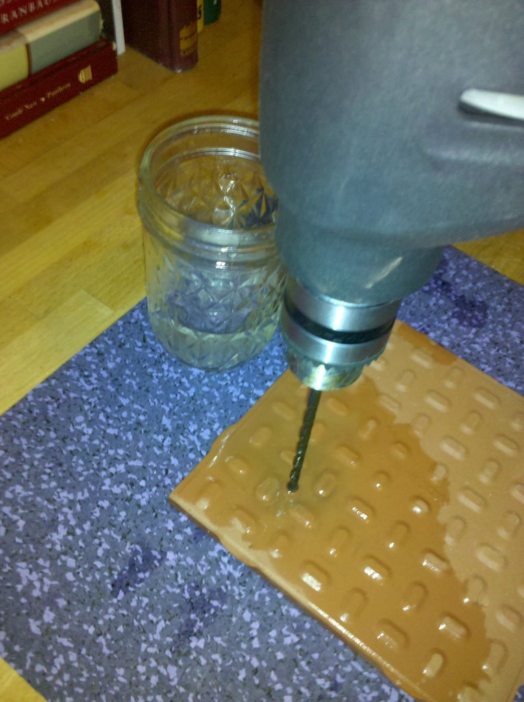

STEP 2: Drilling the Hole
My first mistake, I drilled the terracotta tile from the back and it spalled pieces off of the front. Not only should I have known better I did and just wasn't paying attention. So, even though I had planned on putting a small leather embellishment at the base of the wire coil, it became necessary to cover the fractured surface of the tile. No big deal in the end.
Second mistake was not waiting til I could get to a drill press. So my hole was slightly chamfered and out of round. Again, not a big deal but could have easily been avoided by using a drill press.
When you do drill your hole, using a drill press or not, you'll need to keep a little water on hand to cool the bit. The friction from drilling stone or ceramic will heat the bit to the point of throwing sparks and either dulling or melting the bit as well as ruining it's temper. So, keep it cool.
I managed this with little issue other than the fact that as the bit grinds through the tile it clouds the water so you can't really see exactly what you are doing. Not an issue if the tile is locked in place and the bit isn't able to dance around or creep in one direction or another.
So, just pick you spot and drill. It's not a critical choice.

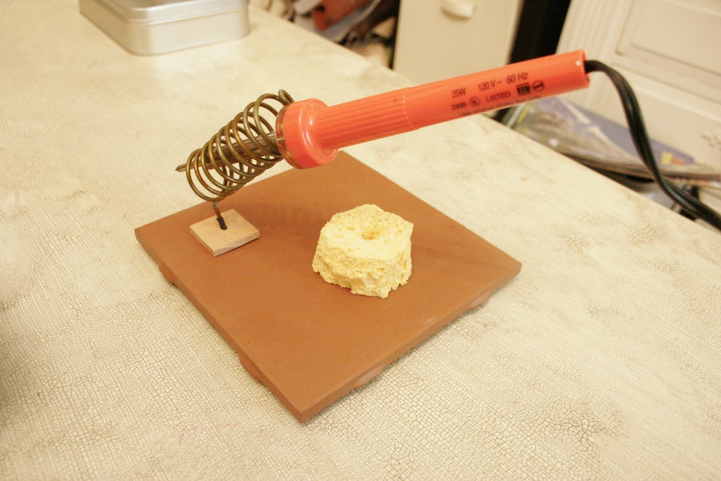

STEP 8: Finished
Enjoy your swank new soldering iron stand.
