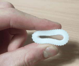

Step 20: 3D Printing
To 3D print we need to export this solid in exactly the same way as the previous one:
1) select the object.
2) click the big AutoCAD A in the top left corner of the display and click export and then scroll down to other formats.
3) then save as SolidOfAConstantWidth2.stl
Now you should have a file ready to be sliced for 3D printing.
If you have a 3D printer that is great, but if you don't you can either send it to a 3D printing service or you can do a little research and find a place in your area which has one. I go to the local university where they have a few 3D printers and it costs me 7 cents a gram.
I printed mine with 1 shell, 15% infill, 0.15mm layer height, raft and supports, and I found the bigger you printed it the better the effect. With these settings they turned out beautifully although if you want to put them under some pressure there is no harm in increasing the infill. Also removing the supports was a little tricky, but by using a small pair of pliers to remove the bigger bits and then going over it with a Dremel with a sanding drum smoothed it well.
