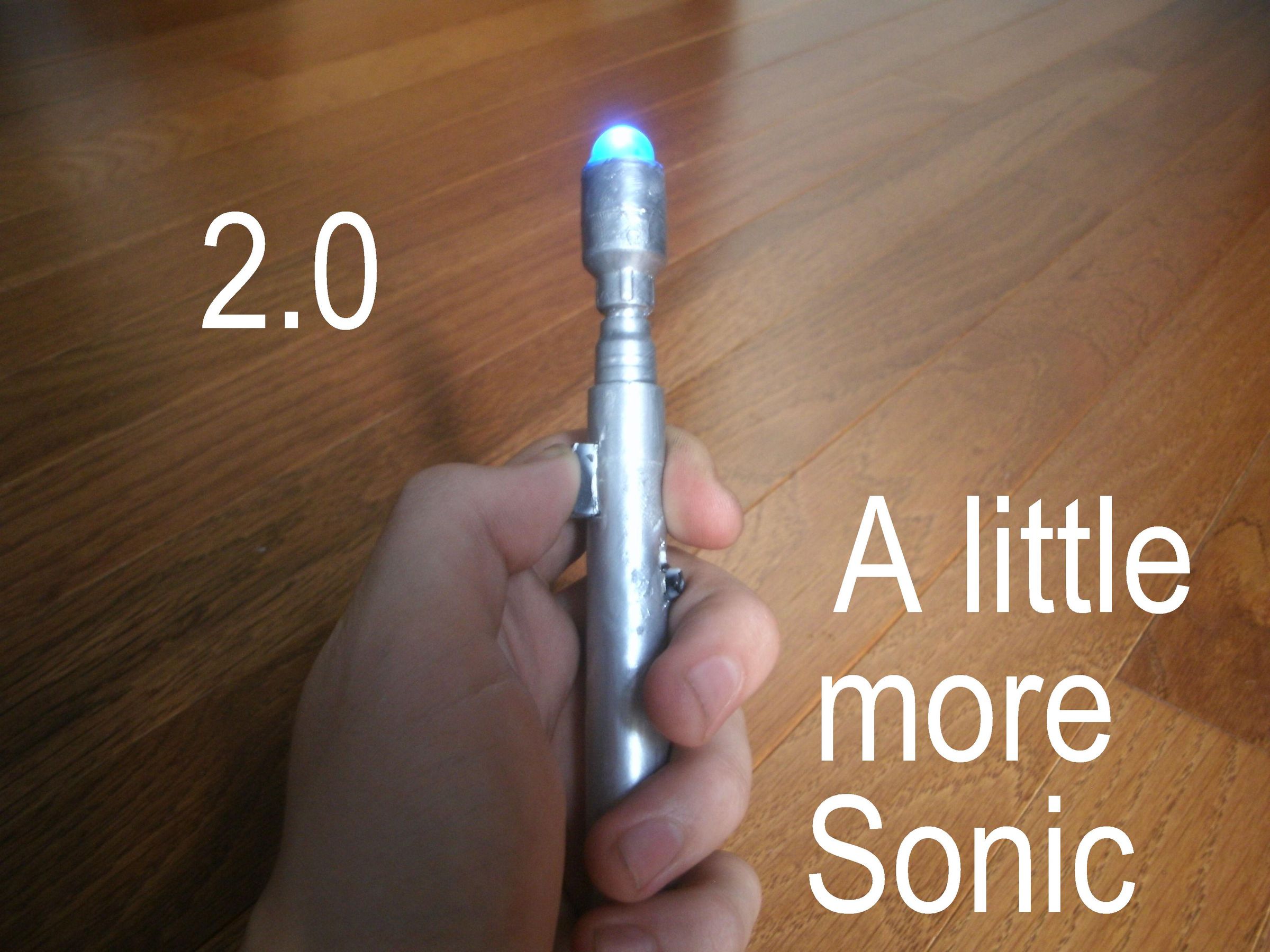

Step 8: Going Further...
So, after breaking my original screwdriver, I'm looking to make a new one with improvements. I took some suggestions from the comment field, and I now have plans to use a 556 IC in Atari punk console circuit (Thanks to Winter Man, I wasted a whole afternoon playing with that thing), a few of these things in series to make 5v, and a mini-USB port for charging (kudos to Drabinowitz).
I drew up a little schematic below, and with some jiggery-pokery and a thin speaker in place of a buzzer it just might fit inside.
