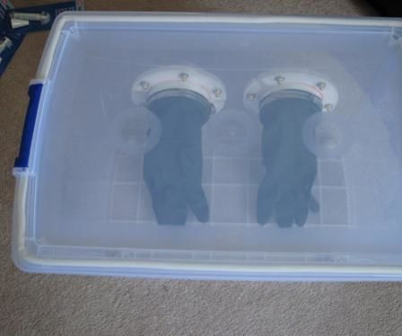

I built my Glove Box.

1: I made a mixture of 1 part bleach to 9 parts distilled water with one drop of dish soap. Filled a pump bottle and also a measuring cup with the bleach solution.
2: Boil all the tools (not the syringes with the seeds in them) for 10 min. I also boiled a pot of distilled water to sterilize it. Sterilized the inside of the glove box with bleach and water. Basically sterilize EVERYTHING that is going into the glove box.
Step 11:
1: I used 2 little pieces of coffee filter and pushed out the sugar water.
2: I cleaned out the glove box (lid, gloves, EVERYTHING) with 1 part bleach to 9 parts water.
Step 12:
1: I also sprayed everything that went into the box with a 1 to 9 bleach to water mix. In the measuring cup I have peroxide in that, not water.
2: I gave one last quick spray and then closed the lid on the glove box and let it sit for ten minutes.
DO NOT open the lid.

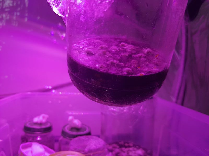

Step 16:
This is about 3 months after. Those little green specs, yes hundereds of them, are Protocorms.
