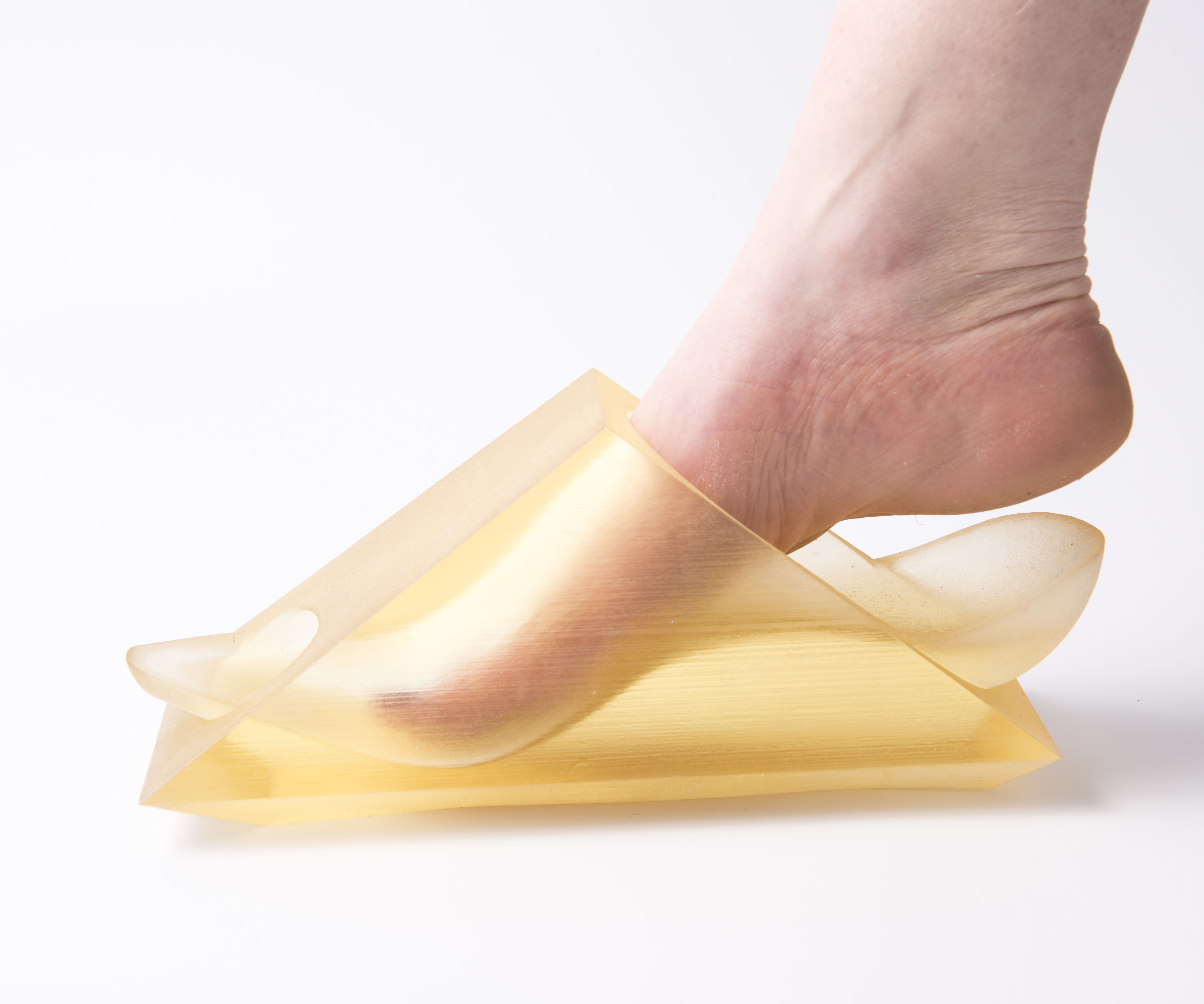

Step 4: Spring Heel
The design process included a deep research of the material properties and enabling flexibility by designing a unique structure. I was looking around in a spring shop (yes this is something that exists) and researched about a lot of different springs until I found the one that I could change accordingly to my vision.
It was a long way until I finally designed the final spring , I attached pics from my experiments ... don't give up !
Try to make a spring and to combine it to heel to get spring heel that could to hold your body.
You can look in the black photos the difference of the spring when it's being stepped on and when it's in a neutral position.
