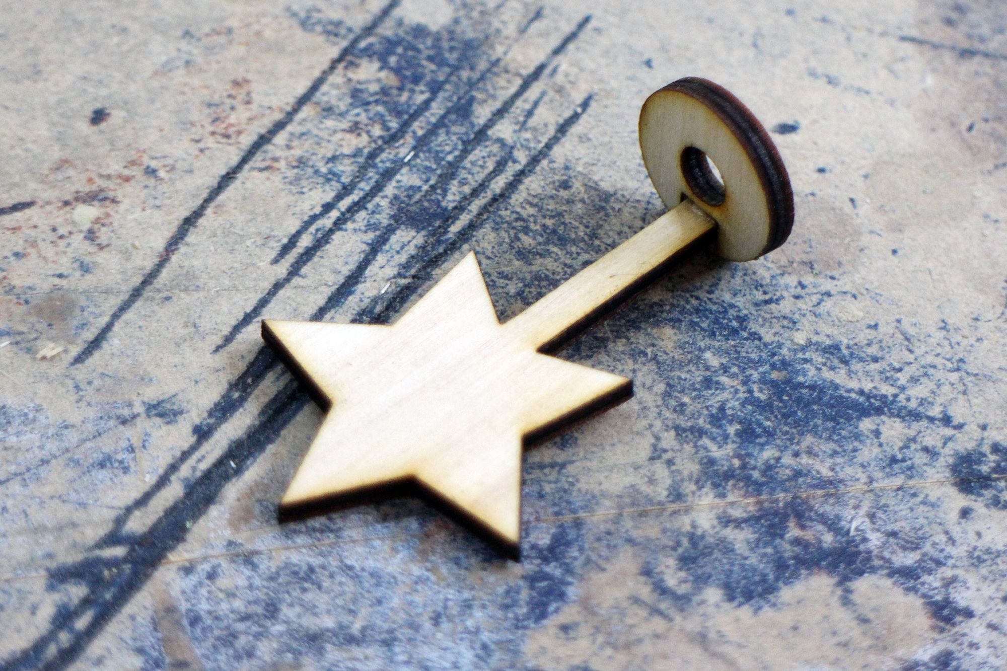

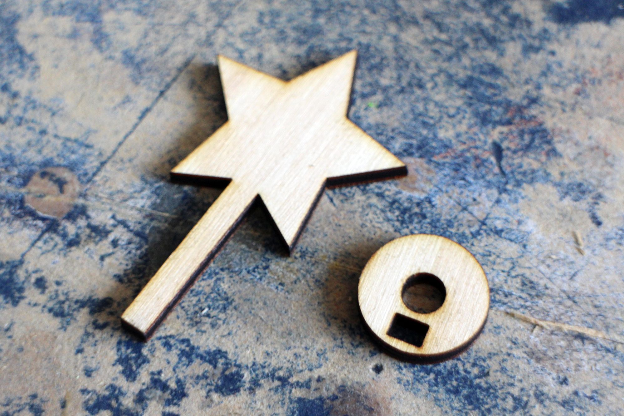

Step 10: Base + Star
The base was made from a few cut pieces of plywood, using the same dimensions for the rectangular tree pieces. However, to keep the tree rigid the hole opening was made 0.5mm smaller. This stiffness allows the tree to stand upright.
d
The star was made by using a star shape in Tinkercad and adding a rectangle to it, then exporting as an SVG and laser cutting.
![](https://content.instructables.com/FCE/OBHI/JL47EWM7/FCEOBHIJL47EWM7.jpg?auto=webp&fit=bounds&frame=1&height=1024&width=1024)
Since these pieces aren't painted, they were sanded to remove the scorch marks from the laser.
