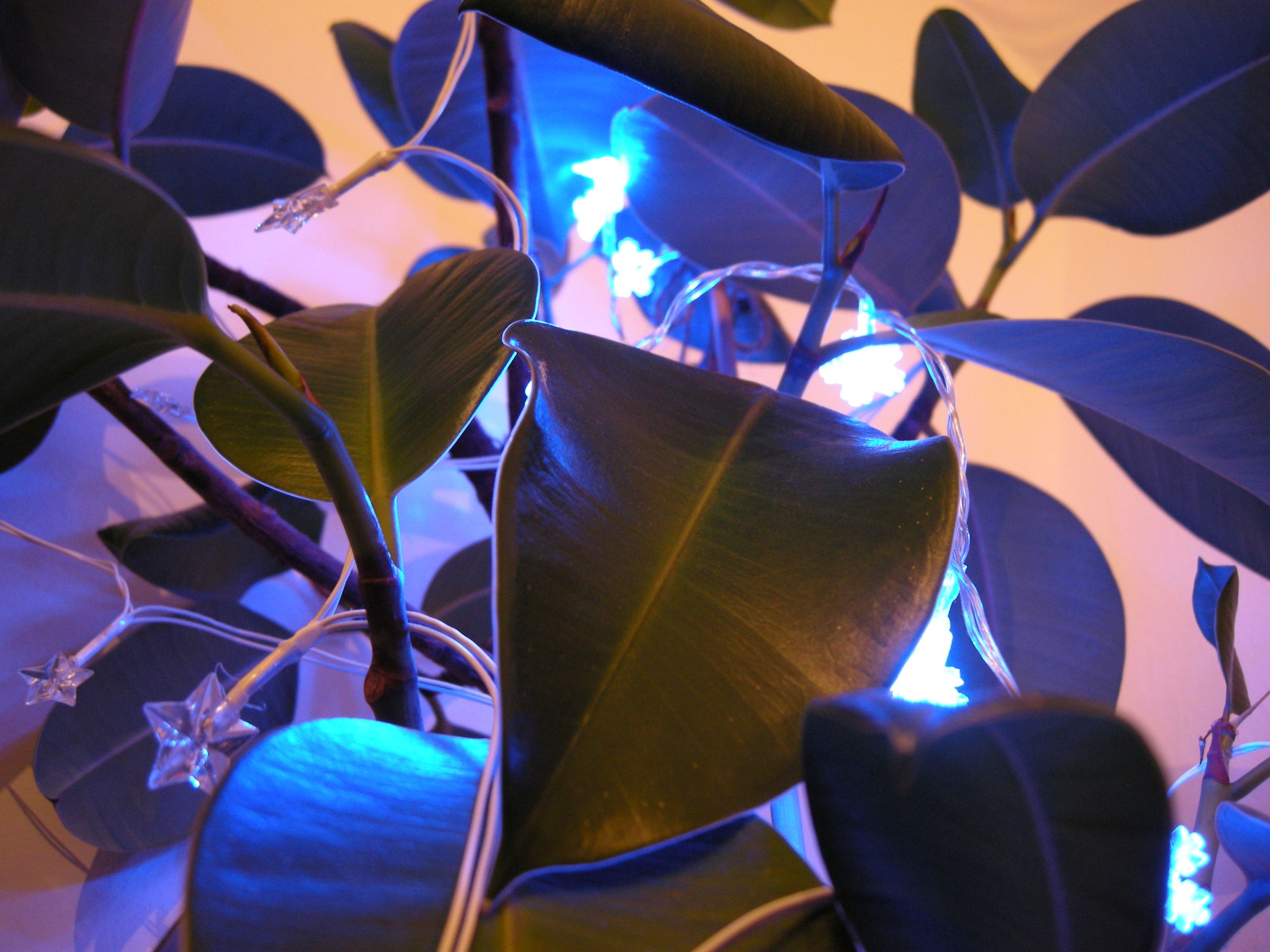

Step 3: The Results
Detach your computer and power the Arduino from the mains adaptor (ensure it is set to 5V and the power jack is centre positive).
The Geiger counter should also be powered (ensure there are no batteries inserted) and the LED strings should start to fade in and out.
Tastefully arrange everything, sit back and enjoy!
