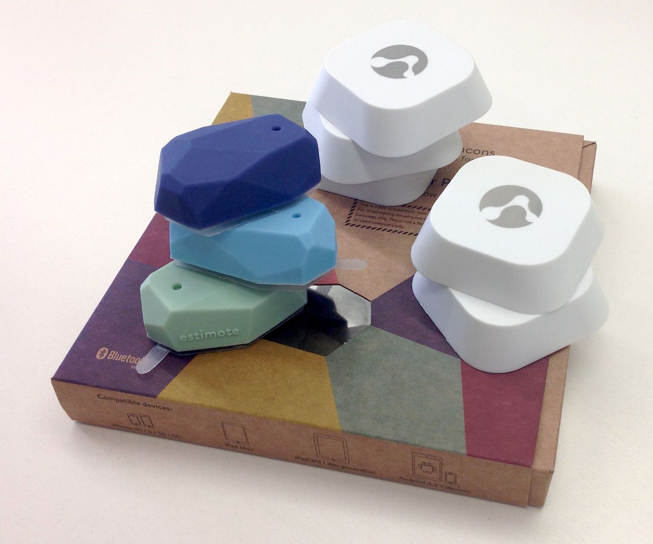

Now you are good to go to find and connect to Bluetooth and Bluetooth Low Energy devices.
