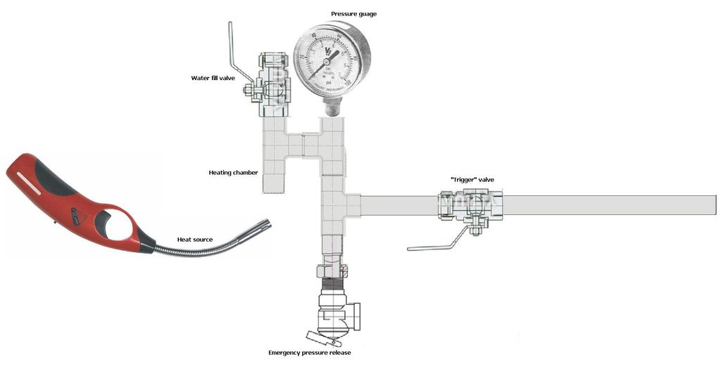

This is a prototype steam potato pistol and can be taken a lot further, but I'm just sticking to functioning basics here. Someday I would like to make one with a pressure gauge, quick release valve, and a better handle with the fuel stored inside the handle. I'm calling this version the SPPP1.
