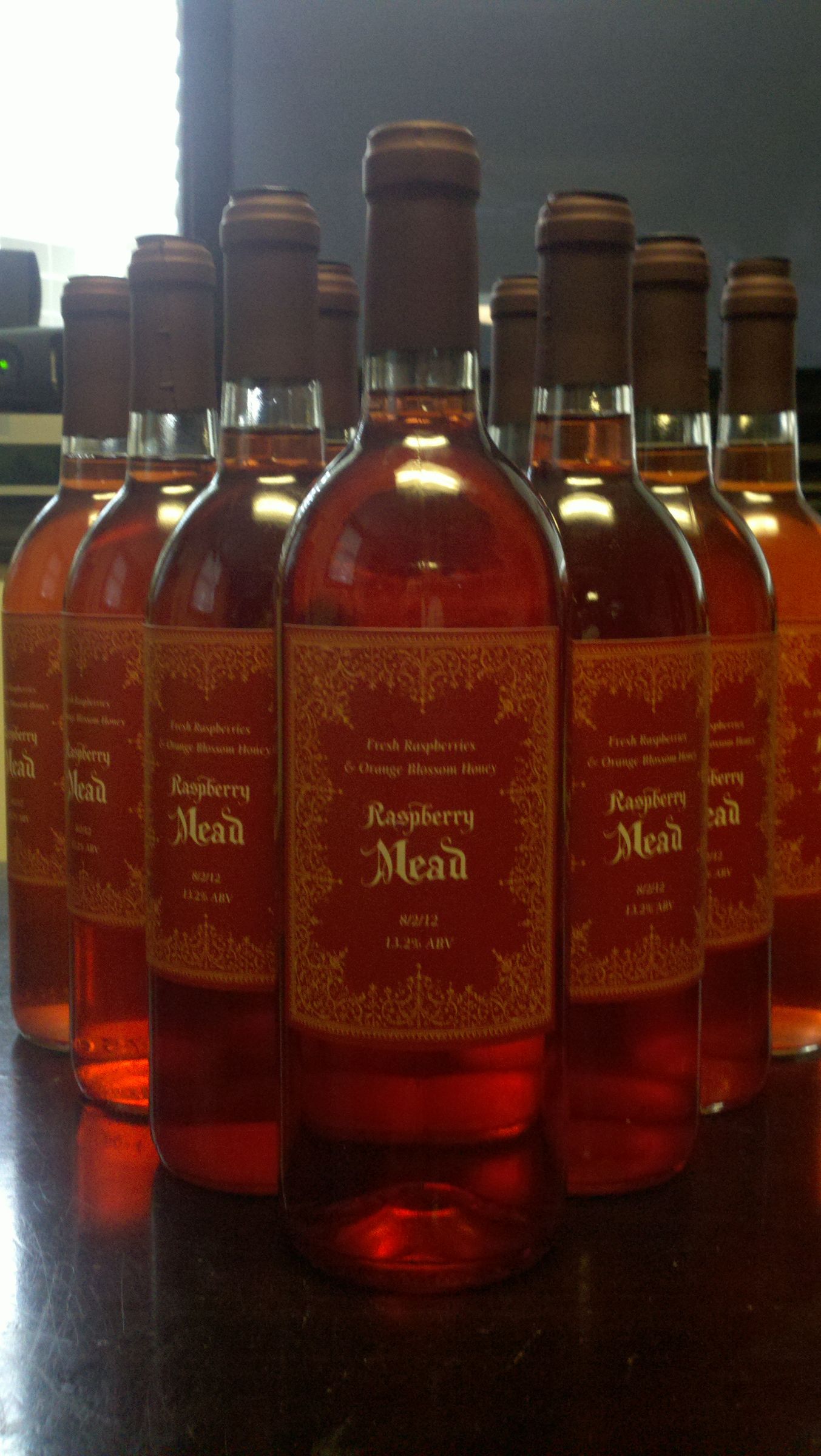

Step 11: Aging/Bottling
The mead is ready to bottle if you haven't had a change in gravity readings from one week to the next. They also say it's good to bottle when it clears, but if you add Super Kleer that's not a great rule of thumb to go by! But given the choice, most people prefer to age their mead in bulk (still in the carboy) rather than in bottles. Oxygen is your enemy at this point, so an inch of oxygen in a carboy vs an inch of oxygen per bottle is much less damaging. I also wouldn't sweat it too much, I've had some delicious glasses of mead that were aged in the bottle rather than the carboy.
But that's it! Try to keep your hands off it for as long as you can possibly hold out! It'll only get better! Thanks for reading and good luck!
