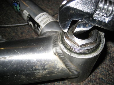

So here we have a bike bottom bracket that I want to take apart. However, the lack of standardization means that none of my bike tools are able to get it off. I could have waited a few hours till the shop at work opened, and snagged a larger wench from there, but I was on a mission.
I used the crescent wrench to grab on to the edge of the nut, and tightened it onto the edge so that it wouldn't wander off. I set it up so the handle crosses the rotation axis of nut. This will let me torque the crescent wrench with a large open wrench in the next step.
This has the potential to mess up the interior surface of the nut. It didn't and I didn't care because I was just trying to take it apart, but your mileage may vary.

Now that the crescent wrench is all snug, take a handy massive open wrench and use it to rotate the crescent wrench. Neither of these are designed to do this, but I didn't run into any issues with slippage. As long as the load is perpendicular to the axis of rotation it is a stable arrangement. If you start angling the open wrench up and down you will likely slip and bash the dickens out of your hand. Using a long wrench also give massive mechanical advantage: the nut came right out.
Step 3: Fin.
And now the nut is out. The nasty goopy grease they packed the bracket with kept the threads all nice. Too bad it couldn't save the rest of the bike.
