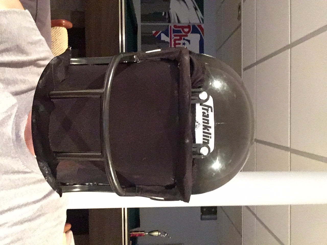

I started with a toy football helmet as the base. You could use a real helmet as well, but I found a few toy ones at a thrift store for a few bucks. This ensured the head piece would sit tight on my head and would keep the mouth opening right in front of my eyes. I put a black piece of spandex over the opening so I could see out but people couldn't see in. Since Sully's head is much bigger than mine, I used rigid foam insulation to build the helmet out into a larger shape. I used chicken wire to build out the general shape of the head (credit to user wmorey37, which I used as a reference for the chicken wire method). I then used wire cutters to cut out a section of the mouth, which I would see out of. The teeth were cut from a piece of styrene plastic and taped to the chicken wire frame. I used 1" diameter PVC tube for the lips and bent them into the right shape after heating them with a heat gun. I added foam around the lips to allow for a gradual transition to the head.
I put a layer of masking tape over the chicken wire to give the paper machè something to adhere to. I filled the space between the helmet and wire frame with Great Stuff expanding foam. This helped give the external frame more rigidity. When it was fully covered in masking tape, I covered the mouth and prepared the head for paper machè. I used newspaper strips as a medium and the paste consisted of 3 parts water, 3 parts flour, and 1 part Titebond wood glue. I alternated direction of the newspaper strips on each layer to give it more structure. It felt rigid enough after 3 layers of paper machè. Once dry, I removed the protective mouth tape, and cut holes for ladle handles which I used for the eyes (more in the next step).
