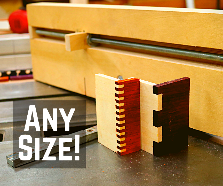

Splines are an incredible way to strengthen already created joints. As well as added strength, splines can give a project an added accent that can fully transform the look and add depth. I have always admired the look of a good solid corner paired with a spline, but really didn't know how best to go about making one. I had seen some rather large jigs, complicated table saw sleds and sacrificial creations, but none of them really gave me the simplicity and versatility I was looking for in a jig.
I'll admit, my jig became something larger than I had intended it to become. I had really liked the idea of just using a small rectangle section of pegboard with a few bolts and knobs to hold my project where it needed to be, but safety precautions and the greater ability to hold and clamp the piece I was working on became much more important.
I also used my new found jig to create a beautiful look in a box that I made for my daughter, adding more value to this extremely simple design that requires very few materials to make.

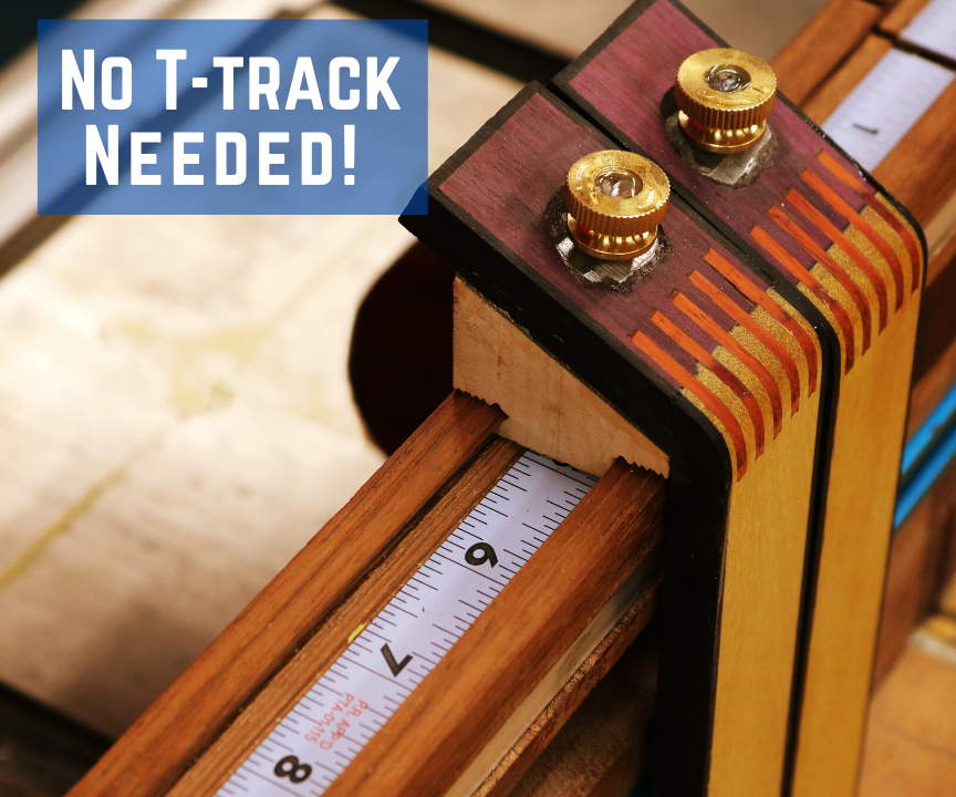

Now that we have all the components ready, all that's left is to assemble and explain how this can be used. If you notice at the beginning of this instructable, I mentioned 4 bolts, longer than 2" (50mm). Longer bolts may be used, as I demonstrate in the video, allowing you to make decorations in table legs or large boxes. Using smaller bolts will allow you to do small projects on maybe a lid or a small picture frame, whereas 6" to 10" (150mm x 254mm" bolts will allow you the ability to do boxes.
To put this jig together, thread the bolts through the backside of the plywood, allowing the rounded carriage heads to sit nestled in the recessed holes we made. The bolts then will thread through the pegboard and from there a fender washer will be added and finally a 1/4" (6mm) knob. If you already have tapped four 1/4" (6mm) knobs (that's a knob with a threaded hole through the middle of it), you're good to go. Attach your wood piece in the middle and tighten it up, you're good to go.
