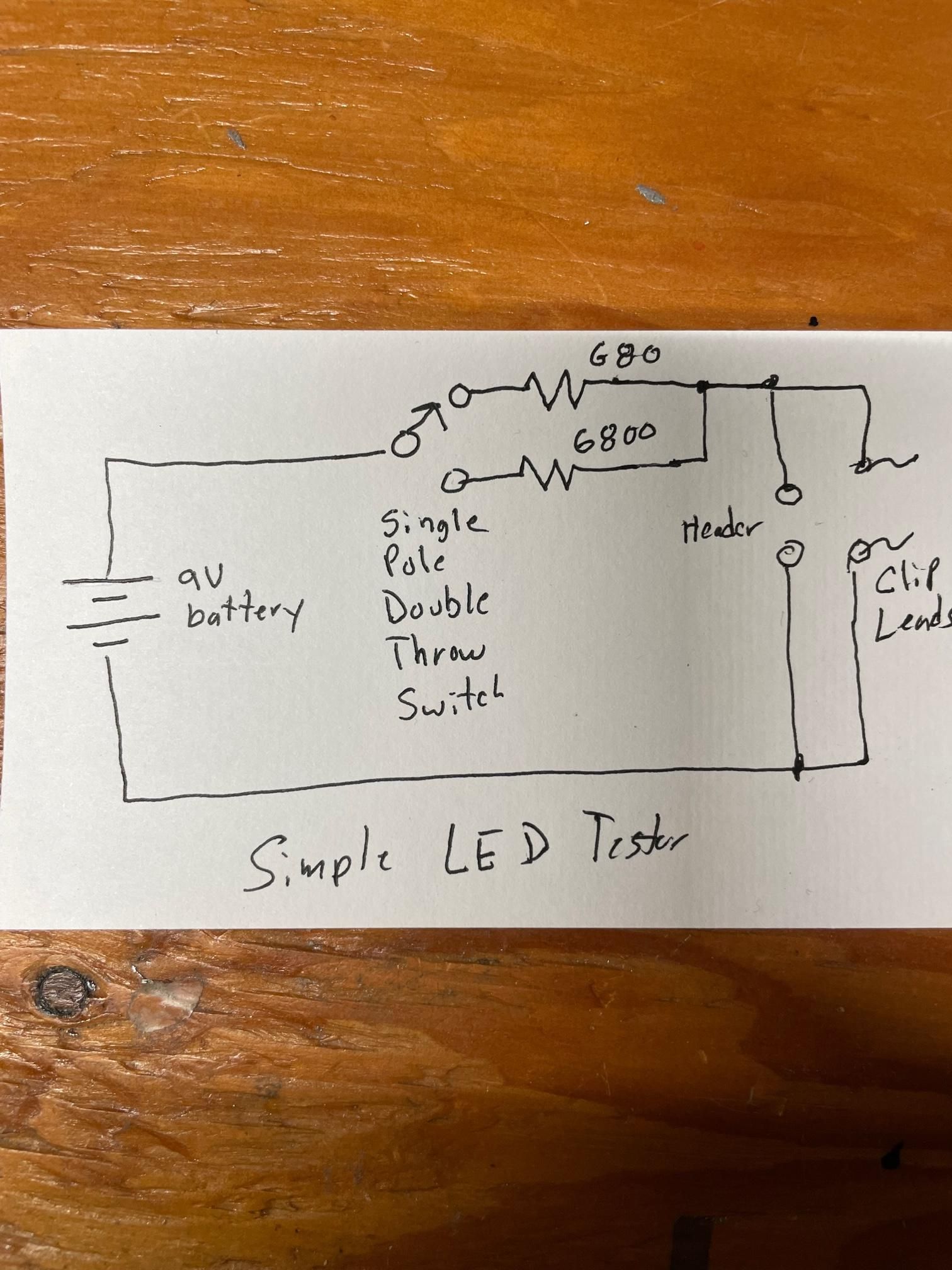

The schematic diagram and a breadboarded version I built are shown in the photos. In the schematic, the only parts that are actually parts of the oscillator are the 74HC14 chip, R1, and C1. R2 and the LED are just so we can see it working.
Build the circuit as in the schematic. I've shown it here on a solderless breadboard, which I recommend for experimenting. The capacitor connects from pin 1 to ground. R1 connects from pin 2 to pin 1. The positive power (Vcc) connects to pin 14 and ground is connected to pin 7. That's all there is to the oscillator! Of course we want to see it work, so connect R2 to pin 2 and to the anode of the LED. The cathode of the LED gets connected to ground. Remember to connect all the unused inputs, pins 3, 5, 9, 11, and 13, to ground. CMOS chips don't like having floating inputs. In a real circuit those other five inverters can be used for whatever purpose you want. CMOS chips are also sensitive to static discharge, so handle them carefully.
Now that it is built, the LED should be flashing. If you used the 100K resistor and 1 uF capacitor for R1 and C1, it should be flashing about ten times per second: pretty quick but slow enough to see the flashes.
If it doesn't seem to be working, make sure you have everything wired correctly. The LED polarity would probably be the first I would check. Also make sure you used the values I recommended. Other values could make the frequency too high to see the flashes or a too-large value for R2 could make the LED too dim to see. Another color of LED could require more voltage than you have available. It's a simple circuit and shouldn't be too hard to get working.
