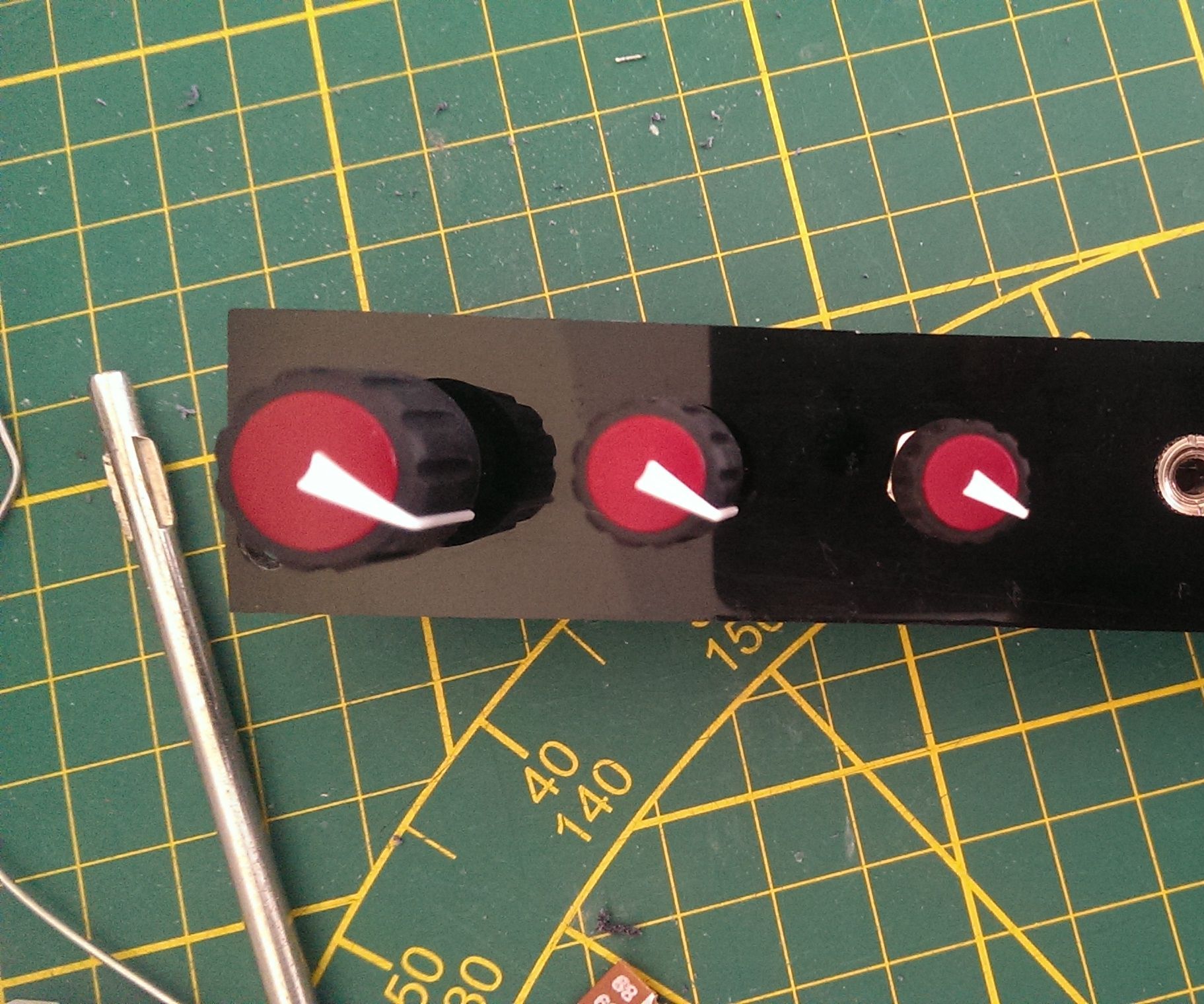

Step 1: Prepare Your Panel
Depending on your socket size, you can decide on the amount of HP for the multiple. I have used 3HP width, which is 0,6 inch or 15,24 mm (1HP is equal to 0,2 inch). More info on this here: http://www.doepfer.de/a100_man/a100m_e.htm
- Place the sockets on the desired spot and draw where you want to make the holes for the sockets. (The thonkiconn sockets have the inputs to one side when placed horizontally, so remember this when locating the spots for the sockets).
Also remember that you need to stay away from the top and bottom of the panel for about 1 cm as this is where the mounting rails will be!
- Drill the holes for the sockets (with the 6M drill).
- Drill the holes for the screws (with the 3M drill) with its centre about 7,5mm from the left side and 3mm from the top or bottom of the panel.
- Mount the sockets onto the panel, facing the same direction.
