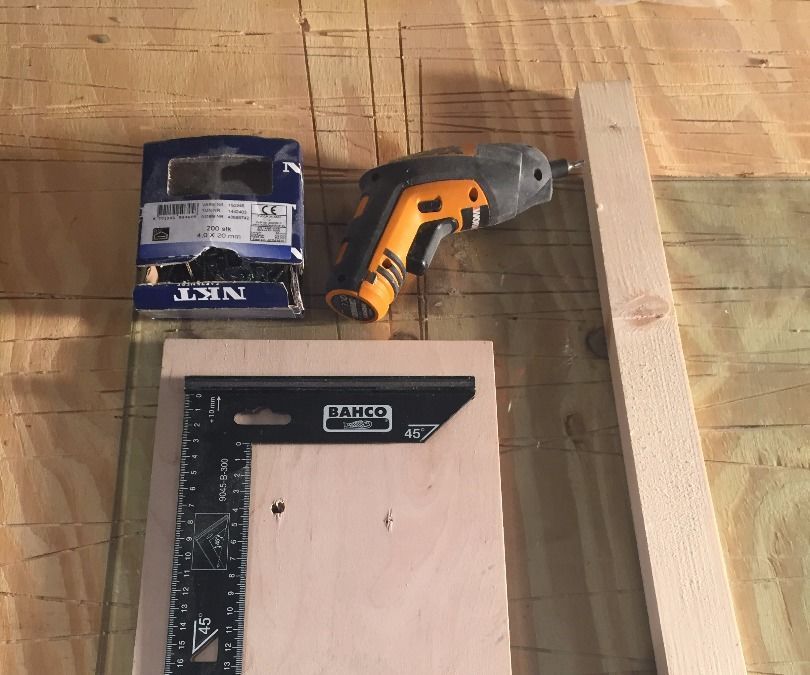

Step 2: Assembling the Carcass
Second step is to build the carcass from the various pieces. I have some 90 degree angle pieces of MDF that I cut the corner off and drilled holes in, which allows me to use them as an angel guide when assembling projects.
For fastening I pre-drilled holes and drove in drywall screws as they have quite a lot of grip and are cheap. The construction came out quite sturdy.

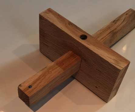

To support the folding table at 90 degrees I cut a support brace in 45degrees on each end. Then I made two blocks with 45 degree ends and mounted them so the brace is in the right position for the table to be flat with the surface of the tablesaw.
The folding table is mounted with an ordinary folding hinge across the full lenght, to make sure heavy materials will not break it.
I also angled the sides on the support brace, allowing it to be stored as in a "french cleat" system under the folding table, making it easy to transport and setup. This is a bit hard to see on the pictures.. however it's easy to do.
