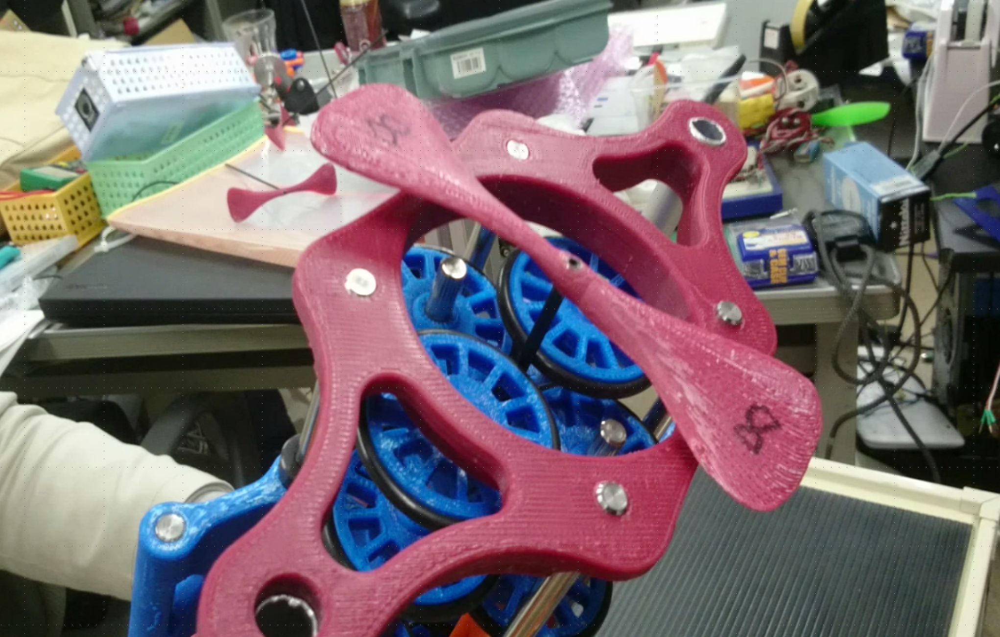

Step 1: How to Make Traditional Taketombo: Cut the Bamboo
Cut the bamboo into a wing shape
Step 2: How to Make Traditional Taketombo: Balance the Wings
Shave and balance the heavier wing
Step 3: How to Make Traditional Taketombo: Adjust the Angle of Attack
Heat the wings with a heat gun to adjust the attack angle
Step 4: How to Make Traditional Taketombo: Completed
The figure is a completed traditional Taketombo.
However, the same shape can not be made again.
Step 5:
Adjust the angle of attack
