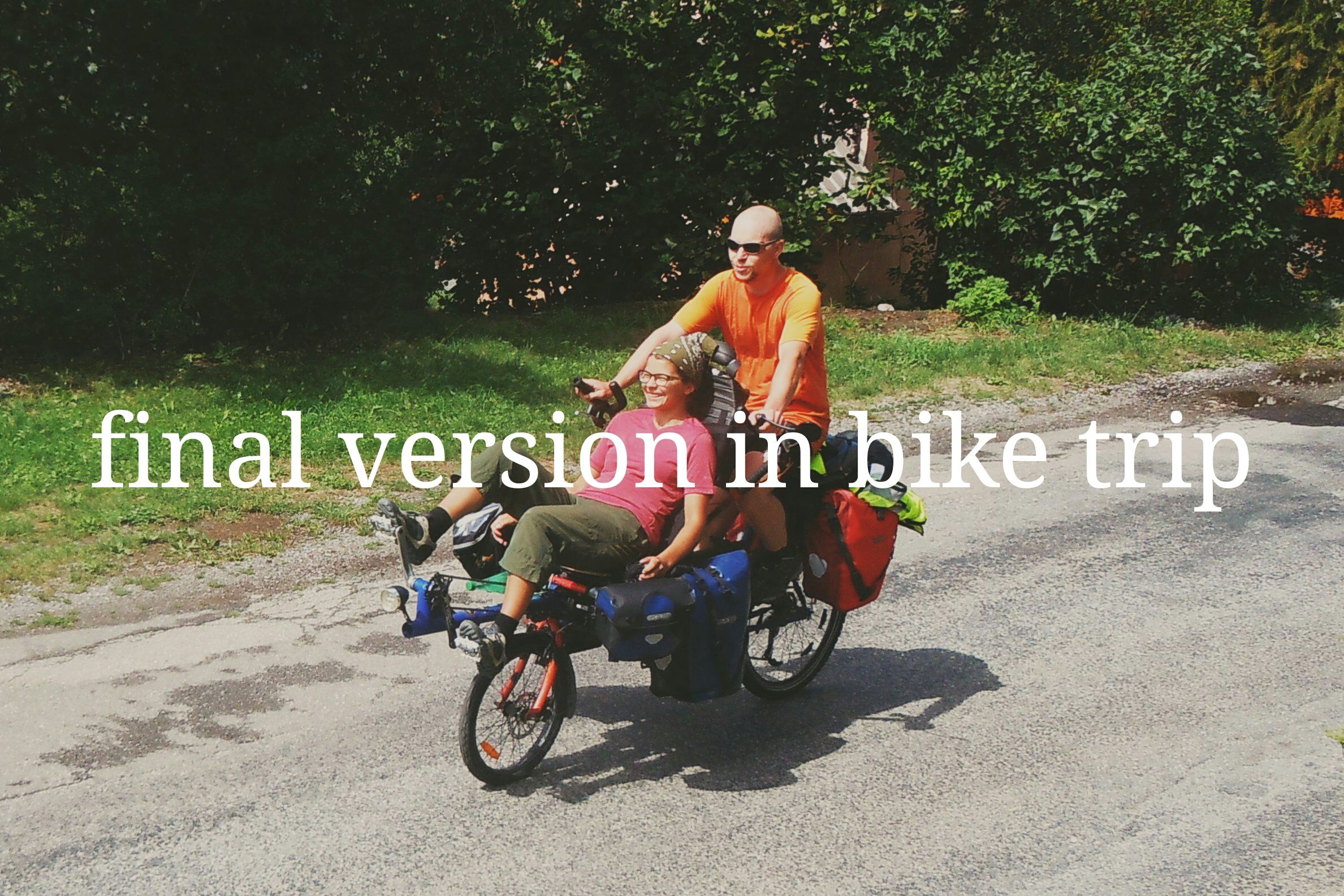

Héhé! Ready for the first test ? It was really nice ! You have enough space at the back and front place, the steering is really better than the previous one and we can go fast.
Successful!
Now, the least interesting part .... dismount it, everything !, unpainted... and repaint it nicely!
Step 4: Final Version, Ready for the Road !
Tested and approved !
Let's go !
