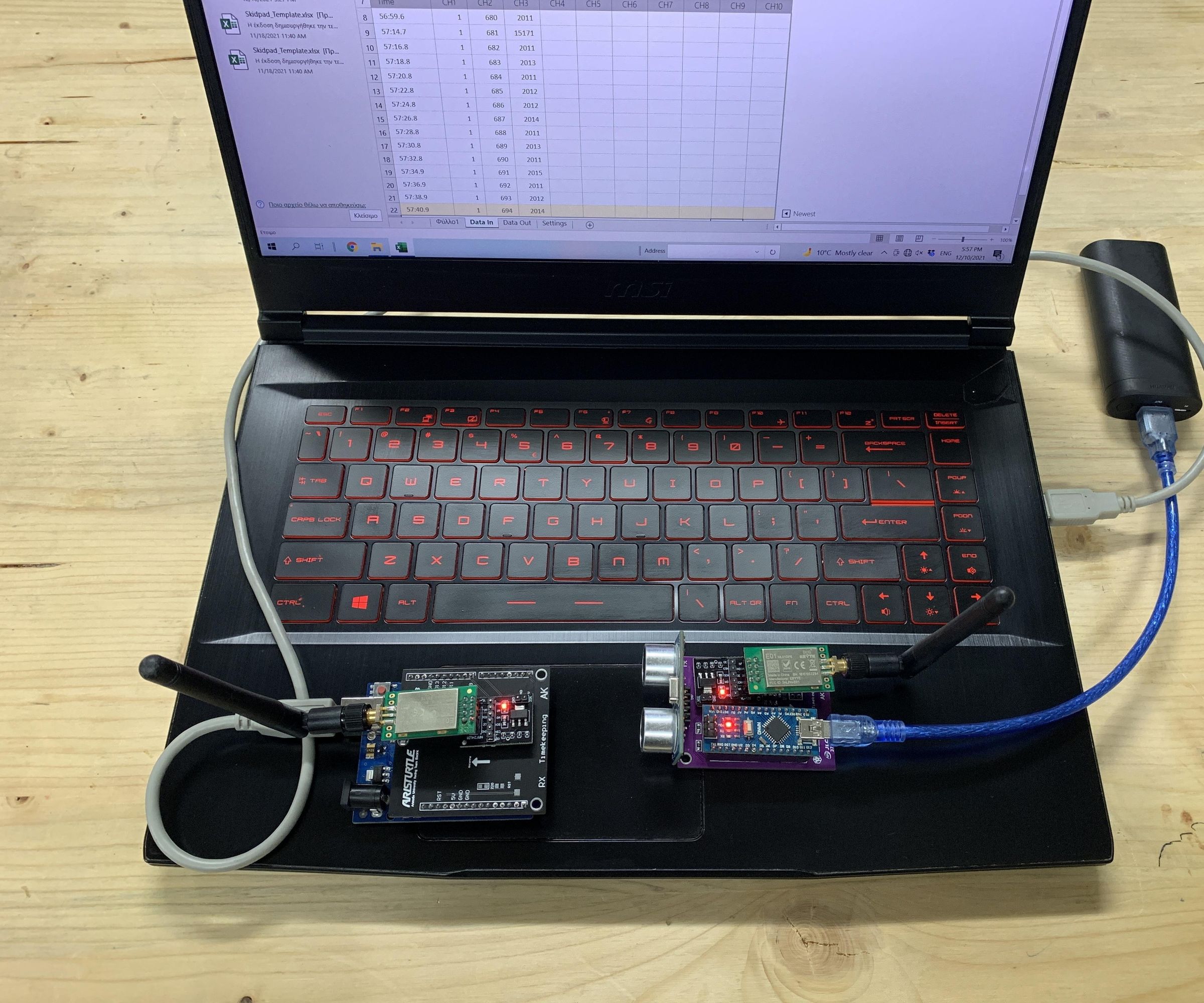

The system consists of one transmitter and one receiver. The transmitter is mounted on the car and is connected to the car’s CAN channels. It is responsible for collecting all the data from the car and for transmitting them wirelessly to the receiver which is connected to the user’s laptop. Then, the data are being transferred through serial communication to a self-developed Telemetry interface that visualizes them in a proper manner.

·      1 × STM32F446RE
·      1 × 2.5dBi Panel mount passive antenna
·      1 × LoRa 868MHz chip
·      Power Supply: 24V through battery cells or Power Supply Unit
The receiver subsystem consists of:
·      1 × STM32F446RE Nucleo board
·      Power Supply: From PC through USB

We have tested the system on track and validated that the transmitted payload is large enough (250 bytes) to cover all the variables that we need to monitor as well as that the maximum distance reaches approximately 500m in line of sight (LoS) making the choice of the communication protocol a suitable choice for robust long range data transmission.
