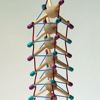

Tensegrity is a different way of looking at structure.
Tensegrity may be the basic structural system for our evolved anatomy, from cells through to vertebra, the principles of tensegrity seem to be involved, especially in systems where motion is concerned. Tensegrity has become the study of Surgeons, biomechanisist's and NASA roboticist's, looking to understand both how we work, and how machines can get some of our resilience, efficiency, and light weight rugged structure.
One of Tom Flemon's early spine models
I'm fortunate to have lived on Salt Spring Island with one of the worlds great resources about Tensegrity, Researcher and inventor Tom Flemons.
Tom passed almost exactly a year ago, and his website is still maintained in his honor. It is a great resource for Tensegrity in general, and especially for Tensegrity and Anatomy.
Tom helped me to see that there was room for more people to work on how to apply tensegrity to our lives, and by using its principles of reducing structure to its minimal components, we could have systems that are lighter, more resilient, and flexible.

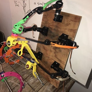

Last January while I was working on upgrading my Autodesk 360 Fusion drafting skills, and looking for projects to build with my 3D printer, I started thinking about it again, more seriously. I had been reading up on cable driven robotic actuation and programming them still seemed like something more complex than I could handle. And THEN this summer, after looking at many delta robots and 5R parallel motion systems, I realized they could be combined, and it would be another, non-tensegral, way of realizing the 5+ axis movement I'd envisioned in my tensegrity robot. It would also be doable with RC servo's as none of the servo's work in opposition to another, so position inaccuracy wouldn't shut it down.
In this instructable I will talk about both systems. The tensegral, and the twin 5R parallel. At the end, by the time the contest is done, I'll have all the printable files for the twin 5R ART limb, included here.
I will also include the 3D printable parts for the Tensegral version of my ART limb robotic simulator. I'd love to hear from people who think they can work out the winchs and controls to make a powered unit. At this stage, they may be beyond me, but the cable driven, Tensegrity based systems are likely to be lighter, faster and have lower part counts, as well as being more resilient during overloads and crashes. I think they will require much more dynamic control strategies, with the system likely functioning best with both position and load feedback.
The alternative, the ART limb as a layered or twin 5R parallel, that I describe at the end here does not require any actuator to work against another so will be more tolerant of position error, and it reduces the minimal number of actuators from 6-8 to 5. Eventually I'll build multiple versions of both, and use them to build my own walking Mecha, but that's for later.... For now.....

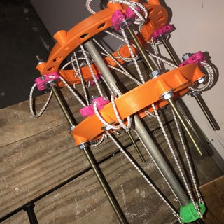

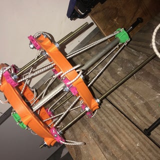

What's the ideal geometry? Why the Overlapping Triangles?How Many Cables?
With this overlapping tensegrity geometry a wider range of motion can be created. In this orange coloured example I've used reflected pyramids (4 control lines per end) as the structure, instead of the reflected tetrahedrons I used in the pink coloured example, 8 cables instead of 6. The increase to four mooring points for each end(at the 12,3,6,9 positions) give a larger area of motion. In the 3 mooring point pink geometry, there are more singularities possible where the boom can "pop" out of the controlled area. Increasing the number of mooring points could also build redundancy.

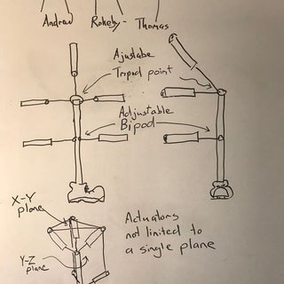

Step 3: Delta Plus Bipod = 5 Axis Leg

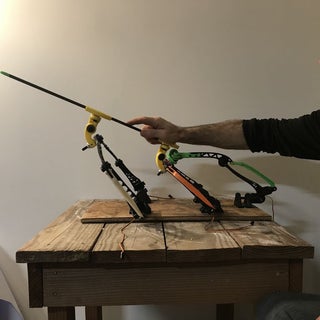

A Pair of 5R Parallel Robots + One more = 5 axis movement
What I've come to see is that for controlling a 5 axis "leg", a simple mechanism is to use a pair of independent 5R linkages, as well as a 5th single link to controllably tilt the pair of 5R links.
