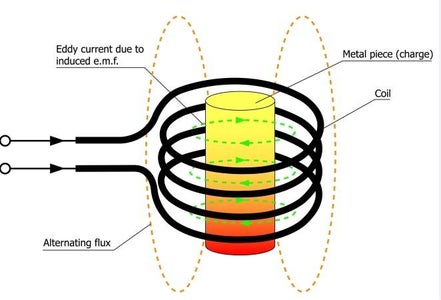

 An induction heater is a device that uses electromagnetic induction to heat objects. It consists of a coil of wire through which a high-frequency alternating current (AC) is passed, and this coil generates a magnetic field around it. When a conductive material is placed within this magnetic field, it induces electric currents, known as "eddy currents," within the material. These eddy currents generate heat due to electrical resistance in the material, causing it to become hot.

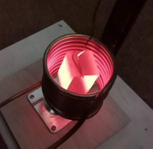

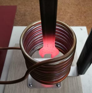

  And now let's see how the device works in real conditions. During the test I will use first small and then larger objects and at the same time I will read the total consumption with Wattmeter, because at the moment I do not have an Ammeter for large currents (so-called current clamp).

  The device is solidly made, and for a power of up to 1.2 kilowatts, cooling fans are not needed at all. I actually didn't use the fans during testing. This device is sold online for a price of about $100 which is actually some real amount. A much bigger problem is the power supply for it, so if we don't have an alternative like in my case, the cost of the power supply would several times exceed the price of the device itself. This induction heater can be used with graphite crucible for smelting gold, silver, copper, aluminum and other metals. It can also be used to generate High Voltage using a flyback transformer, wireless power transfer, tesla transformer, and other experiments that I will describe in some of my next videos.
